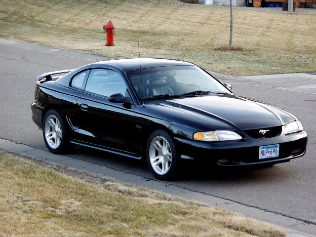

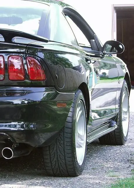

Here's my car when I bought it:

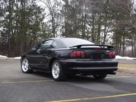

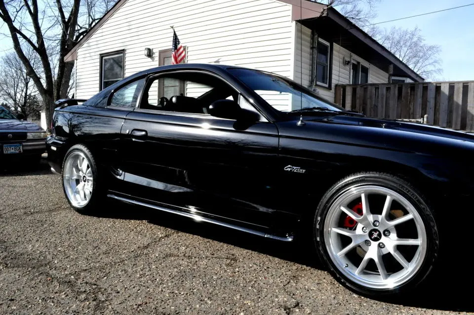

This is after I installed all of the suspension stuff (same set-up I am suggesting above):

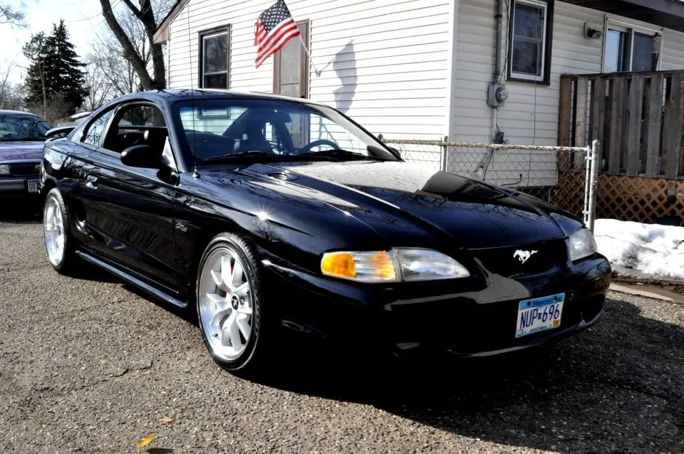

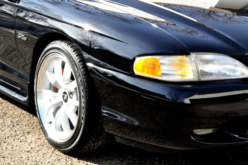

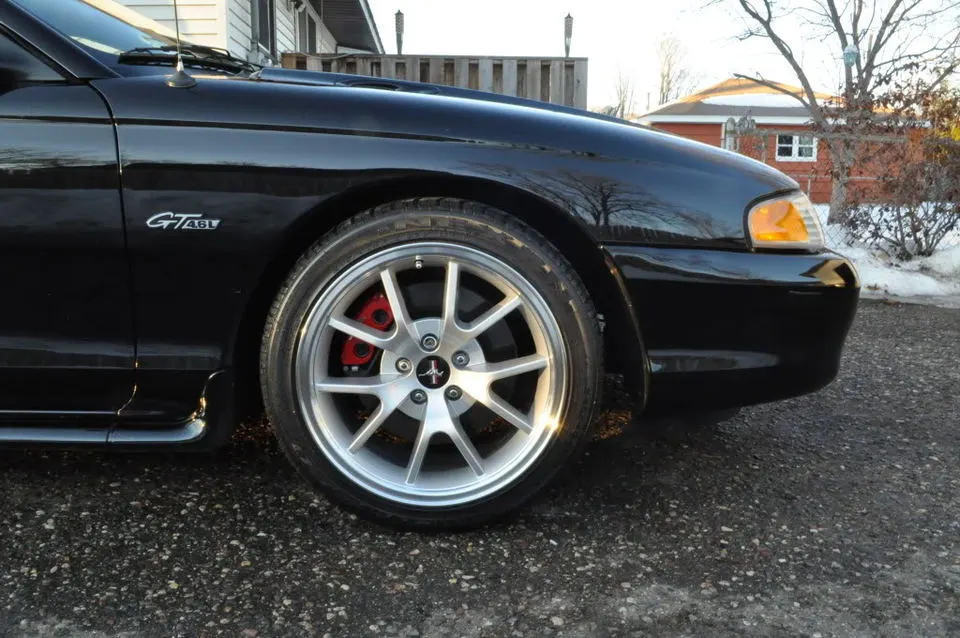

And this is after I installed my FR500 wheels:

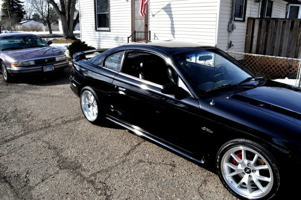

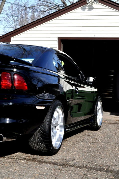

Stock wheels:
