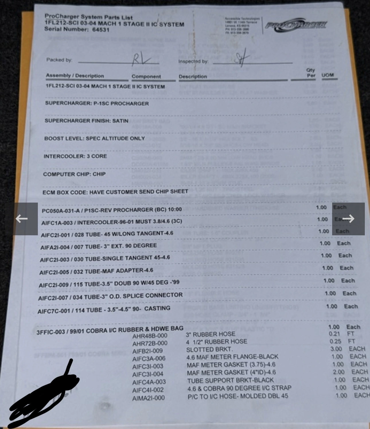

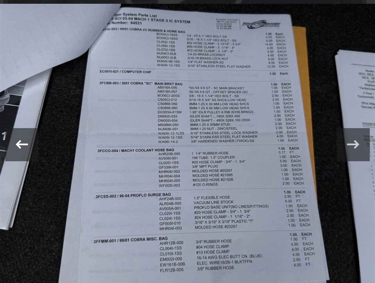

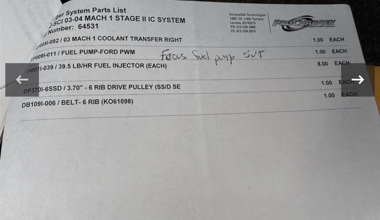

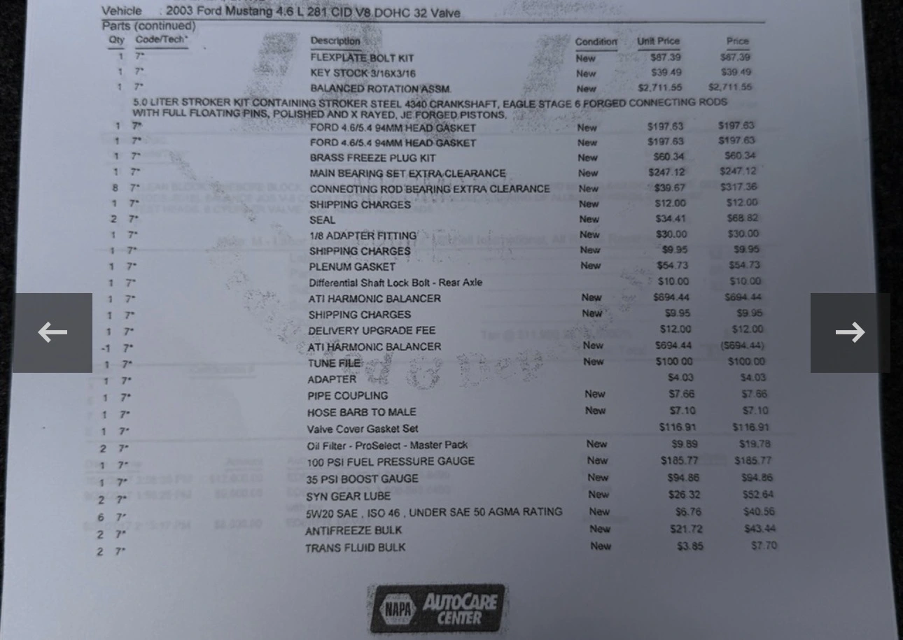

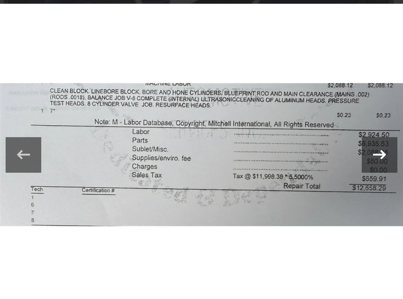

Help people if stangnet. I just purchased a 2003 Mach 1. It was a dream car in high school and always loved the look since day 1. It is an automatic but due to severe back pain I cannot drive a manual. I have attached some paperwork the dealership had. Unfortunately previous owner passed away so no way of contacting.
This was strictly a vanity purchase because I had been searching for a while.
This is what I know:
a. Eagle Stage 6 forged rods
b. iProCharger supercharger and Stage II intercooler upgrade
c. magnaflow exhaust

My guess through an auto with that tiny fuel pump is somewhere around 400. The auto will hurt you due to the parasitic losses associated with it. You could be making WAY more with forged internals but would need a twin pump fuel hat and better pumps such as two GT supercar pumps and then a retune.
I make 450 rwhp with stock internals and a P1SC that maxed out a DW300 pump on my 01 Cobra. I am limited by the stock internals.
FYI you are going to reach your limit with belt slip on the six rib setup. Cams are expensive but if you absolutely want them look to Todd Warren Cams / Apocalypse Performane as he is big into the 4V and can custom spec a set for you.
FYI shorty headers are useless for HP gains on the 4V and a set of long tubes does make a difference (I also am running long tubes).
I will look more at your list but a bigger surge (BOV) valve helps if you are going for higher boost. The black “race” valve either open or recirculated j to at least a piece of hose. I have the open black valve and you can hear a LOT of whoosh from that valve in normal driving and the transition from heavy throttle to zero throttle is damn loud. You either like that or don’t.
