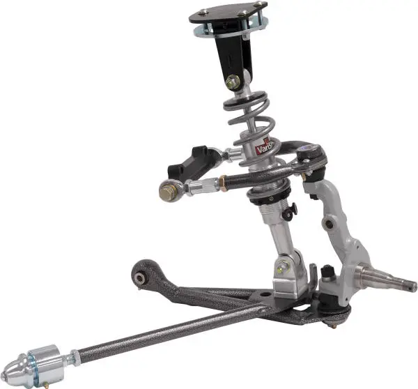

That's where I get a little uncertain, that would be a very nice suspension and brake system, but for not much more I can get a setup that's new in the box, ready to be installed with every little thing I need, and it's a modern, 21st century system. As you said, may not make that much of a difference for a typical driver, but considering the significant difference in technology vs the lesser difference in cost, I'm still somewhat on the fence.
Is there anyone who has driven a couple different cars with different suspensions who can say what the practical difference in the cars is? Does anyone know where I can find some reviews of systems like the Fat Man suspension, Global West, or RRS system? Just wanna know what's worth it before I decide.

Summit has the manual Unisteer for less money. I would never use air shocks, the top mounting point is not designed for them and air shocks themselves just aren't that great.
The RSS system will cost you over 3k with really basic brakes, and after asking over at Protouring.com I found that struts are not really all that.
I came to the conclusion that if I were going to spend real money I would not do the MII system and would go with the set-up that mounts the coil over to the lower control arm, much of the competition is just a tweak to the existing geometry.
My lottery kit would be the TCP, but dont forget that you would still need a sway bar and brakes! $$ I cant have 5-6k in the front end of a car that will still only be worth around 15k.
