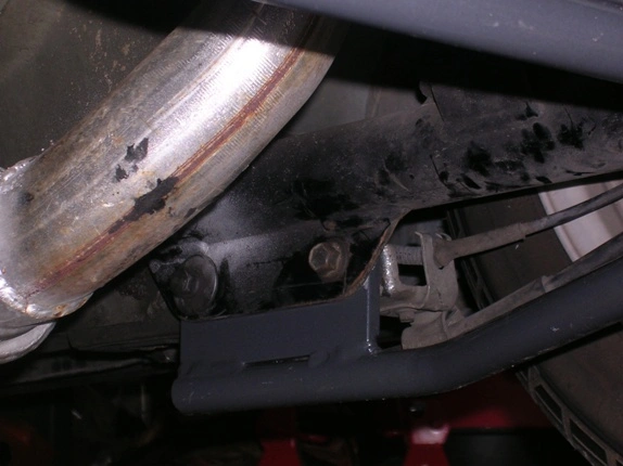

No question here, just a review really. After 135K miles, my stock rear sway bar broke (common problem). Since others will run into this and I didn't find this bar under a search so I fugured I'd add this thread in case someone searched rear sway bars in the future.
I ordered the Suspension Techniques bar from Summitt and I'm very happy with it. Unlike the stock bar, it is solid steel like the cobra versions. It was only $105. Comes powder coated in gray. Bolted right up, no problems. FYI. :nice:

not really, but I've just been on the street, haven't pushed it on a road course. I'm told the solid bars will help reduce understeer and it seems like its done that but it could just be that I was expecting it. I think the main plus is better durability over the stock bar. On the downside, it is solid so it is also HEAVIER! Which I hate to add weight to my car but I also don't want to add another part that will break.
