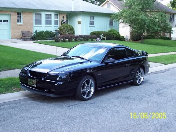

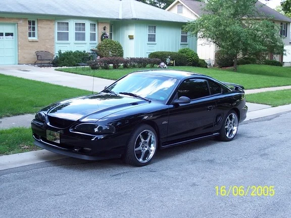

Noticed you had a Mach I chin spoiler on your '98. Do you have a pic of it anywhere, I'd like to see how that looks!
