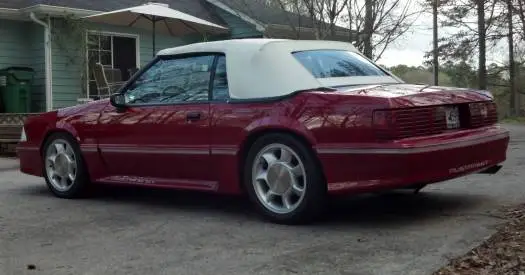

Is it possible? To take the rear bumper or the 93 cobra saleen style and put it on my 88 gt convertible?

Yes, but you will need to modify the exhaust hangers/isolators to position the tailpipes in the correct spot under the cutouts in the cobra bumper. You will also need LX tailpipes or you will need to cut off the turndowns on your GT tails and buy some 3" tips.
Also, if you're going to get a cobra bumper, look for OEM ones first. If you can't find one, your next best alternative is Cervinis. Either option will be expensive.

Here's my '88 with a Cobra rear bumper cover. Looks and fits like it came on there. I even added the MUSTANG GT decals to it.
As mentioned above you will need a LX/Cobra style catback to make it happen.

Wow that looks a whole lot better than the stock gt one
