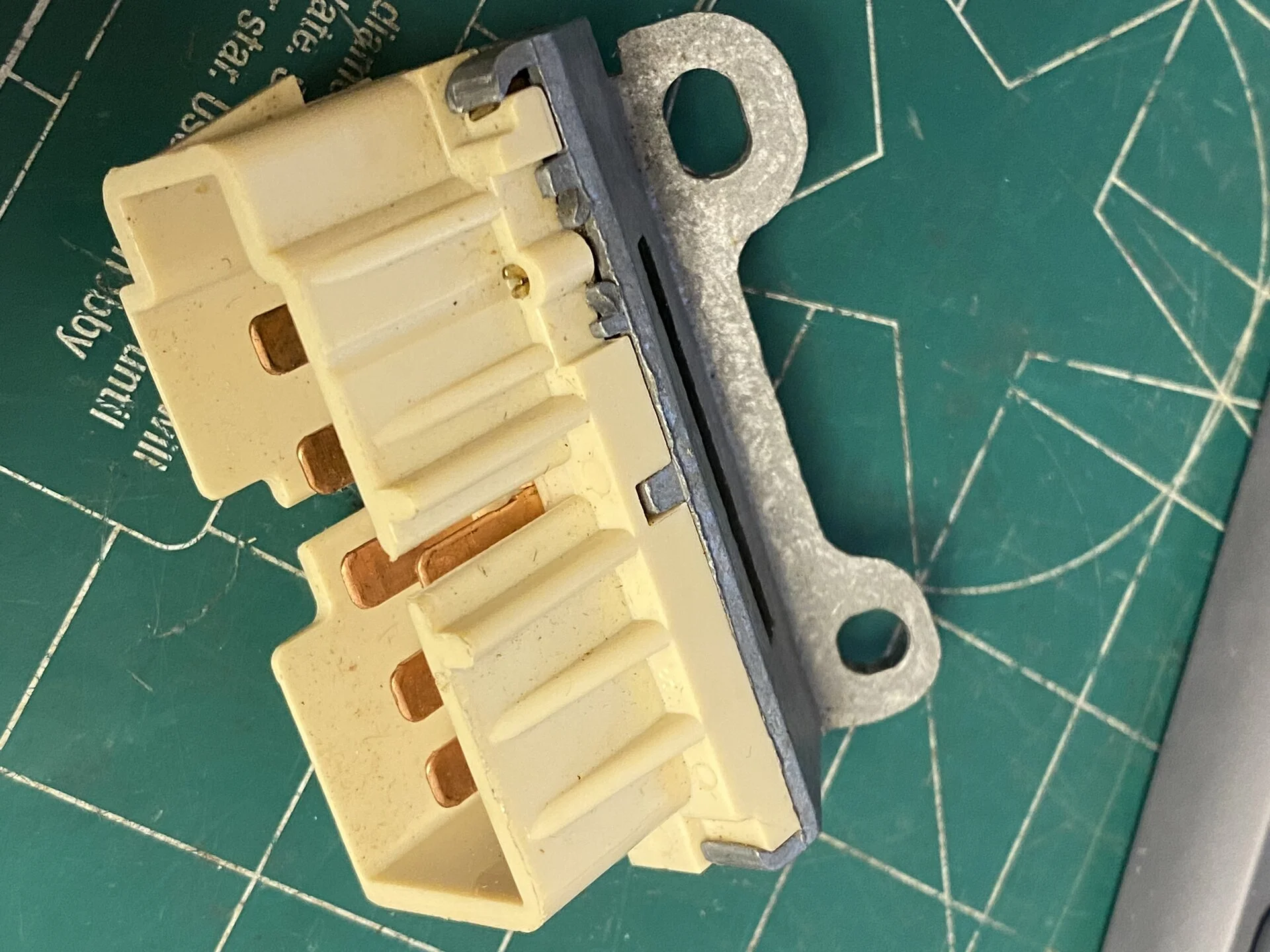

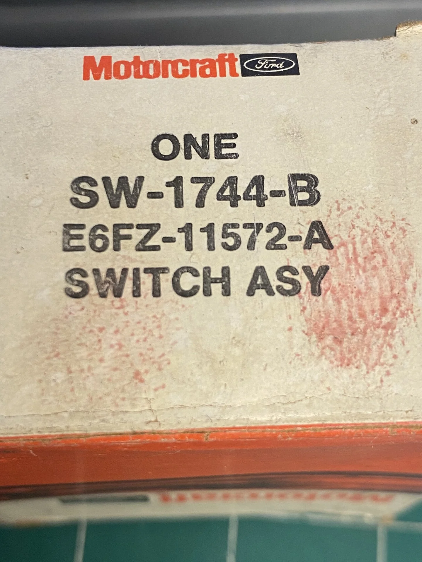

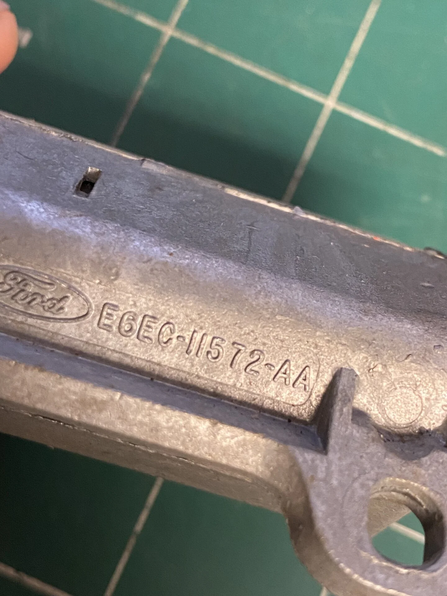

I have this switch NOS and the box looks late 80's vintage or early 90's.
SW-1744-B
E6FZ-11572-A
Is this the one that burns down cars and has been superceeded?
I dont want to install it, i want to sell it. But if this is the "bad" one perhaps its better off in the trash. Looking for a copy of the Ford recall as it usually lists what part numbers in Ford inventory to scrap

I know you found your answer but in case anyone else is curious.
Safety Recall 95S28 - Ignition Switch Replacement
From the document:
Parts Purge
All of the ignition switches listed below are to be withdrawn from your inventory and immediately returned, freight prepaid using the least expensive transportation, to your facing PDC within 30 days:
E4UZ-11572-A (SW 1916)
E4TZ-11572-A (SW 1562A)
E6FZ-11572-A (SW 1744B)
E7TZ-11572-A (SW 2101)
F0LY-11572-A (SW 2219)
F2TZ-11572-A (SW 2300)
Document is here: https://testing-public.carmd.com/Tsb/Download/82887/r95s28r
I think the issue is the fingers holding the metal frame to the plastic portion would fatigue over time and spread allowing the two halves to separate. When this happens, the connections loosen and become higher resistance and heat up.
This one is actually tight, so i'm sure it would work for a while. Obviously I don't want to risk it nor have someone else install it.
I've actually seen folks put zip ties around the newer replacements just in case.
