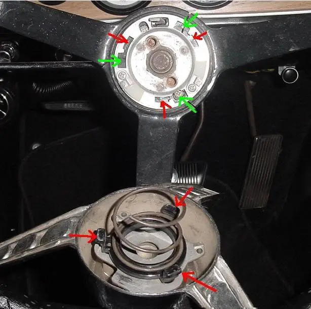

I re-read and see you said "DETAILED", so here is a DETAILED picture and instructions:
The horn is held in place by 3 plastic tabs in grooves on the metal column ring (red arrows). After disconnecting the battery, push the horn ring in and rotate it avout 20 degrees counterclockwise so that the plastic retainer clips are in the larger grooves (green arrows) then release the spring pressure and it lifts right off.
