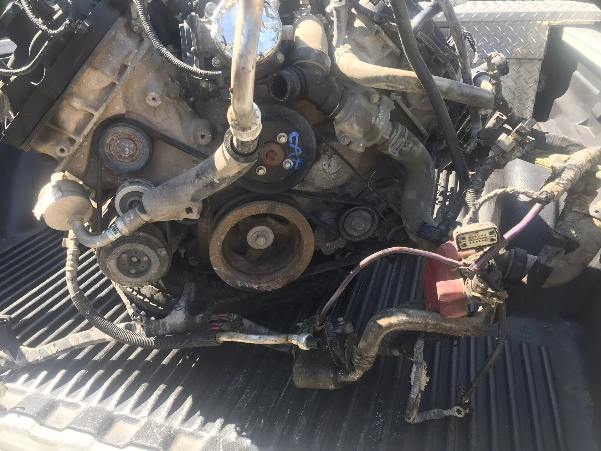

Hey guys, this is the coyote swap engine I have for my foxbody swap. Wanting power brakes, steering and ac on this car. This engine came with ac compressor and all the pulleys. My question is what all as far as the pulleys and all that do I need to purchase to get all this up and running? What all or if can I use off of this engine to get those things up and going?

The upside is there are plenty of solutions, the downside is that none are all that cheap. Just do a few internet searches for coyote swap accessory brackets. Here's the one at lmr for an example.
KRC Mustang Coyote Swap Power Steering Pump Kit 66302125
Simplify your coyote engine swap while retaining your factory accessories!
lmr.com
The brakes require the installation of a hydroboost.

I have a hydroboost from my 96. My question since this engine has the bracket and ac compressor already installed I can use all that right? Also with my brakes can I use my factory rack? Also what would the brakes run off of?

I believe some kits allow factory accessories, some require different ones.
I have seen the swaps done, never done it myself, keep that in mind.
Read the details on the kits, they let you know what works and what doesn't.
I've seen this kit personally (i have not seen the lmr one).
Power By the Hour Coyote Swap Accessory Bracket Kit
Product Overview The best way to make sure your coyote swap will be successful is to buy the right parts. We have been manufacturing coyote swap specific parts since 2013 and our coyote swap accessory drive bracket has been our most popular item. Designed to use factory modular Ford Power...
midwaymustang.com
The rack should work fine, the brakes run off the power steering pump. That LMR kit requires AN fittings, i think the one i just listed doesn't.
You will need the MM hydroboost install kit (i did it way before that existed), but good luck getting it any time soon.
I'm pretty sure for the hydroboost to work right you will also needs to have already done a disc brake swap for the rear.

ive found a kit like the Maxium Motorsport kit on eBay that I’ve purchased and my car is already a 5 lug swap from that 96. So if I purchased the kit you posted a link to that’d be all I need considering I already have the ac compress and pulley?
