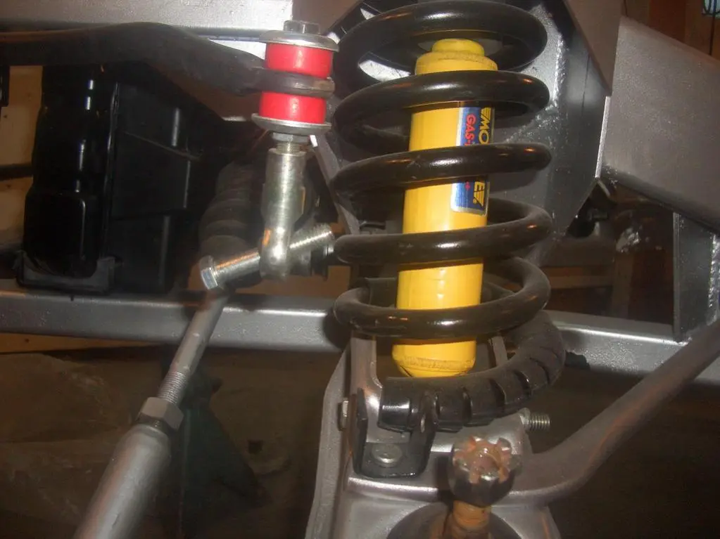

i frequent a web site for original and kit cobras. there are quite a few that use the mII front suspension.
this guy is using a heim joint for his end links on the front sway bar. thought it was a pretty interesting solution. wonder if this could also be used on the rear since it is very hard to find the right endlinks.

That arrangement should work fine on the rear. You just need a plate cut (about 1/8 inch thick should do) to mount to the factory frame location. Drill a hole for the bolt that runs through the heim joint, and a handful of washers to space it out.
