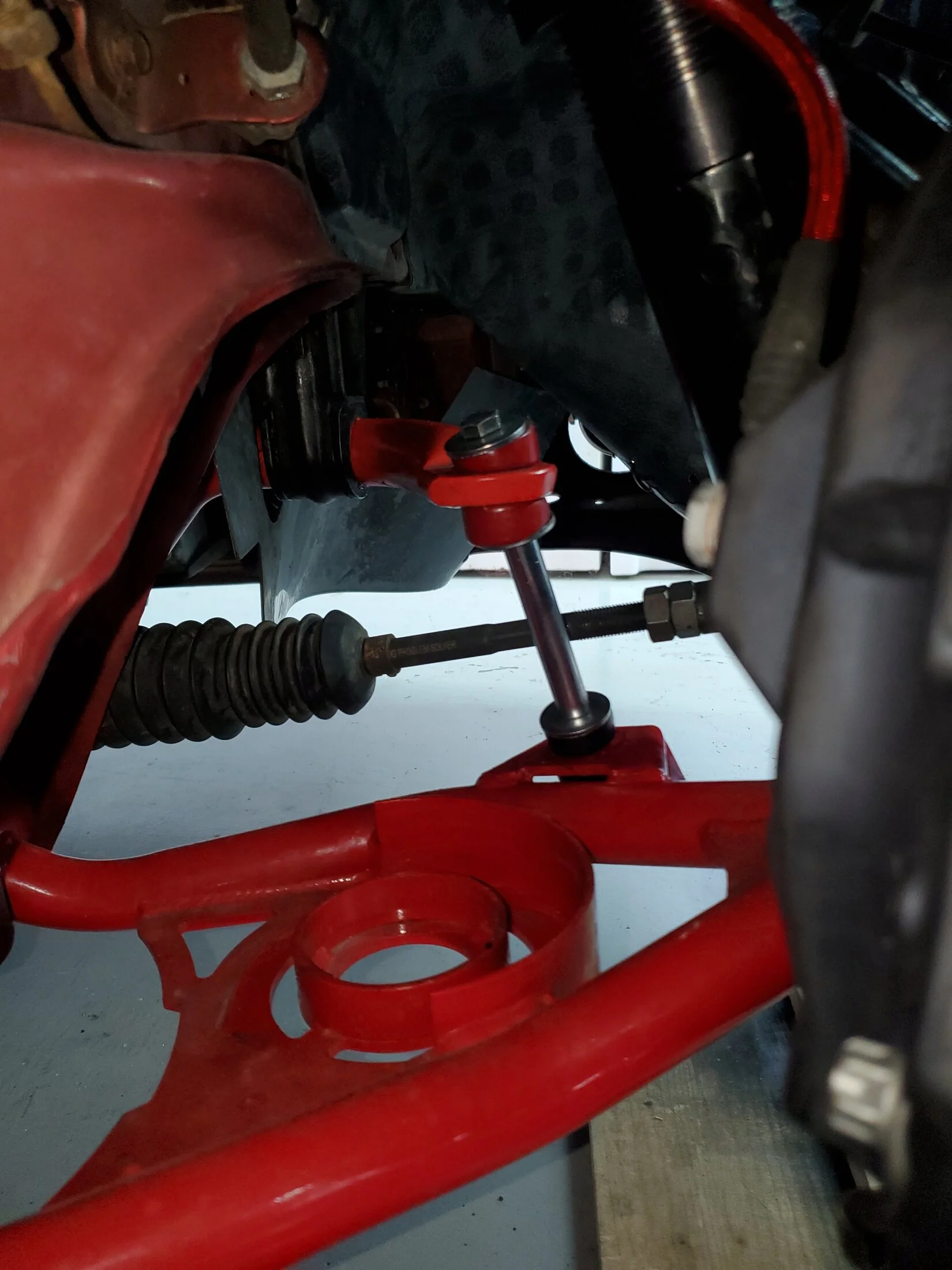

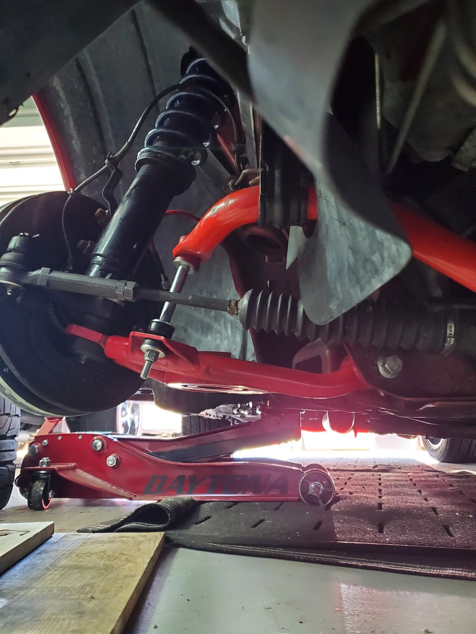

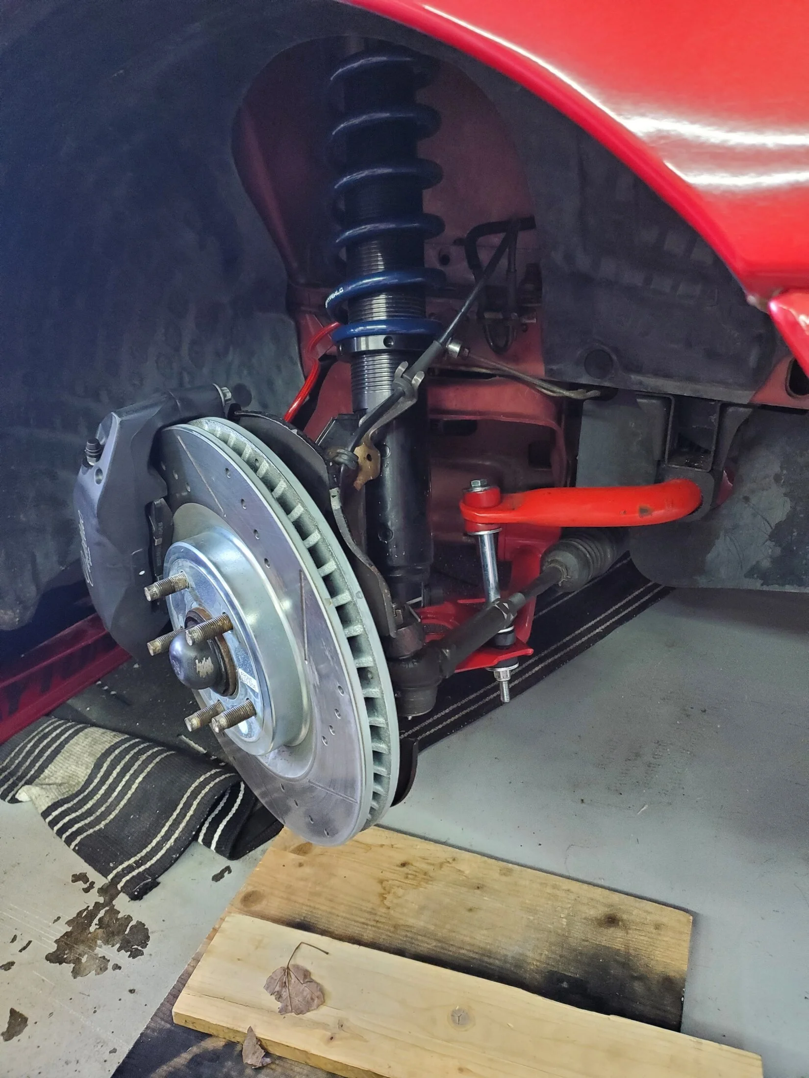

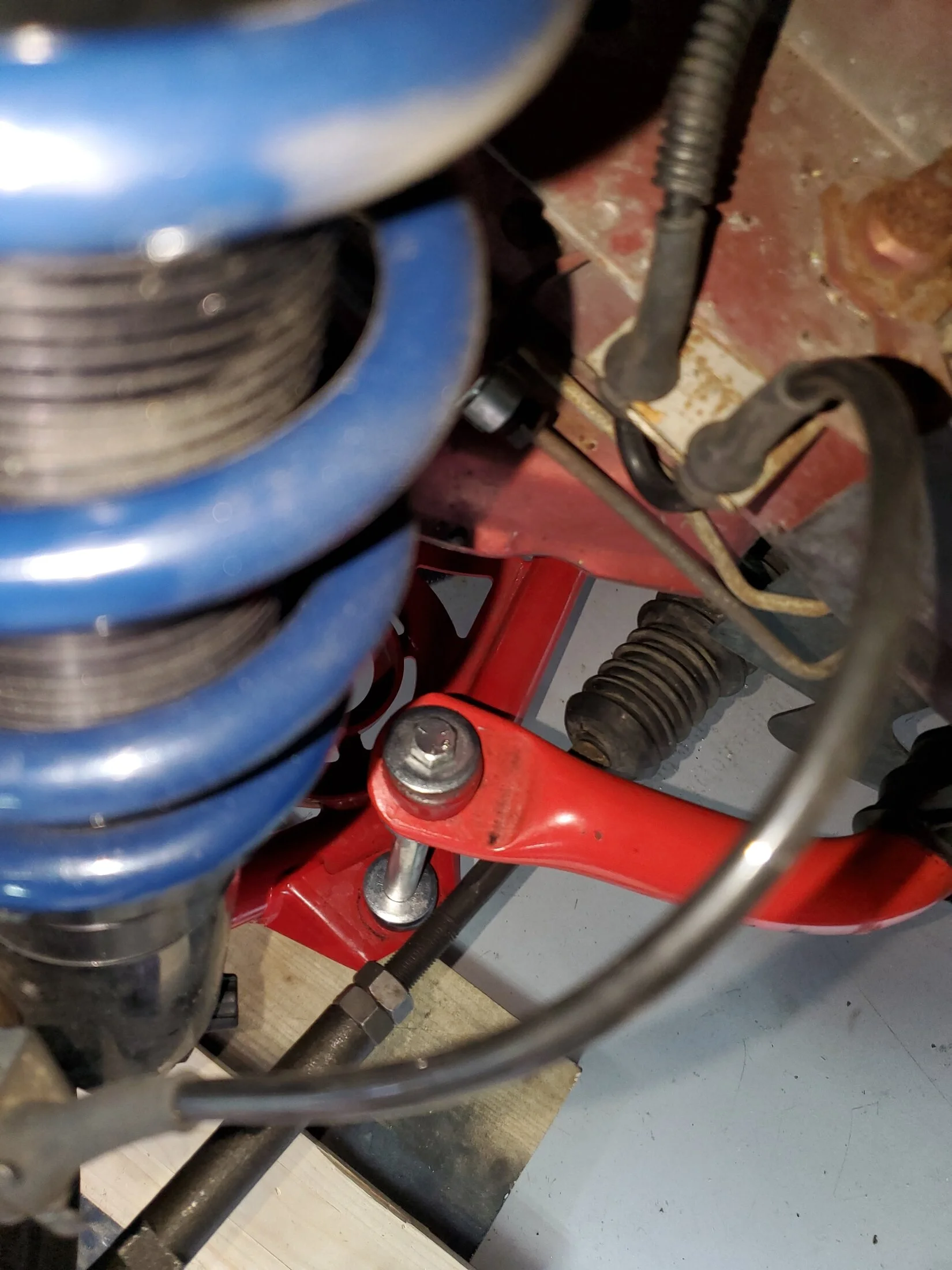

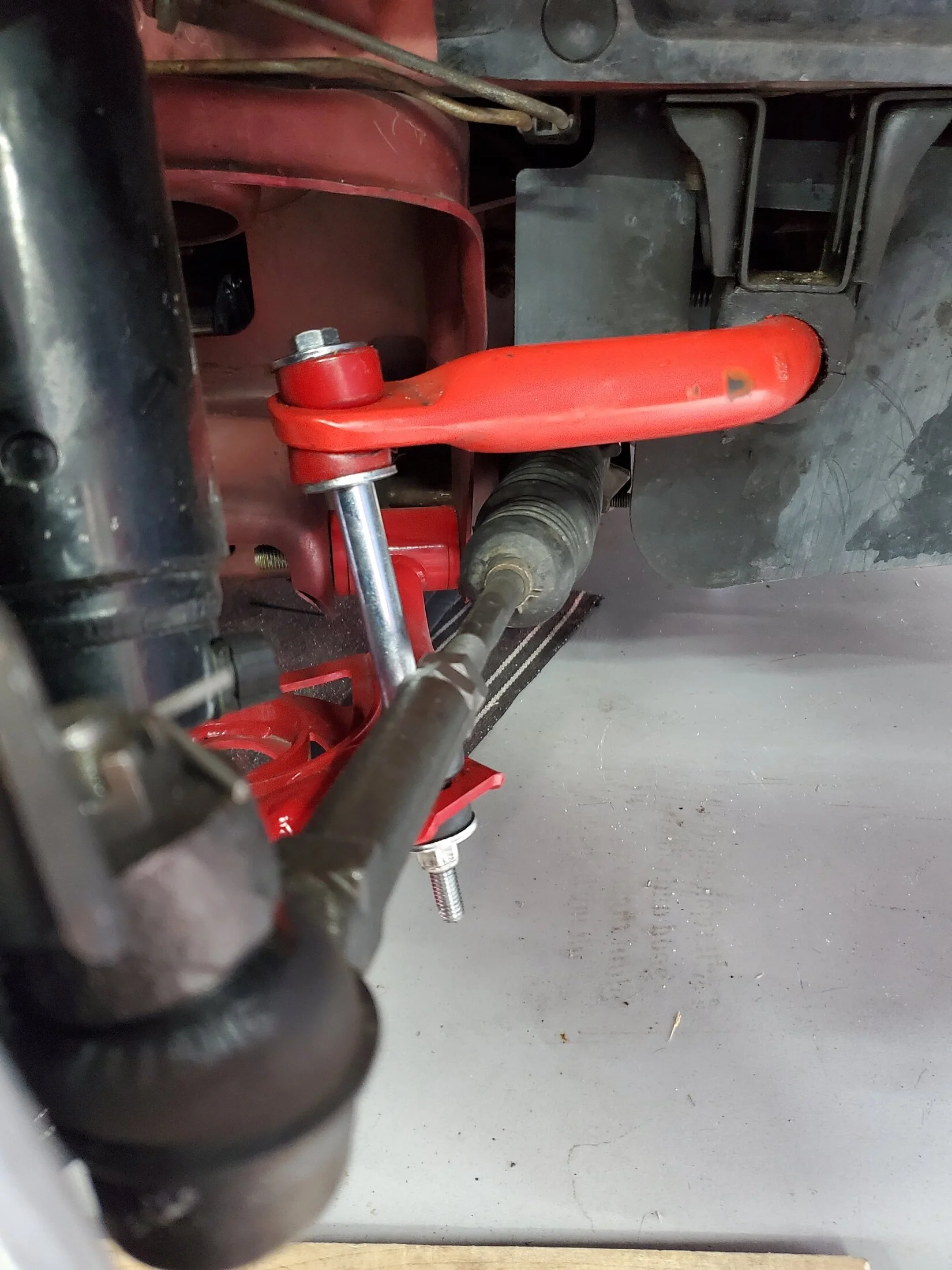

Thanks for your reply. I think I'll try to get a sway bar relocation kit and then measure to see what will work. I've attached some pictures to show what I'm talking about. The end link bushings are sitting very sideways at the moment. Not a big deal to try out a couple different things but just annoying at the moment.
