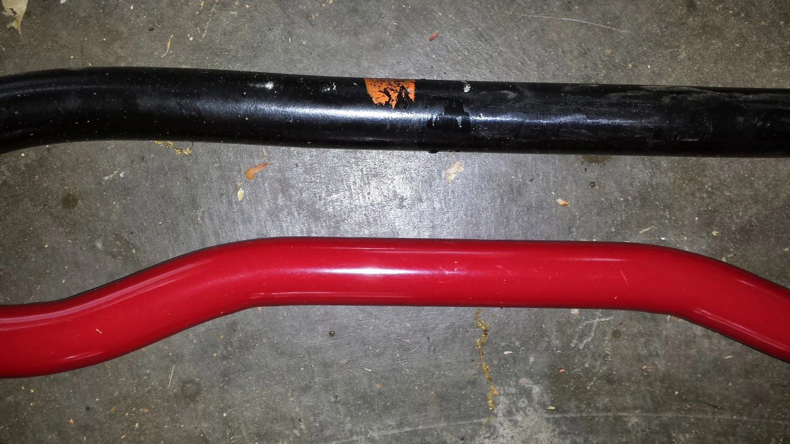

Just an update. I got the bars in today. Took me about 2 hours to install. Not a difficult job at all. The rear Eibach bar is much bigger than the stock rear and almost as big, if not bigger, than the stock front bar. The front Eibach bar is huge compared to the stock front bar. It came with new polyurethane bracket bushings and new end links with poly bushings as well.
If I had a lift and air tools this job would have taken about 45 minutes but working on your back with hand tools takes time. I will post some comparison of the stock bars versus the new bars when they download to my computer.

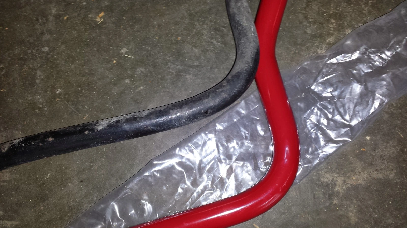

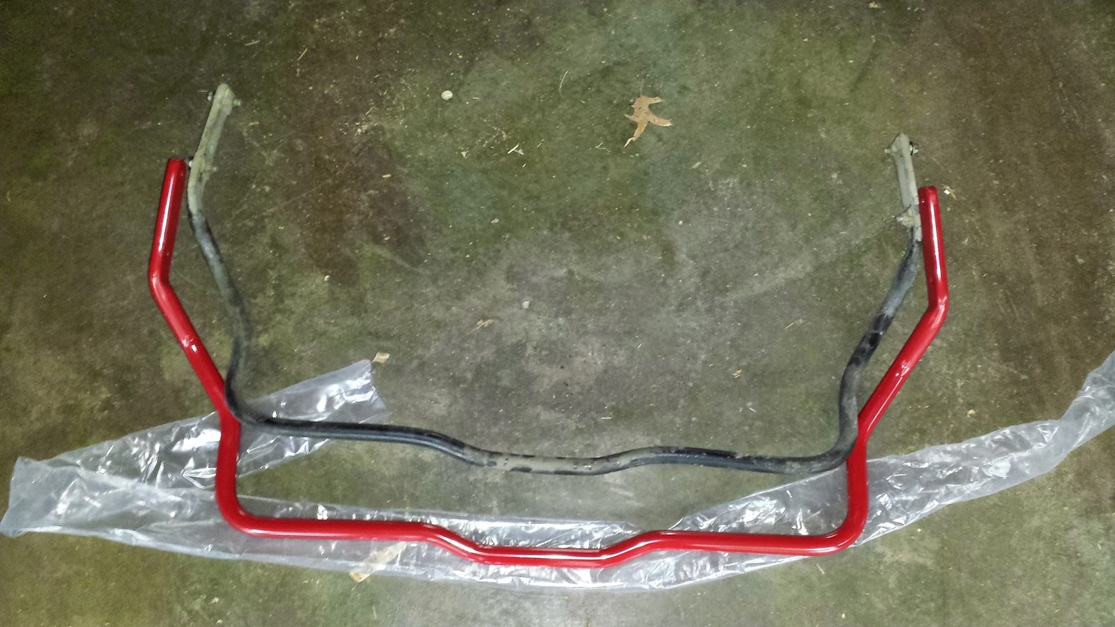

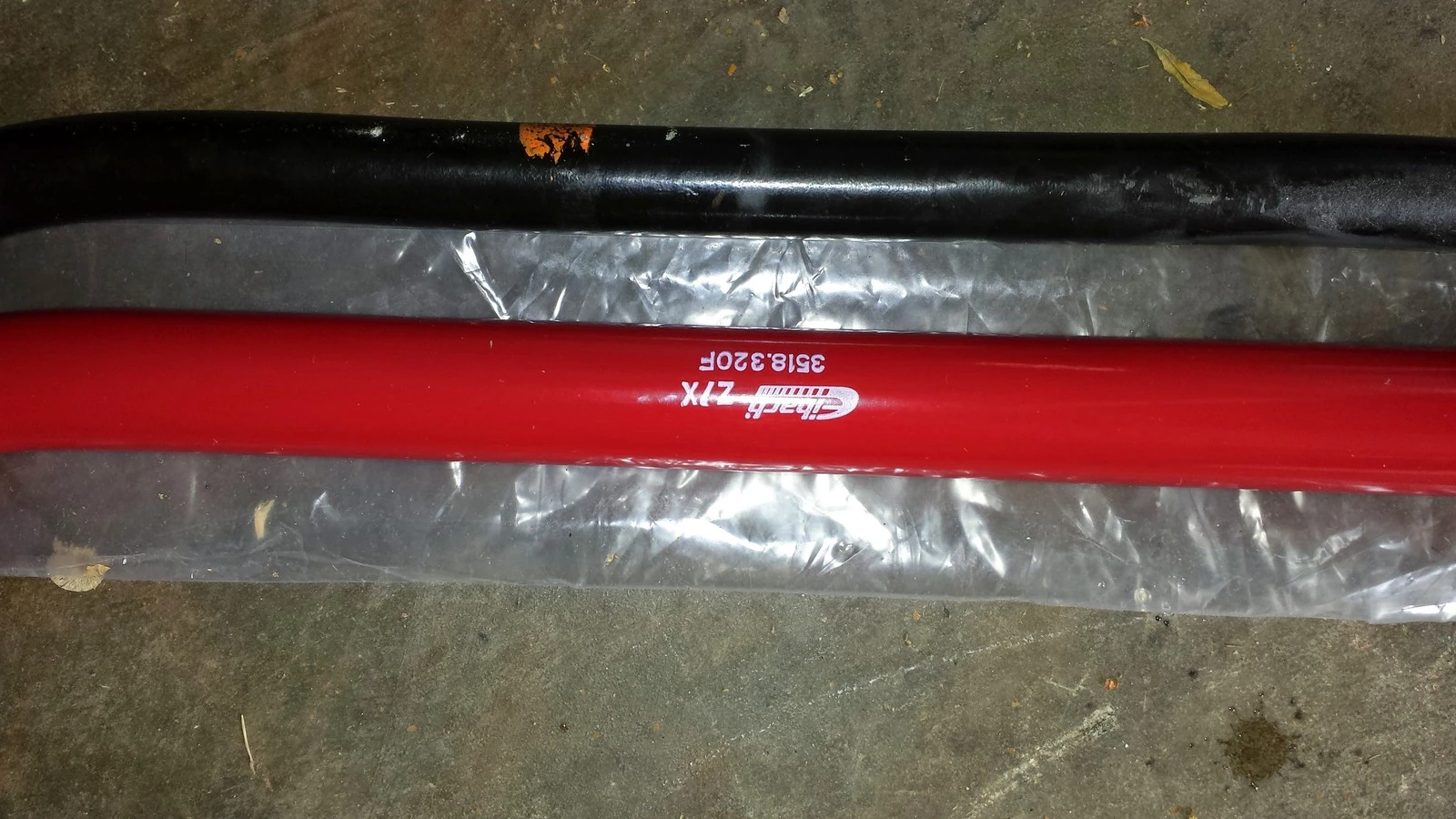

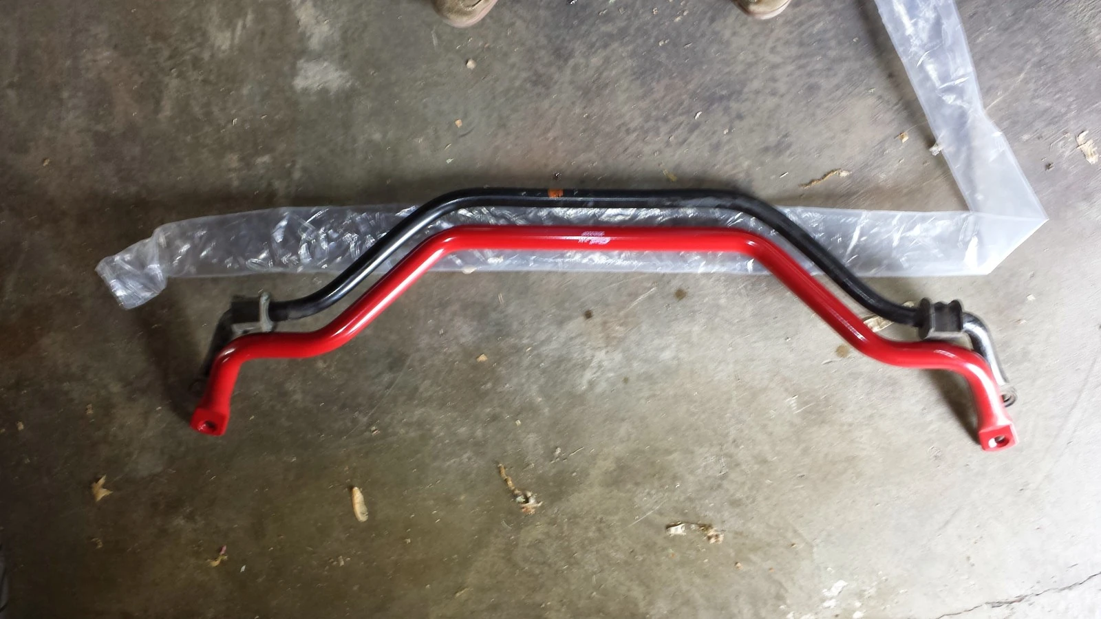

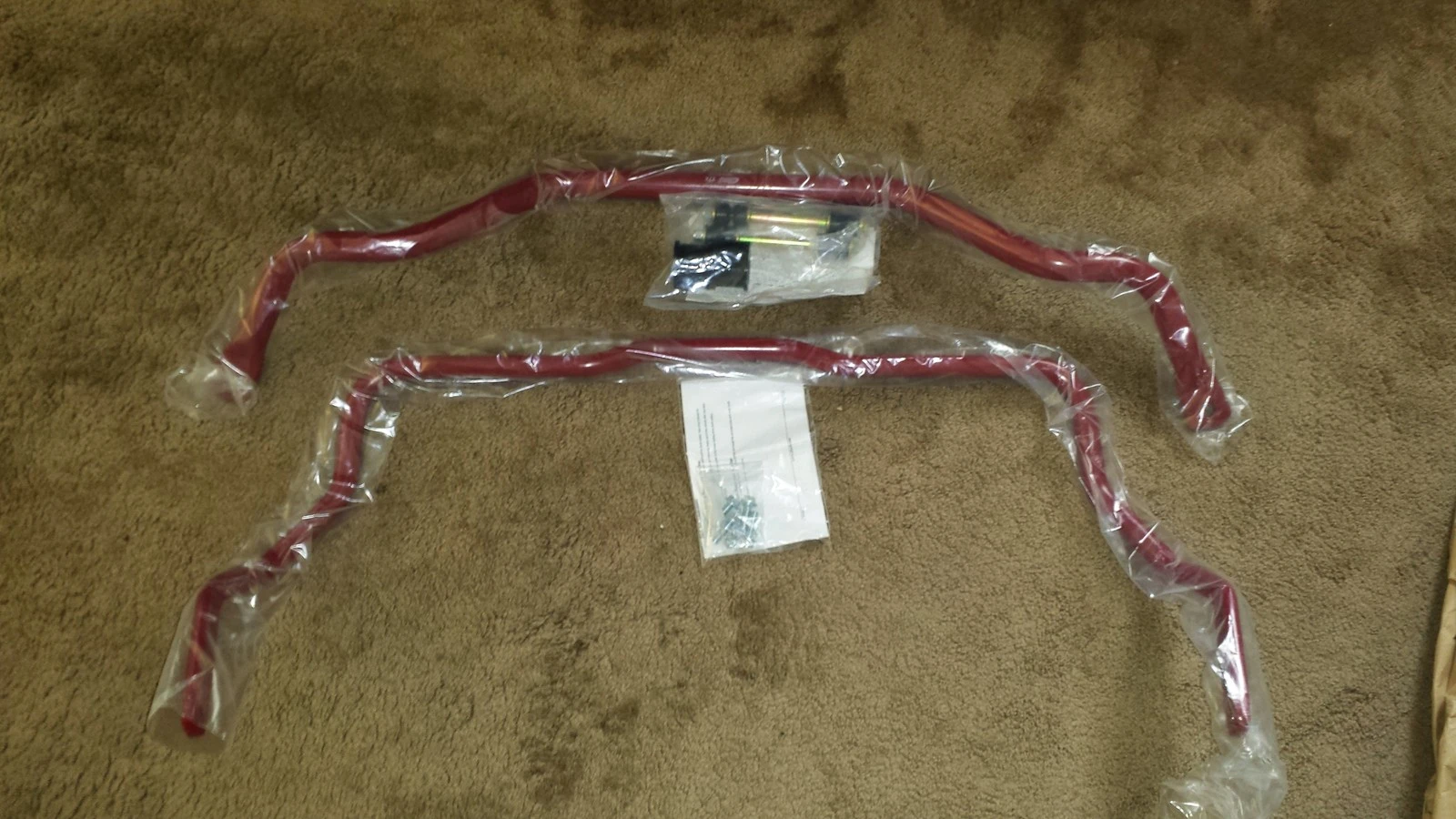

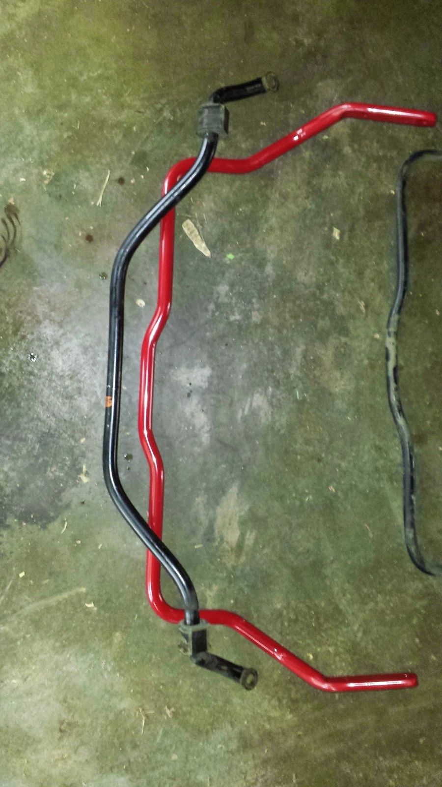

The first 2 pictures compare the stock rear bar to the new rear bar. The second 2 pictures compare the stock front bar and the new front bar. For kicks I threw in the last 2 pictures. They show how the new rear bar is as big as the stock front bar. And of course, a shot of the complete kit.
The pictures almost don't do the difference in size justice. The new front bar is massive and the rear bar obviously far exceeds either of the stockers.
