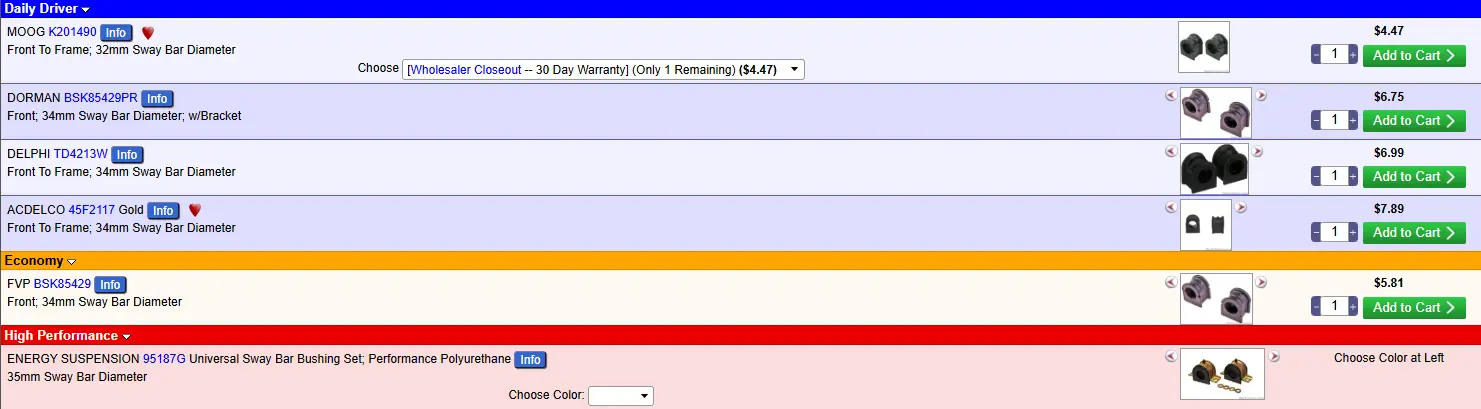

Are you sure its supposed to be 33.3mm? Just searching on RockAuto for a 2013 v6, it looks like they are 34mm:
