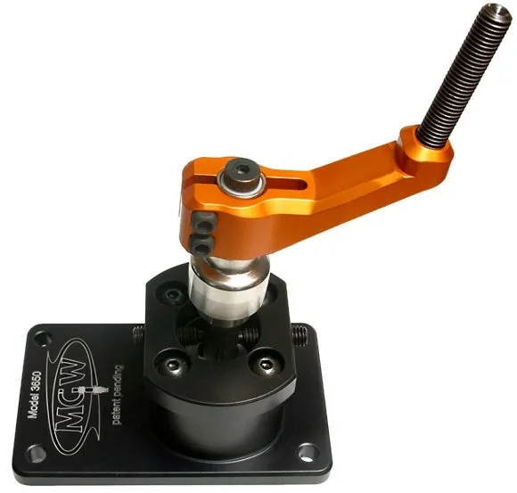

That is good to hear. I'm really not wanting to rebuild the trans after doing all the work to the engine! Although I did replace the bearing retainer. And added ONE OF THESE :rock:
