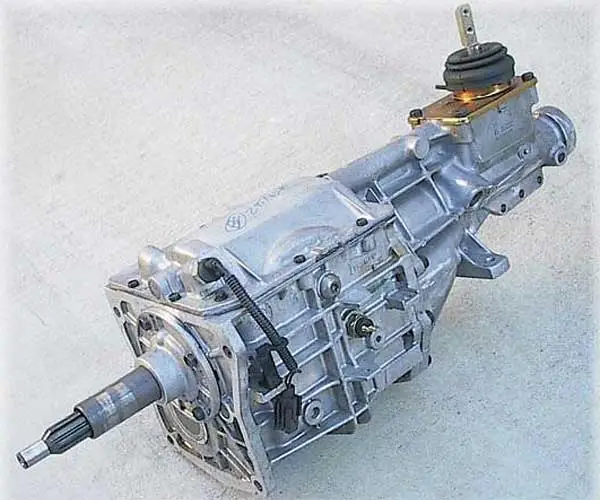

Another thought would be the bearing retainer. Does your transmission have the original aluminum retainer? What kind of shape was it in when you installed the new TOB?
Most folks swap those out for a steel one like this:
If you have not done that, then the retainer is also suspect.

It does have the original. I was really trying to replace everything I could get to. I did the rear main while it was out. What is that shaft the retainer is holding?
Thank you very much for the info Noobz. I'm sure I didn't replace that. I get a sick feeling that this tranny is coming out again. Ugh!
Either way, plan on installing a NEW Throw Out Bearing. If you see that the shaft is galled (and is the problem), don't assume than you should replace the retainer and reinstall the same TOB. Replace it anyway.
I prefer Ford OEM for Throw Out Bearings.
