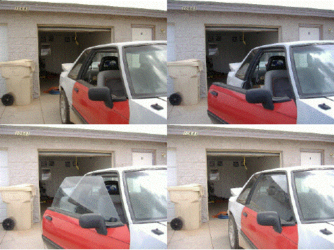

t-tops and convertibles use the same doors, the t-top will have a front edge (a-pillar) and rear edge of the window spacer that screw into the body to push the weather stripping towards the window the t-top panel will be designed to match the top of the glass. Get weather stripping specific for the t-top.
I had to get the front and rear pieces for my car because of the project I am doing to it and will have to fab up my own top of the window spacers.

i heard of FEP the vert glass and T top glass are different in the doors, but the doors themselves are the same..Thanks for the Pics BTW and are you doing a full writeup on your conversion?
YW on the pics. I will do some kind of write up on it as I get more done at least on my web site I'm rebuilding right now. I've had to put my build on hold for a while, have other pressing financial matters I have to deal with first. Sure miss driving the Mustang, my wifes Areostar is far from my LX even with 1994 pony wheels on it LOL.
