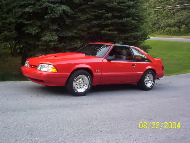

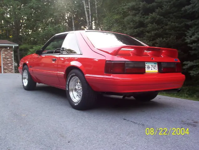

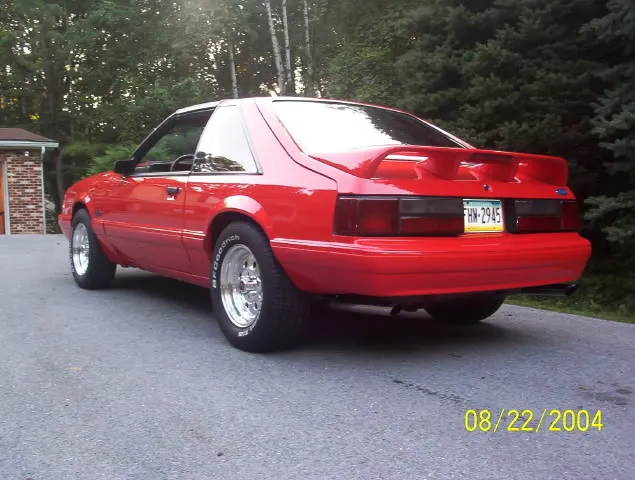

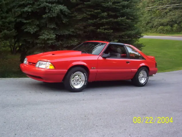

Well, it wasn't as simple as just changing glasses. I would have had to cut off the triangular post where the mirrors bolt in on the t-top doors and tried to make that right or then you'd have a gap in the front if you just changed glasses. My doors were rusted bad from the molding down so I cut the doors totally in half and welded the vert door bottoms onto the t-top doors. I extended the vert doors to the interior and up under the door panel. My main seam is under the side molding on the exterior and then I welded them through both jams and around the back and the other seam is just under the door panel. Turned out really nice. Can't see any seams anywhere. Here's a few pics of the car.
