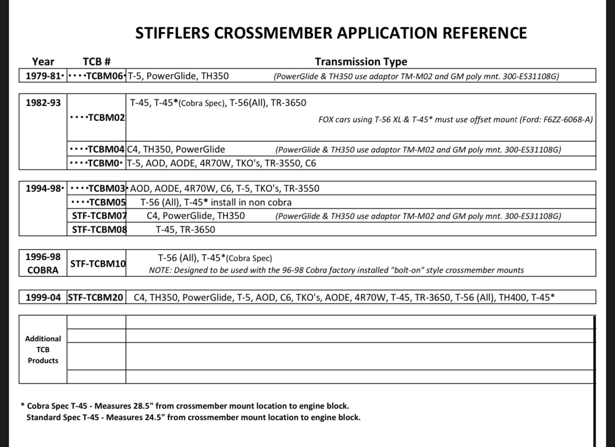

you’ll have to do some legwork here. If you notice, on the Stifflers application guide, they list three different crossmembers for using a T5, t45(cobra) and t45(Gt) in a 94-98 SN95.
According to the above chart, this is the one you want.

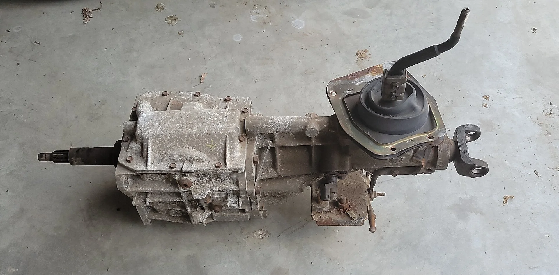

So here is a T5 from a '95 V6. You will note the plate at the trans mount that actually moves the mount rearward. I have recently pulled three (3) '94-'98 V6 T5's in the last 2 months, all had the same mount.
I just did an auto to T5 swap in my '90 GT using a T5 from a '96 V6 and a '95 5.0 bellhousing. I removed this extra plate and mounted the trans mount directly to the trans (just like normally on a fox). For your install into an SN95 you will probably want the plate installed.

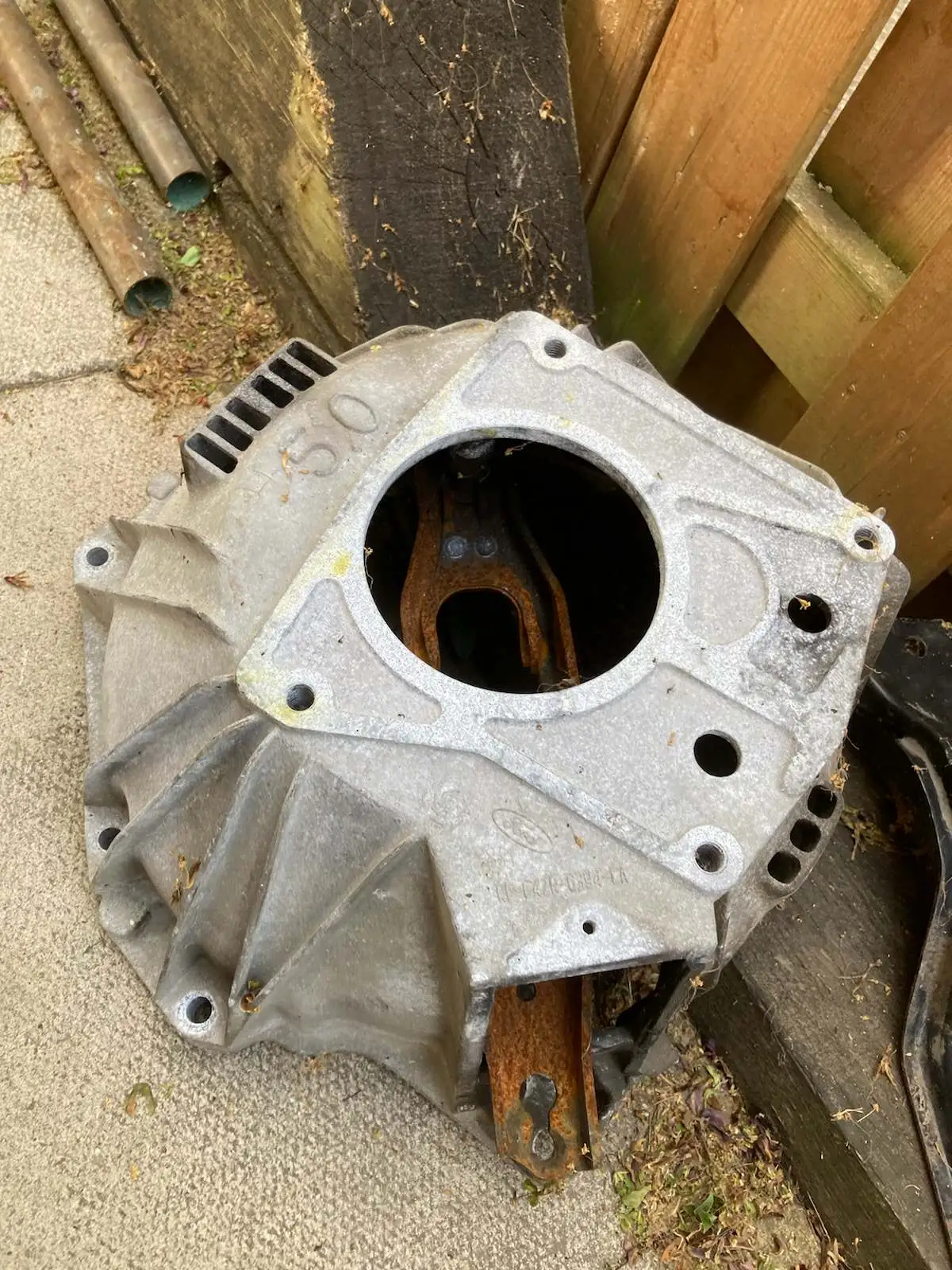

The bellhousing for V6 or V8 is identified right on the bell. Bell needs to match the engine being used.
