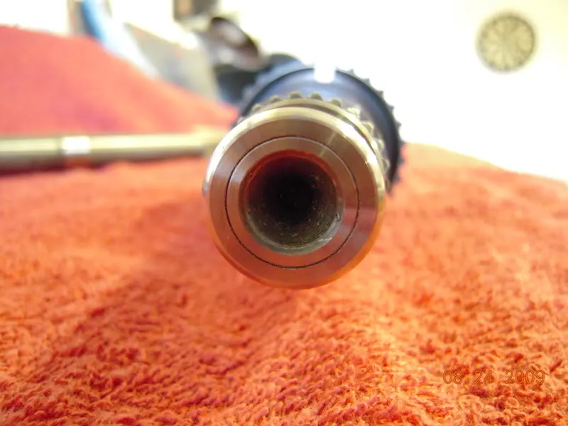

I've seen the main shaft sleeve before. Better than original. The stock shaft is only hardened on the outer surface. Once that's worn through, it's done.
The sleeved ones I saw had 3mm of hardened bushing on the end. You're likely to wear the rest of the trams out a couple of times before wearing that out of spec.

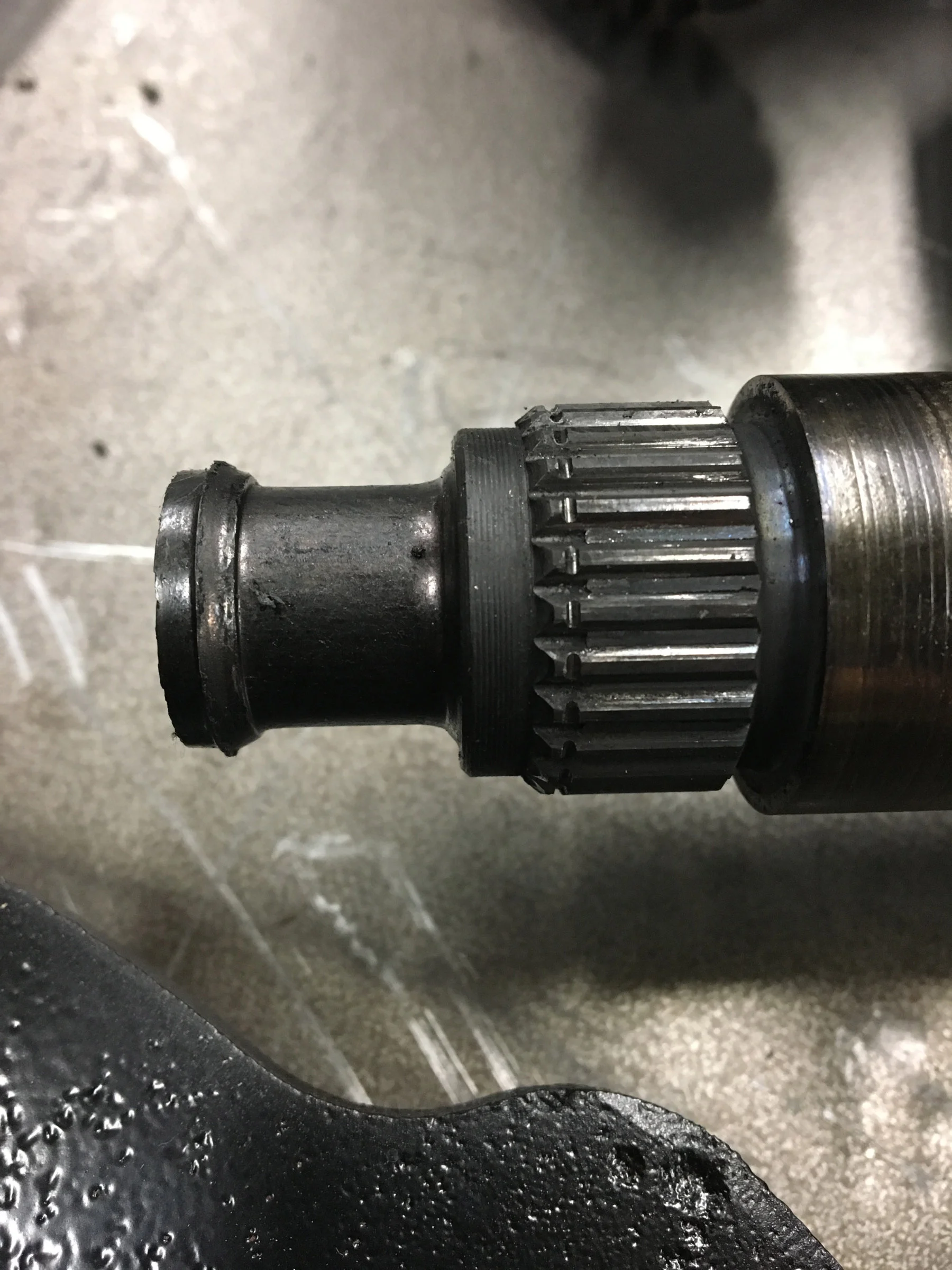

Hello, I new here...hoping someone can help me with a t5 transmission rebuild. I hope its okay to piggyback on this thread.
I pulled the tranny out of my 89 5.0. The main shaft bearing surface under 3rd gear is gouged and I'm looking to replace the main shaft. I have found new and used main shafts for sale, but they all look different than mine. My main shaft has a flared tip (Not the tapered barring like on the cobras and Z trans). all others I have seen have a straight tip. I'm referring to the tip that inserts into the input shaft and rolls on the needle bearings.
No one I see selling new or used main shafts specifies a difference. Can I use a main shaft with a straight tip? If so do I need a new/different input shaft. If not where can I find an affordable replacement.

Can you post a pic of your tranny? Also the id tag, if you have one.
