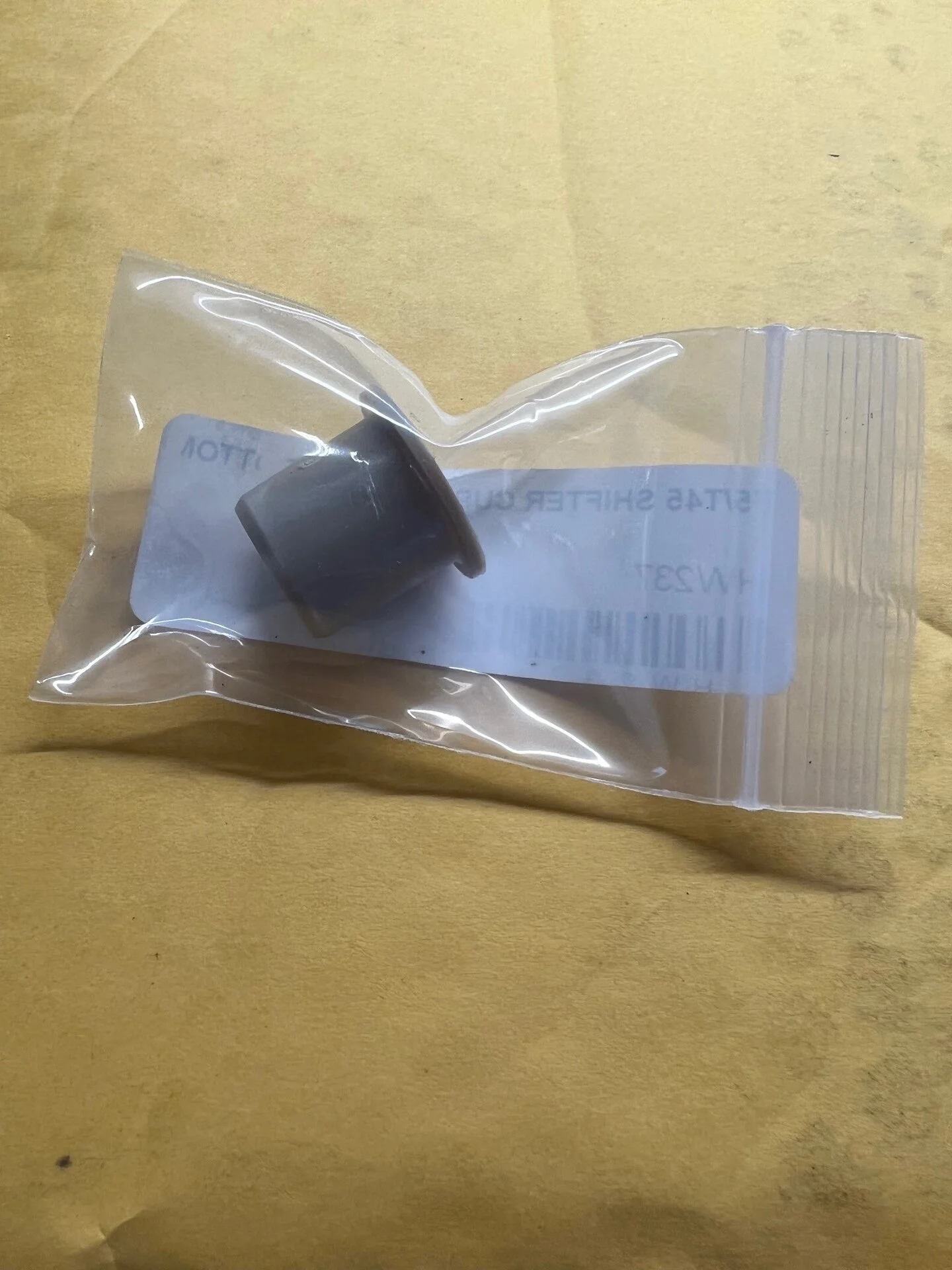

Sure enough, when I opened it up, the bushing was still on the end of the arm, but the bottom part of it had worn/broken off and was sitting in the pan below the shifter, as you can see in the images. Sharing this here in case anyone has a similar issue, this could be your fix. Stupid and a small PITA to have a new one break after less than 2 years of use, but it is what it is. The replacement that broke was from LMR. For the new one, I decided to order from CJ. It looks like a slightly different material, and maybe a little more durable. Hopefully it lasts longer. I could tell right away after replacing it that the play was almost totally gone, and it felt like it did when I first swapped it out again.
