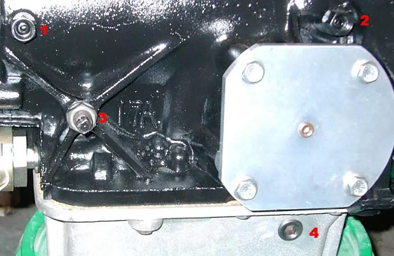

swap is going well
I got the T5 out today
replaced the rear main seal (just in case since it was there)
I will flush the convertor tomorrow and mount the flex plate
The C4 was in the car before. I got it with the T5 in it. The C4 was wasted do to an improper build.

they dont know what they are talking about. the driveshaft wont need to be shortened at all. at any rate, the c4 that is in my car is lighter than the tko 500 that i took out. and thats including the bellhousing on both and the clutch and converter
here it is
