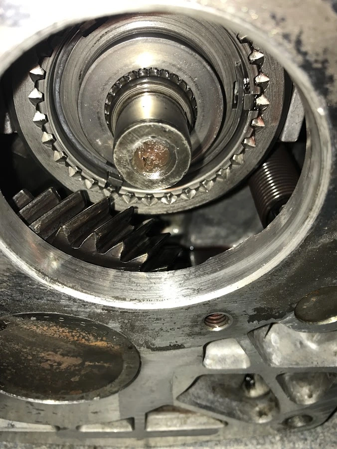

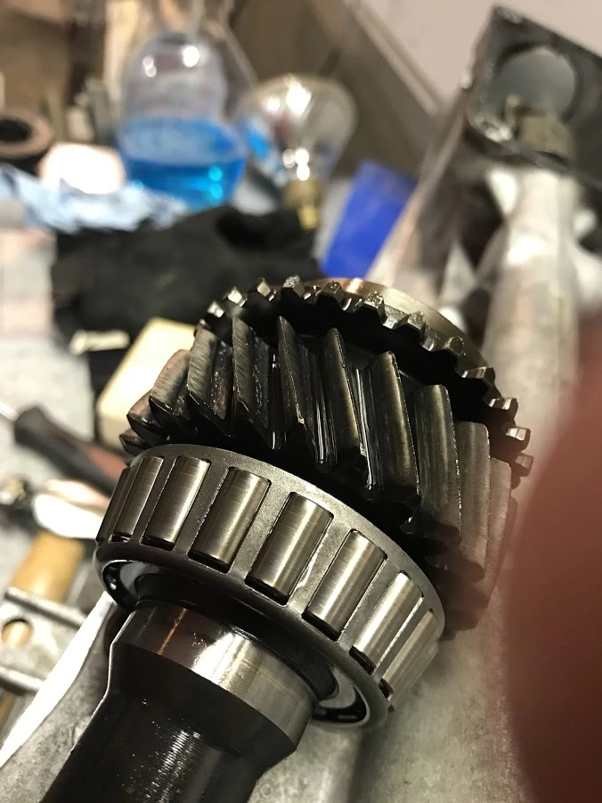

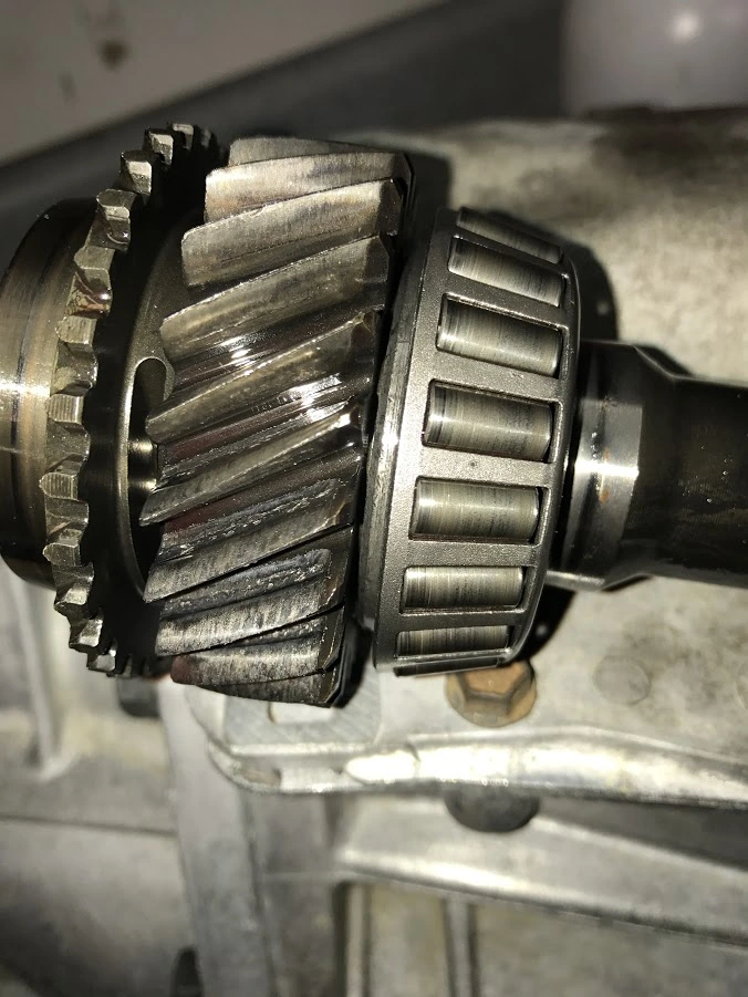

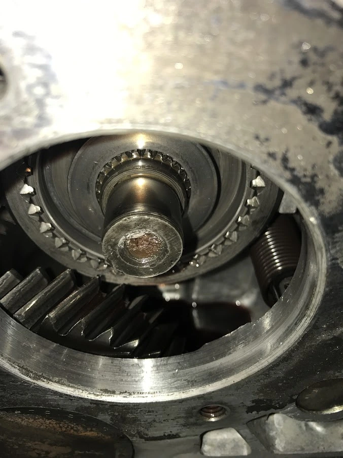

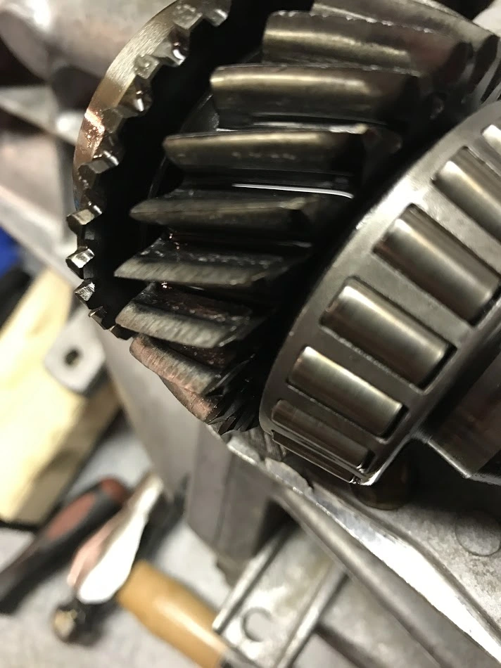

So I have the notorious whine that is worse in 1st and non existent in 4th and very faint in 5th. Just pulled the tran in the process of fixing oil leaks. I have just pulled the input shaft as I suspected the tip of the main shaft would be galled but it looks good. The input shaft gear looks rough and the teeth are razor sharp. The cluster gear looks to have decent wear as well.
I would love the opinion of those familiar with these to tell me what you see. I will be breaking the case open as I need to pull the tailshaft to put in a new bushing but not diving into this just yet until I get the other stuff done.
t5_input1.webp t5_input2.webp t5_input3.webp t5_maintip1.webp t5_maintip2.webp
Input shaft to countergear mesh is bad which caused the whine under load.
Id check tooth counts of the input and countergear to confirm they are part of the same gearset. How many teeth is that input?

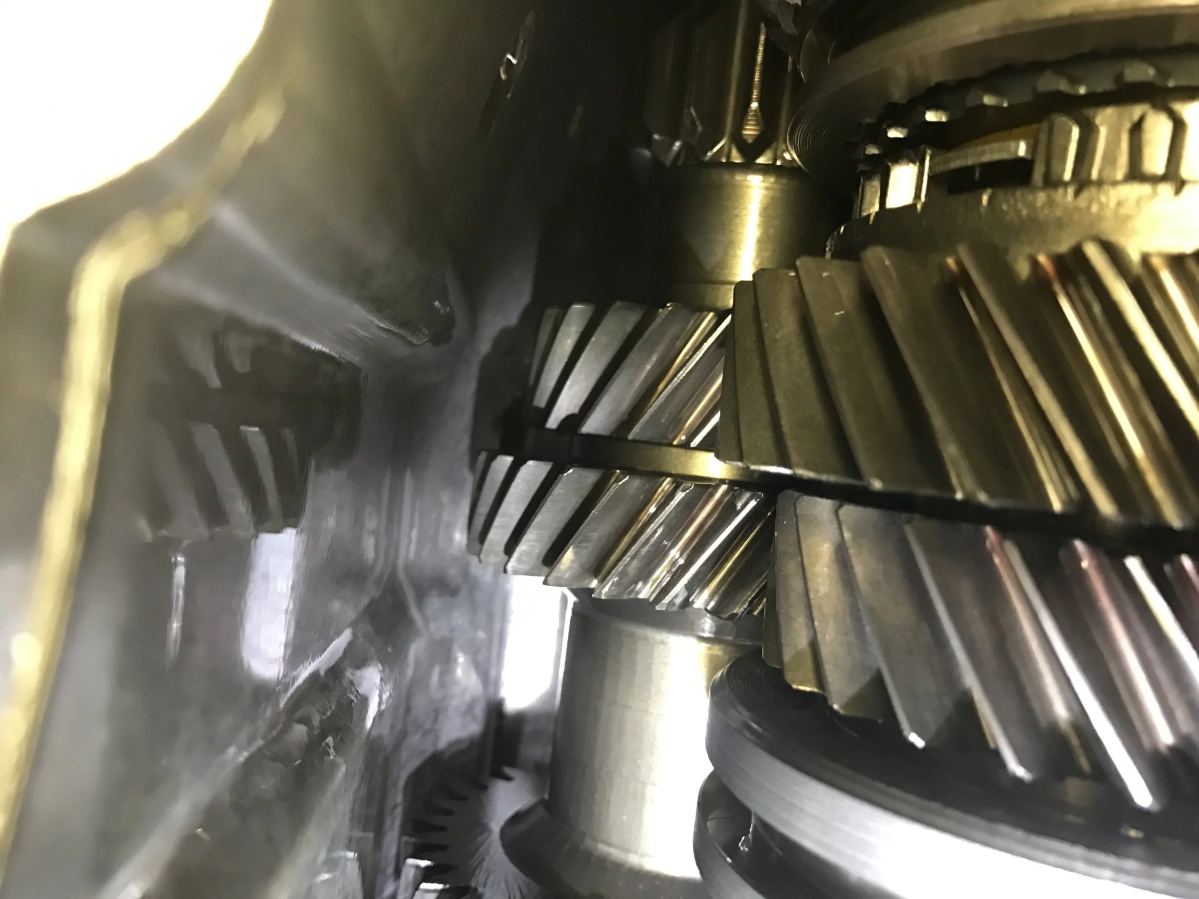

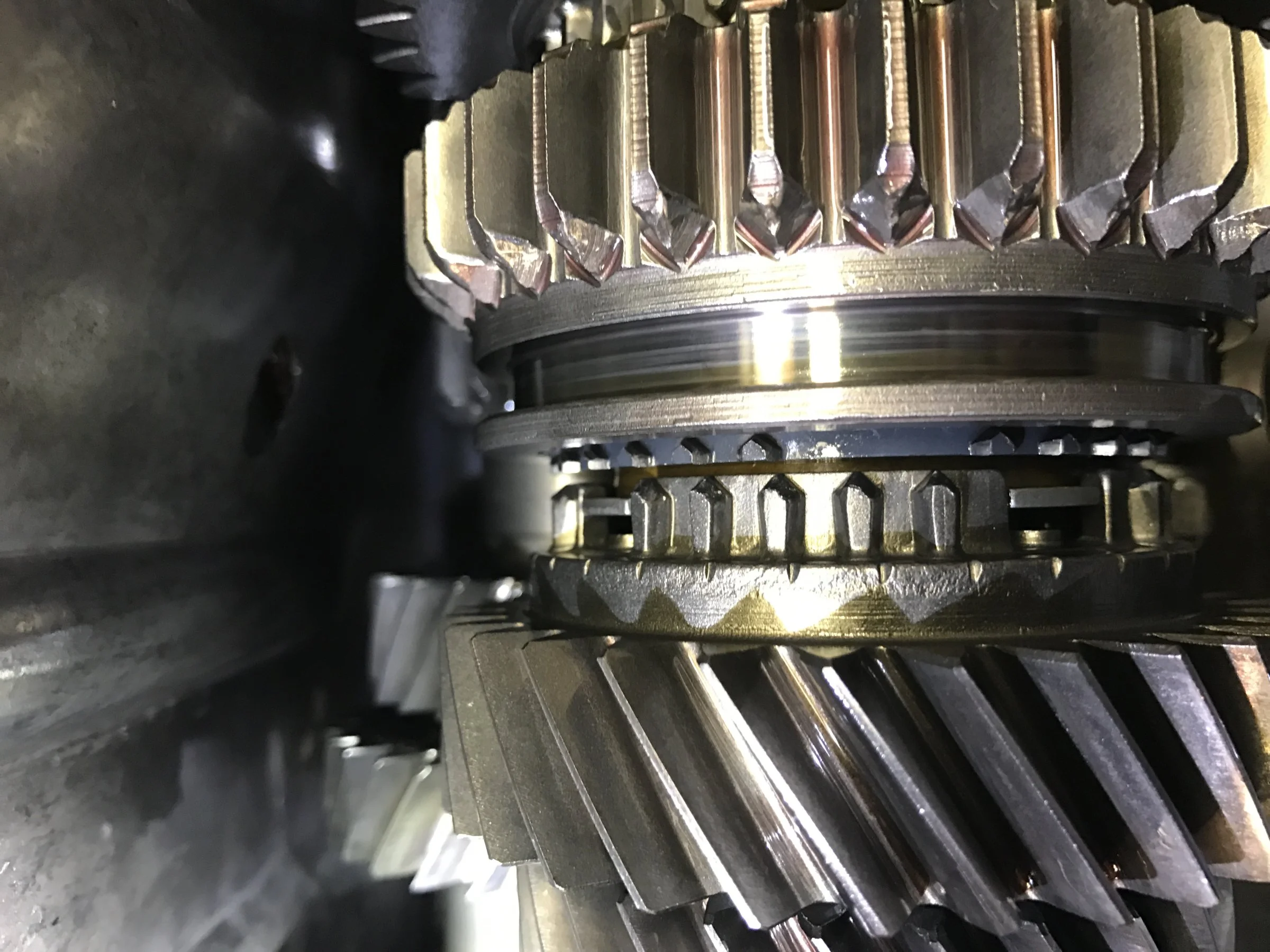

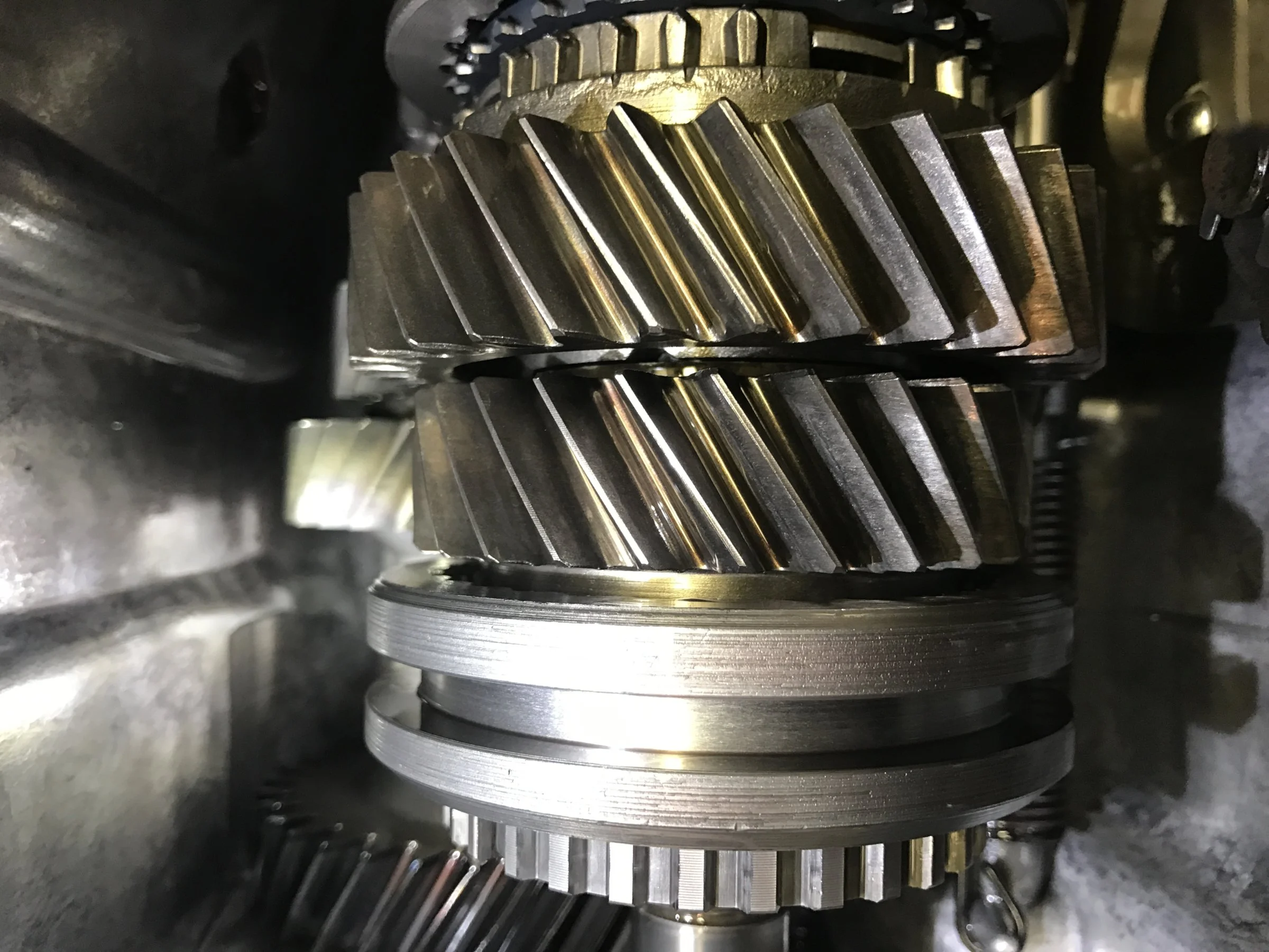

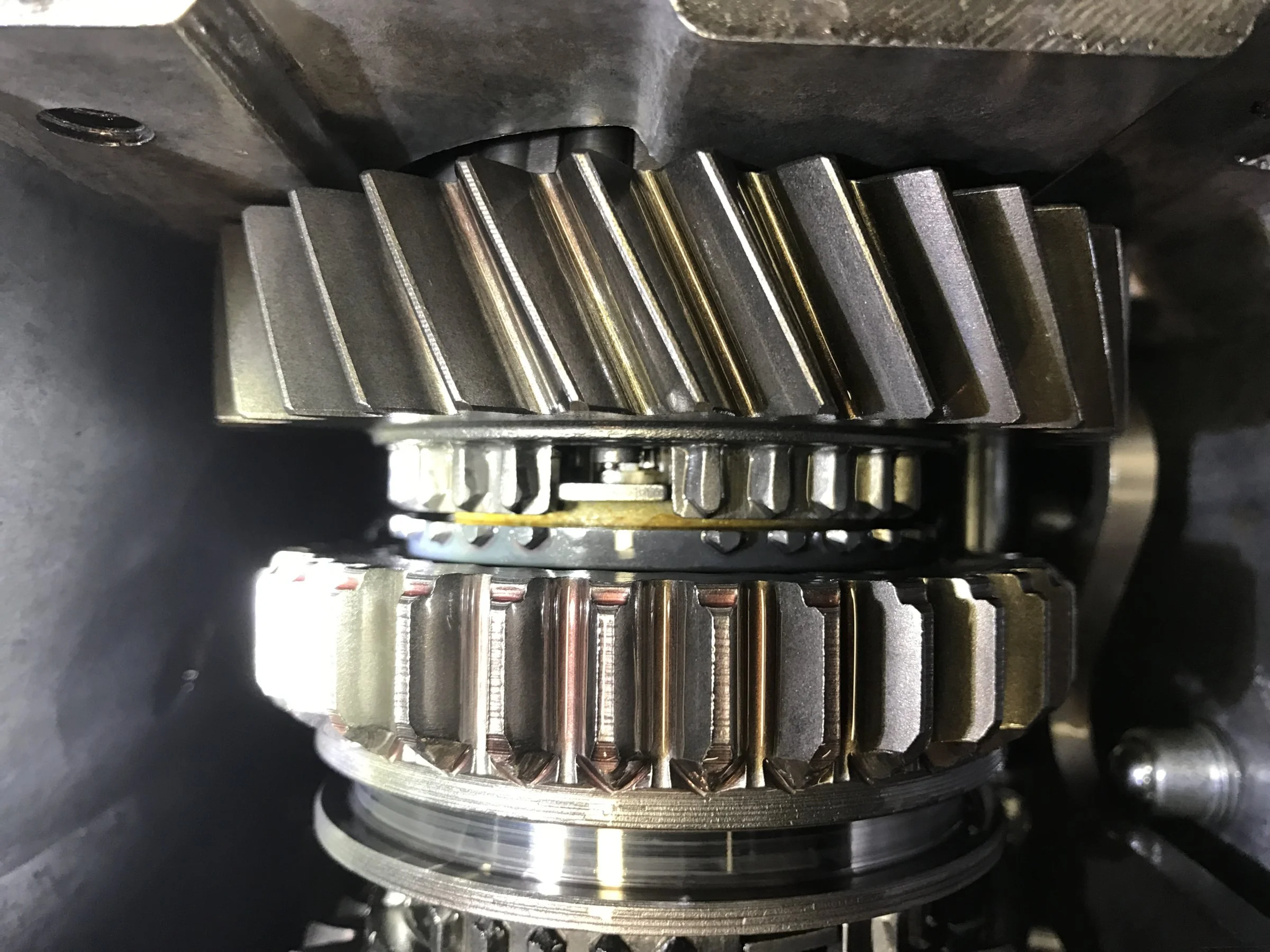

Finally got around to breaking this thing down a bit more to see inside. Obviously need to input shaft and cluster gear but is anything else glaring that needs to be replaced from the pics?
Here is a quick video of the gears inside the case. Keep in mind I already had 5th gear off so main shaft is loose which is why it sounds so bad when turning it.
https://goo.gl/photos/HAvFYu3uSxhDD57Q9
First photo. Need to inspect the dog teeth very carefully and the mating engagement teeth on the synchro. When they start to deform, you start getting grinding issues. You can see the teeth on 2nd gear are starting to look a bit "mashed" on one side. Do you ever have issues with 2nd gear?
Inspect the mating synchro on the inside for damage as well. I would consider replacing these while I'm here, or you can just roll the dice.
I'd inspect the teeth on the other gears as well.

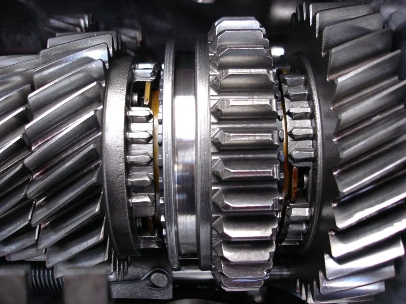

Here's a shot of the same area on a t5 I rebuilt with new parts. The teeth should all have a shape similar to this. 1st on the right, 2nd gear on the left. The straight cut teeth in the center pic is where reverese engages. This is a new gear, but the wear on yours isn't bad really.
