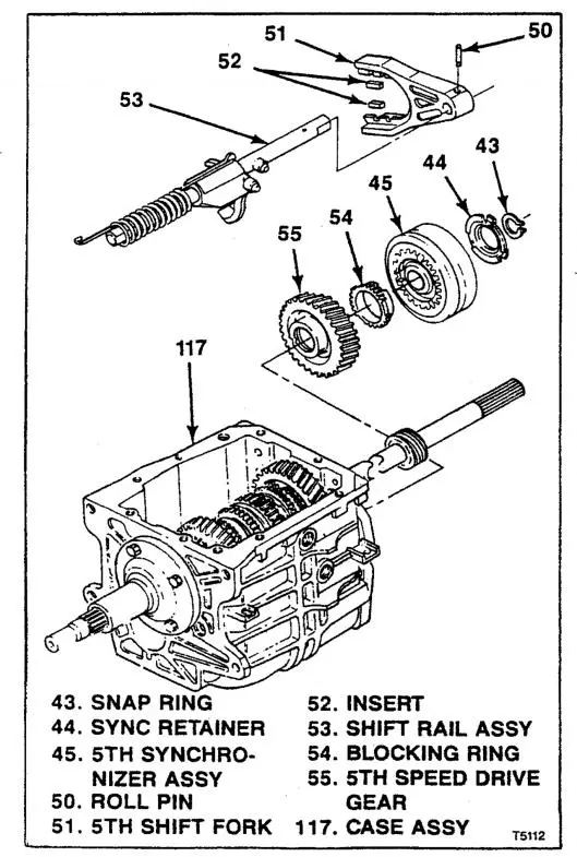

Hi, I have installed a brand new T5-Z spec in my Plus 8 Morgan (240 hp). Everything was Ok and quiet for the first 75 miles. When I took it out the next time as soon as I put it in 5th gear and put it under load, this loud rattling noise came from the gearbox. The other four gears are quiet. The shifter also jerks back (1/8" at the top of the 6" lever) quite violently but a few seconds after the noise starts. The noise is a loud whirring and sounds like someone gargling. Oil level is correct and ATF. The box is out of the car and all looks ok inside. Any suggestions as to the cause please?
The snap ring on the countershaft may have popped loose...
You will have to pull the tailshaft housing off to fix it. In order to get the tailshaft off, you have to remove the shifter and the roll pin that secures the shifter rails. That means removing the trans from the car unless you have magic hands...
Thanks for your reply. I'm in the UK so expect a big time difference in the responses.
I thought it might be the snap ring but I checked that and it is still in place. Everything looks ok both inside the tail housing and the box itself. The 5th gear assembly seems very sloppy though and something on there must be kicking back to make the shift lever jerk back (as described in my post above).
With the syncro assembly engaged in 5th, I cannot understand what is causing the loud whirring noise.

It’s a bearing preload or failure issue.
Forgive a poor layman Morgan owner: What does "bearing preload" mean.? What bothers me a lot is that my first T5 failed with a bang and then 5th rattling like a combine. And now, brand new T5, rattling (without the bang), but still. Two new T5s both defective? Or did we do something wrong when fitting them?
If by "fitting" you mean "installing" then no. It is very unlikely that the install did anything to the transmission itself.
Now, this does [not] mean there wasn't an issue with the clutch install.
Bearing preload is the torque setting and/or engagement measurement required for a component during install. An example would be a bearing or seat that is installed at one torque, backed off, and re-torqued to the operating spec. If not done correctly, it can cause issues. Not your fault if this is the case. It's the fault of the whomever built the transmision.
One other thing comes to mind:
I've [never] had to do this with a Fox bell housing and a T5 but... You may want to check bellhousing runout and ensure that trans is completely centered when installed. There may be some slop somewhere if this issue recurring.
The input shaft and counter have shims to set the preload on the bearings. It’s super common for the input shaft to fall out of spec over time and less common for the counter shaft but parts do wear over time.
