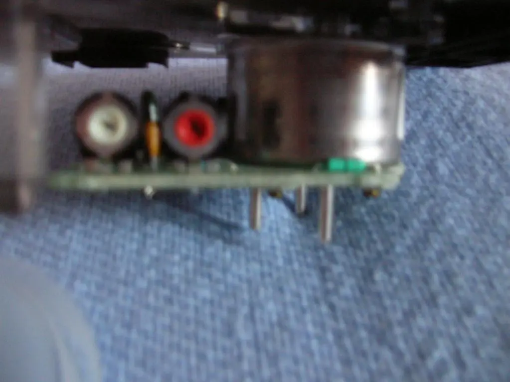

my 92 5.0 tach has the same problem i think it is the green diode with the black stripe at the right of the pictures , it reads no resistance in both direction just like a soild wire? can anyone can tell me what this componet is ? thanks

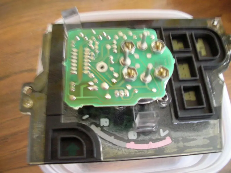

i did some checking with the ohmmeter today and found out that one of the nuts that connects the circut board to the motor was not making a connection between one of the 4 treaded posts and the circut board, may have came loose from vibration, now the tach checks out ok. this may be the problem with all the tachs that quit working
