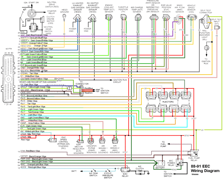

The tach signal is a pulse. The factory pickup spot is pin 4on the computer, IDM. The wire color is a dark green/yellow for 88-91 cars. Aftermarket tachs use the same wire, but pick up the connection point on the ignition coil.
See the following website for some help from Tmoss (diagram designer) & Stang&2Birds (website host) for help on 88-95 wiring Mustang FAQ - Engine Information Everyone should bookmark this site.
Ignition switch wiring
Complete computer, actuator & sensor wiring diagram for 91-93 Mass Air Mustangs
http://www.veryuseful.com/mustang/tech/engine/images/91-93_5.0_EEC_Wiring_Diagram.gif
