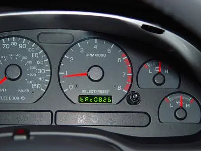

Would you guys mind putting some pics up of your tach setups. I'm not sure if I want to drill a hole in the dash for wiring or route it along the center of the console,.....what to do, what to do,..........
Thanks
David
Mine is setup just like Bill's (Mustang92) Here is a pic of his.
