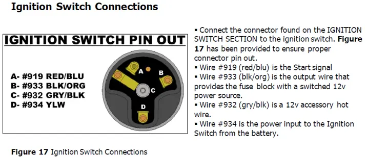

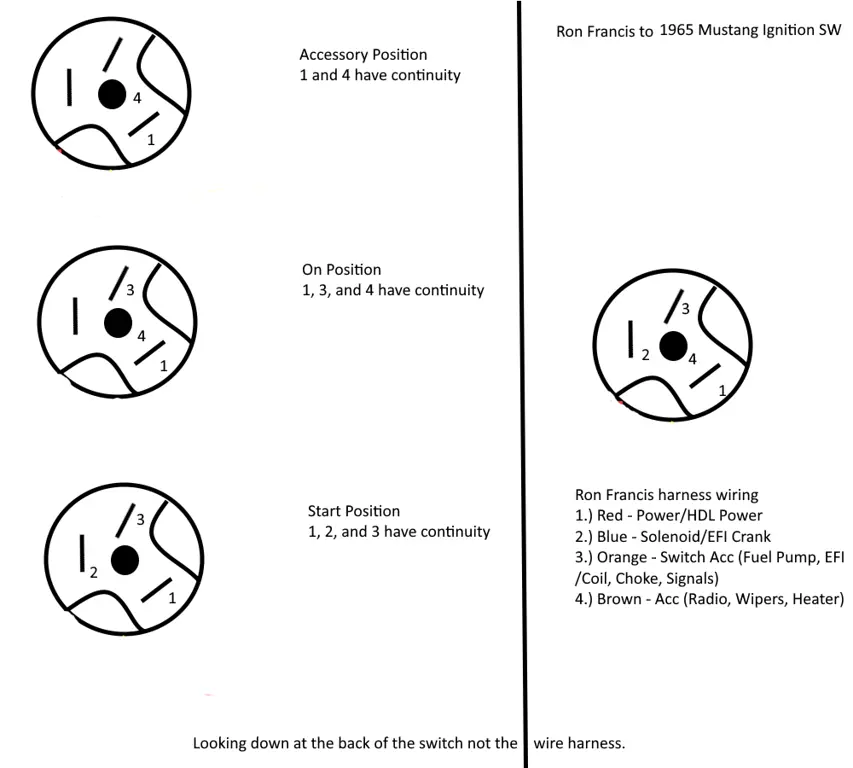

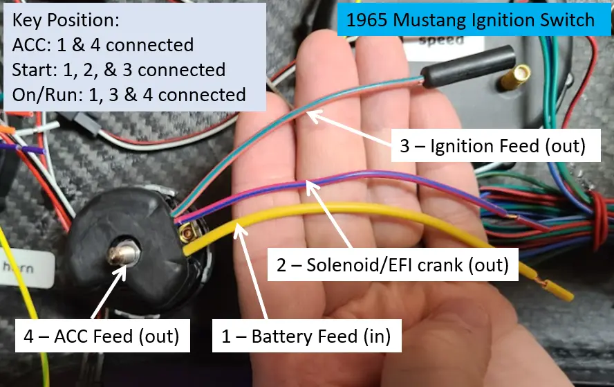

You hooked the red 12+ wire to the stud on the back of the ignition switch - am I understanding you correctly? I believe you'll want to splice it onto terminal B as indicated in this illustration.

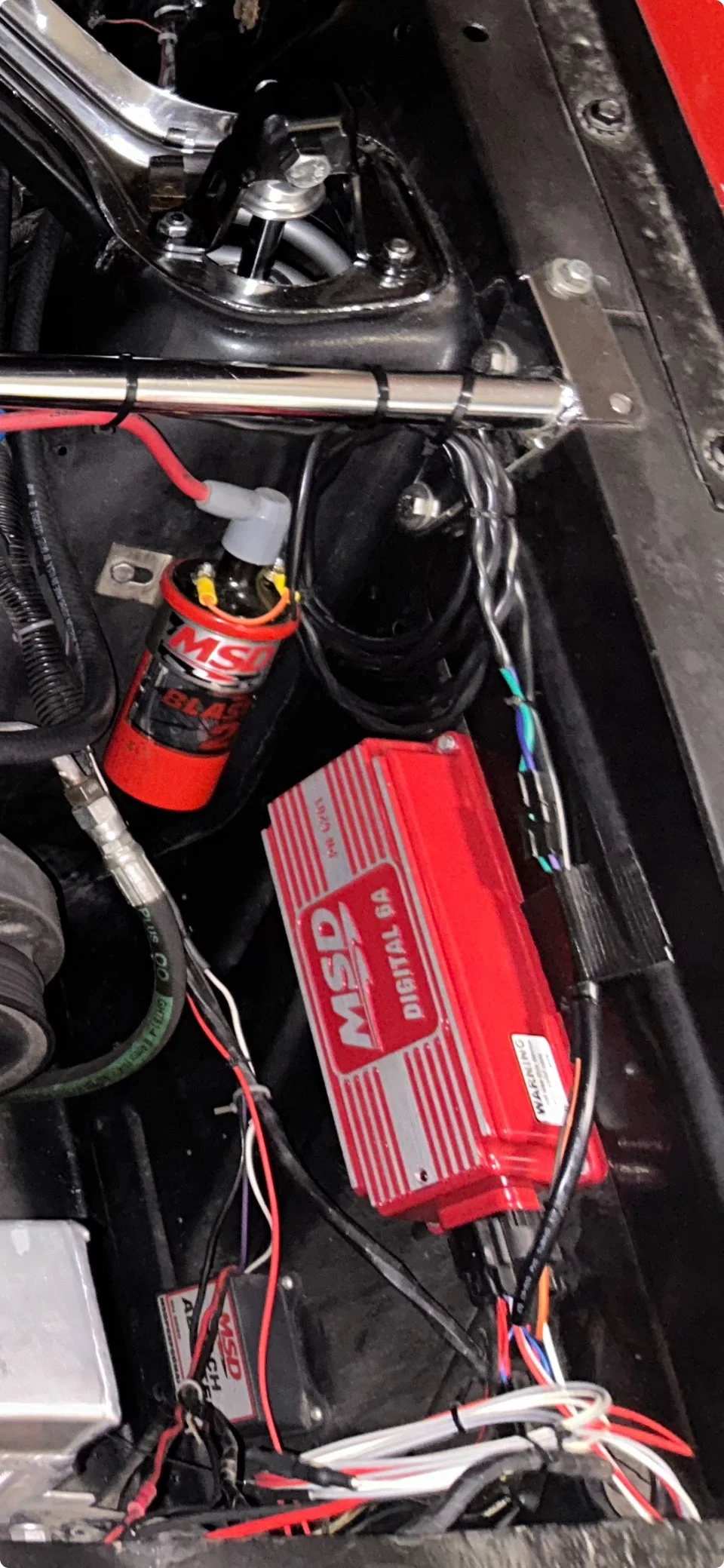

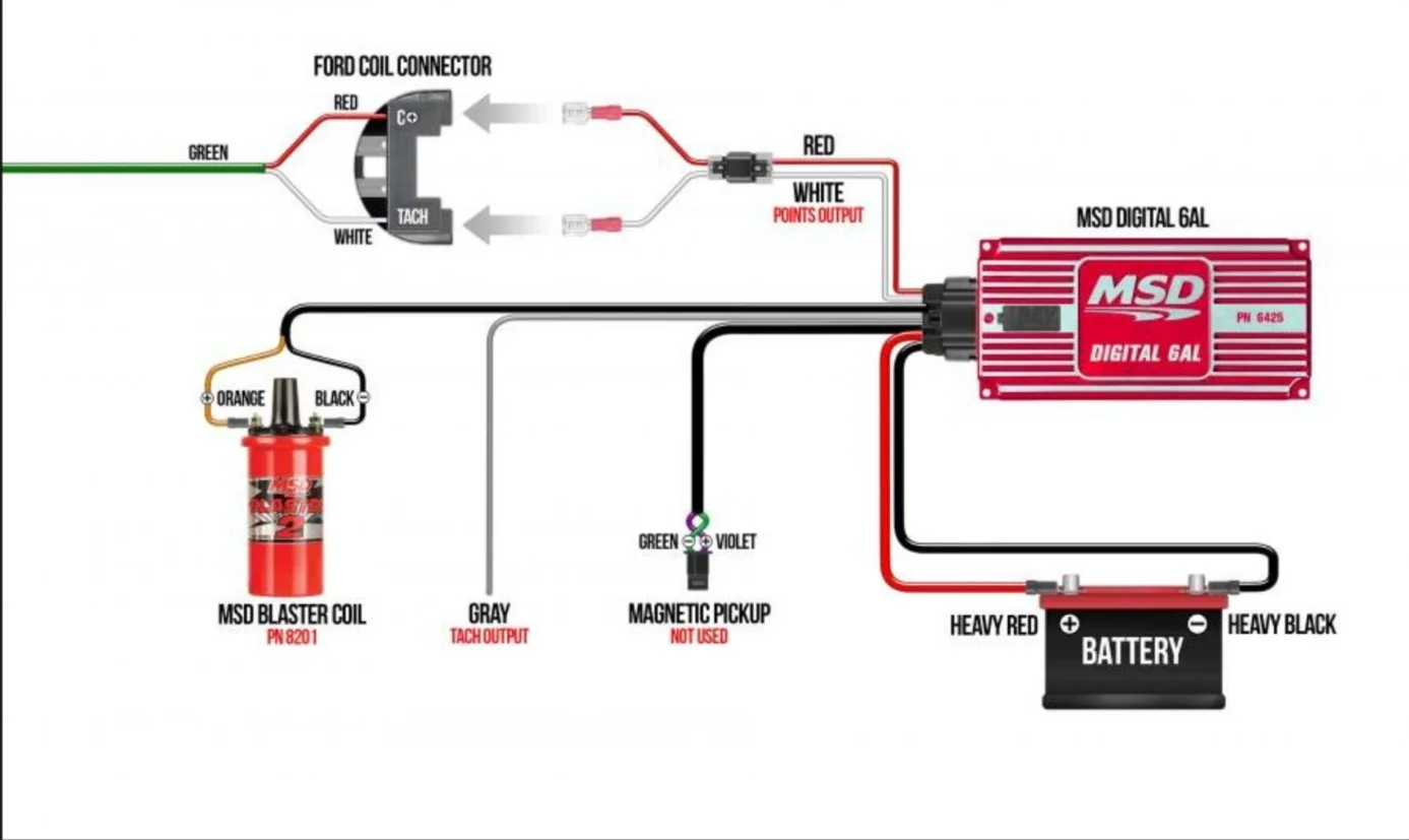

Oh, another thing - you said you have an MSD coil (sorry, your original post said it was something different and kinda threw me....) - are you running an MSD box like a 6AL? I'm assuming no since you followed the directions for a car that isn't equipped. If you do have an MSD of some sort, you'll need to connect the green wire to the tach output from the ignition box. Since the MSD has multiple sparks per cylinder per power stroke at certain RPMs, the tach will have issues reading it. The tach output from the MSD box is intended to correct that function. Here is a 6AL diagram.
Shoot, I think I need to start over as I am sending or writing down the wrong info here I believe. I do have a MSD 6AL 6201 box and I see the previous owners added a MSD tach adapter but nothing was wired up right(some wires not wired at all). Sounds like the way I was first trying to install the tach was wrong. If you think I dont need the tach adapter I would be more than happy to pull that out.

Hopefully these links work, but these are instructions for both the MSD and the tach that is listed on O'Reilly's site for reference.
The MSD manual looks like it covers all of their products. If you go to pages 8-9 of the MSD instructions, you'll find guidance for wiring a tach or tach adapter. Going further back, around page 146, you'll find a diagram for wiring the tach adapter. There are also instructions for wiring your 6AL. I included the directions for what I assume is your tach for reference. So, what I can gather from all of this - assuming your car runs and everything else is up to snuff and all you're looking to do is get this tach installed and working as it should - is to run the green wire from the tach to the grey wire of the MSD. If this doesn't work, then you'd install the tach adapter, wire as indicated, and try again.
