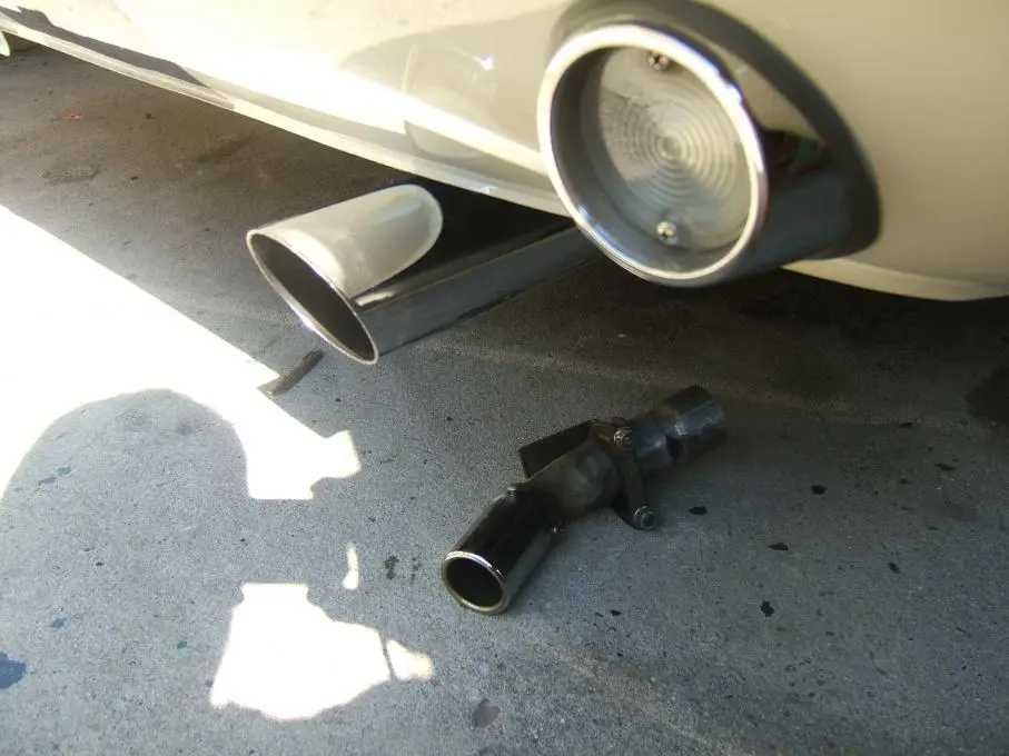

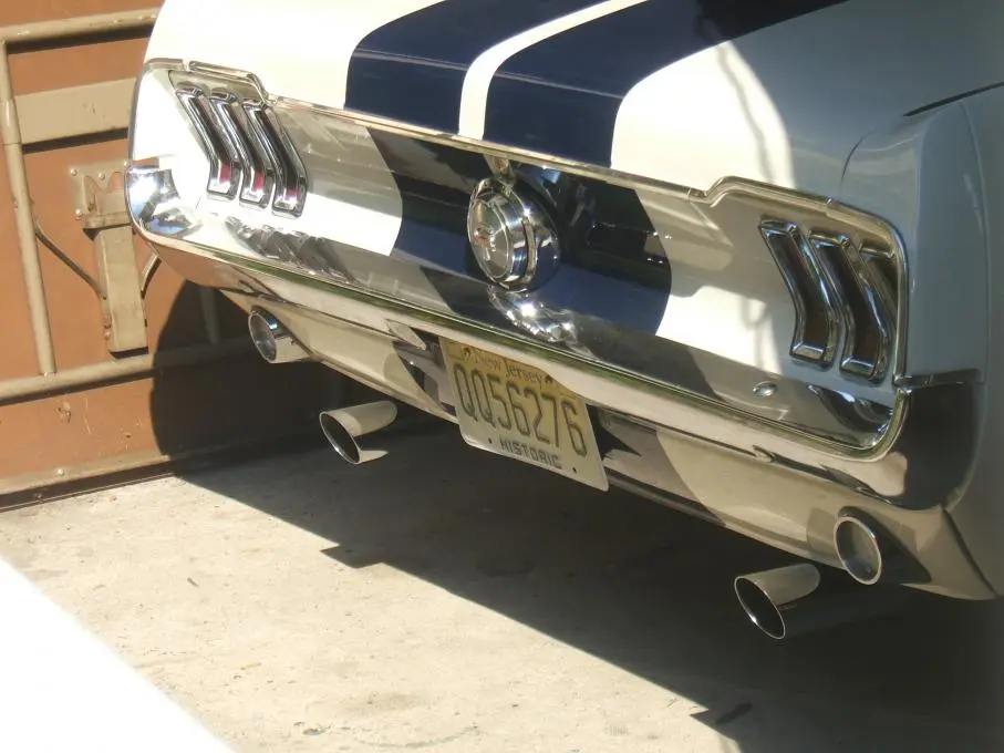

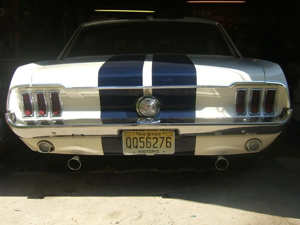

Tips are mounted. Check out Pics
I appreciate all the replies. Turns out the shop down the street worked the pipes from my existing 2" flowmaster system to accept the massive 3" 1967 Shelby tips under the valence.
The shop did it for $75 labor and in under an hour!
