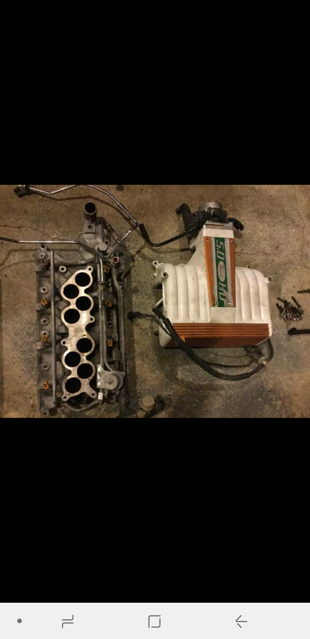

well, my project this weekend

That's a non EGR intake. Do you plan on eliminating the EGR?
justin82
Sep 14, 2017
334
17
48
Oct 19, 2017
  • Oct 19, 2017
yea, I think so
