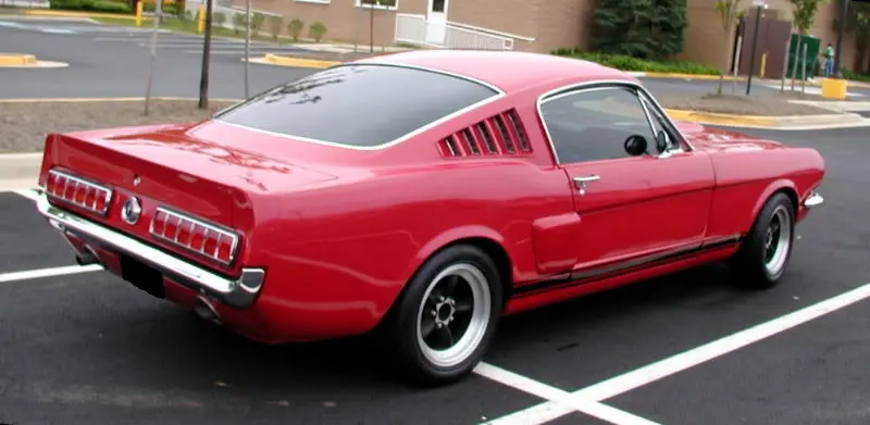

tbird lights on a 65
I would use the lense housing gasket to template the area of your tail light panel to cut out. Tape it to your taillight panel and trace around the inside perimeter with a wax pencil.
Sounds easier then the triple stock housings per side.
Tim

IMO (and that's not worth much), the T-bird tail lights look better on the wider bodied 67+ Mustangs. Sure wish I liked it though, because it looks killer on the 67+ cars. If only the lights were scaled down... Hmmmm
