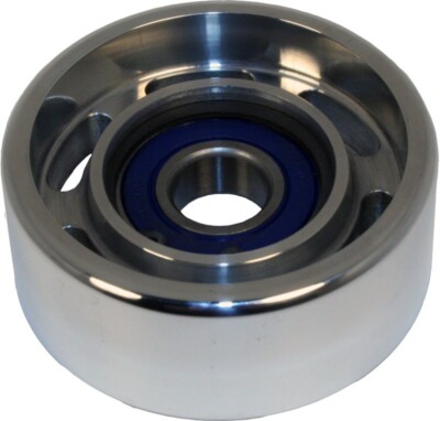

Anything's replaceable, stock pulley is stamped 2pc and riveted though, kind of chintzy, Pro 5.0 still sells a stainless one on fleebay. Upr, wazee and steeda have billet ones with serviceable bearings. I have a few of pro 5.0 ones since there here in a day or less snail mail since he's just upstate.
Upr and steeda have thiers on there sites...
I replaced the bearing in my original 83 tensioner.... You will need a press to remove the old one, at least I did... It was really tight.. Other than that it was pretty basic... I " think " there is a snap ring involved, so look for one before you beat or press on it...

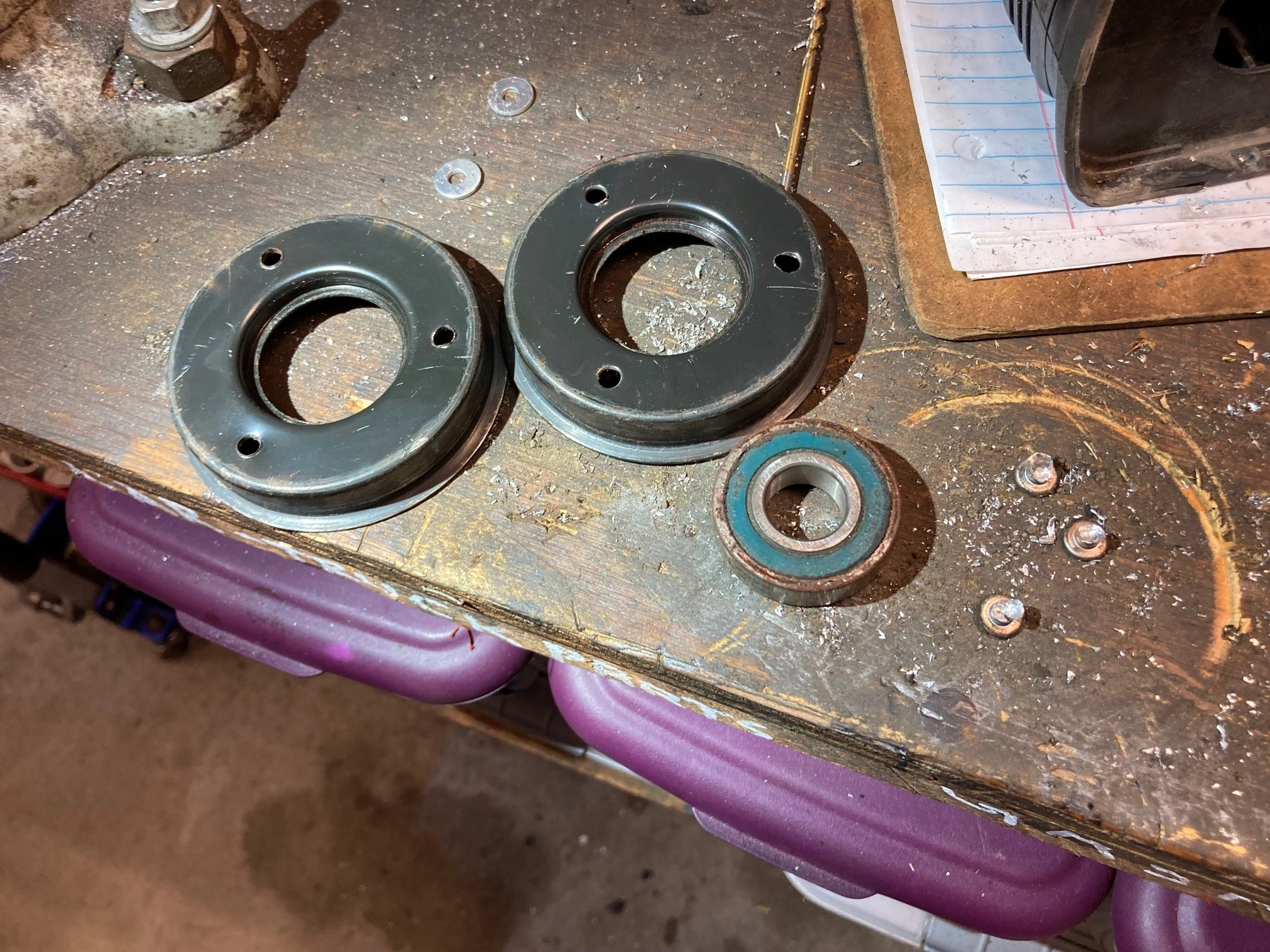

I've done that, not sure on years but on mine I drilled 3 rivets and separated the 2 half's with a flathead then I put a quality bearing in it and had to source 3 small screws to put it all back together, the rivets it had original were not run of the mill rivets.
If I had to to do it again I wouldn't, on eBay there is a guy selling some really nice billet tensioner pulleys for like 45 bucks, he's sold like 400 of them, I believe they are listed under UPR, I've been meaning to pick one up.

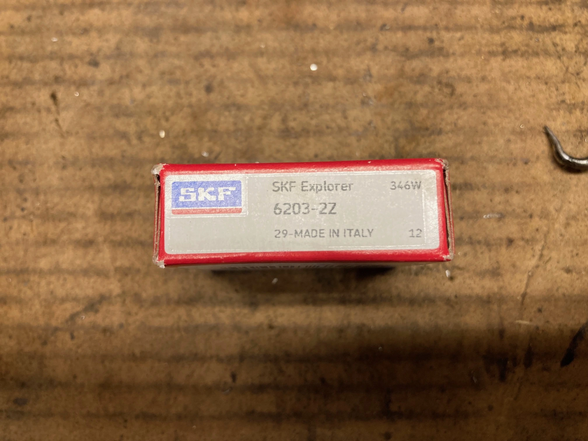

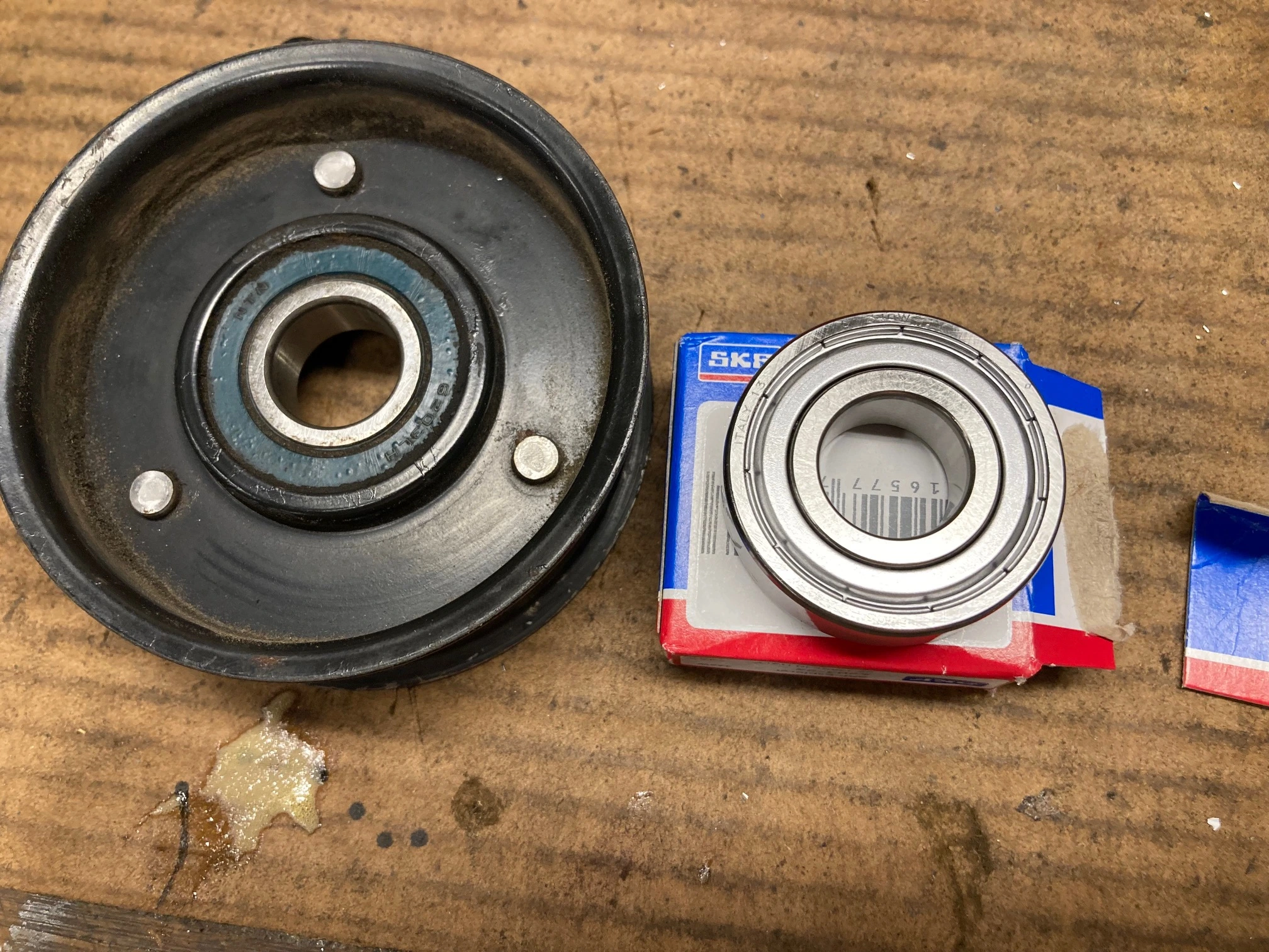

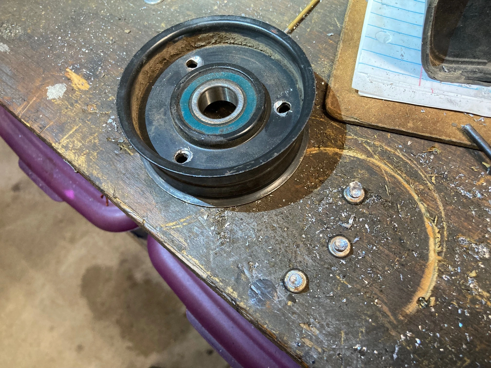

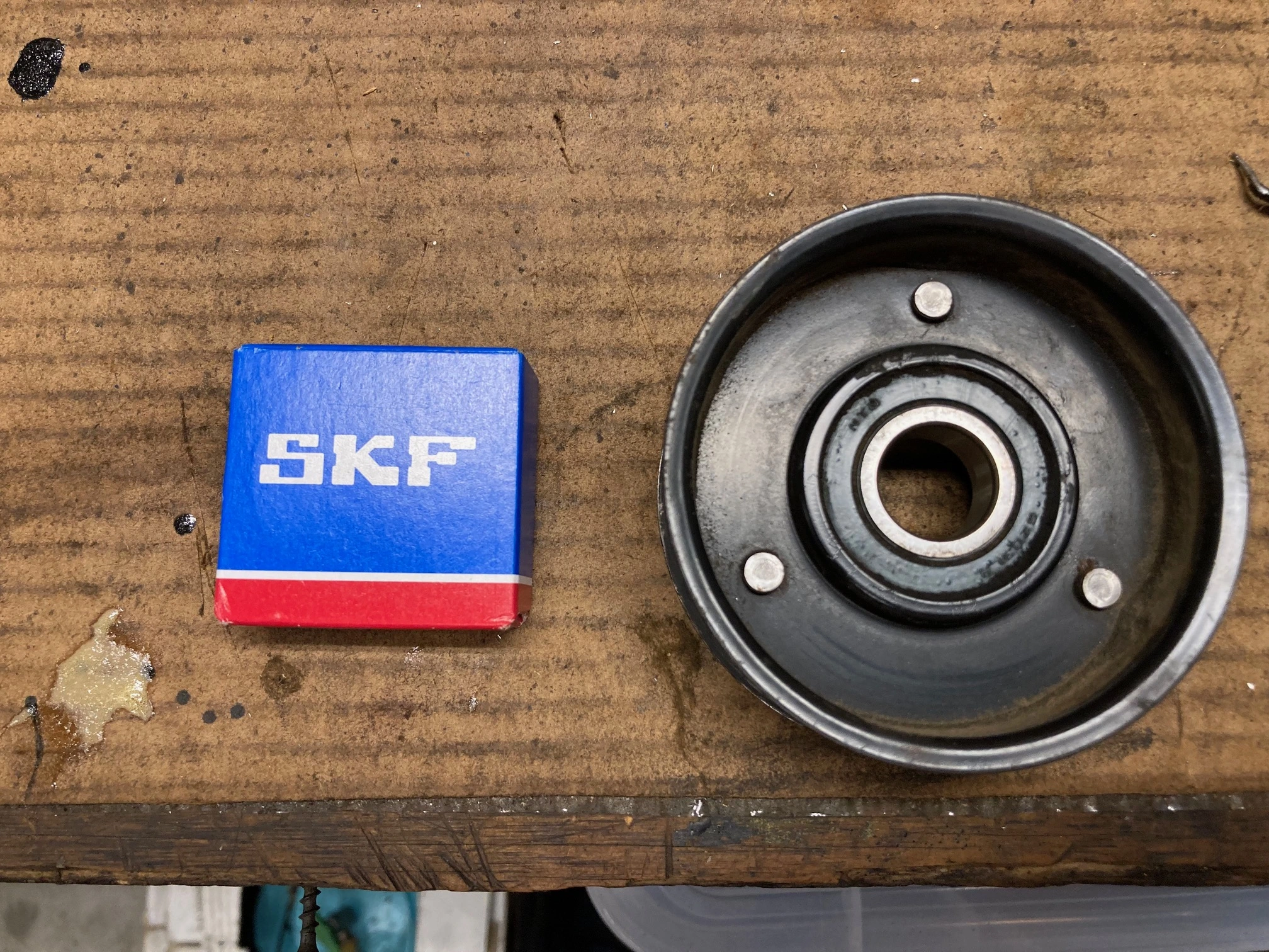

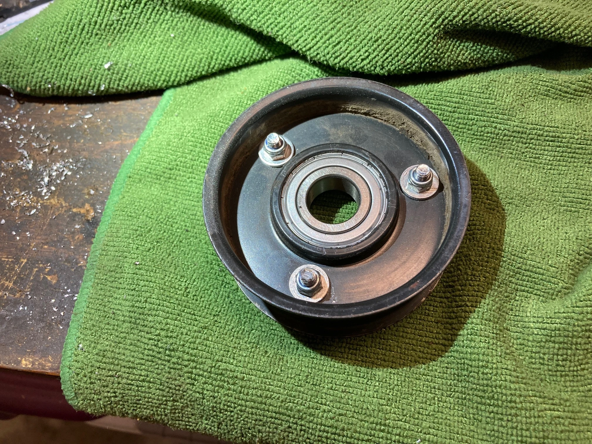

It uses the same bearing that’s in the smog pump delete pulley that I just replaced. They came in a pair from Amazon for $10. SKF made in Italy. Since I already have a bearing I’m going to remove the rivets and replace the bearing. I hit the rivets in the center with a center punch then drilled 1/8" pilot and followed that with a 7/16" to take the head off and drive them out with a punch. I used machine screws with lock nuts to put it back together. Just like Praetorious stated above. All done and back on the car.
