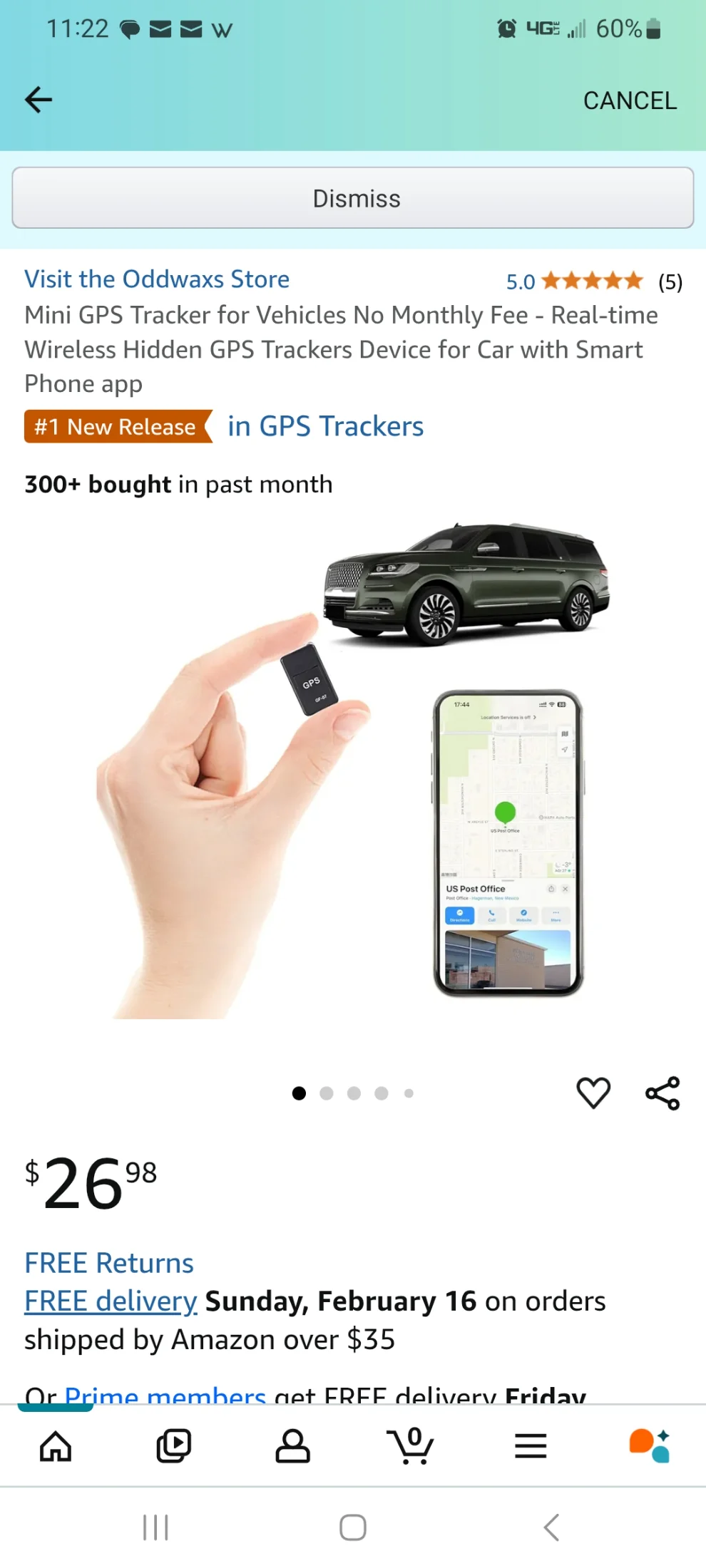

When installing kill switches I like using a relay to carry the load. Switch inside car controls the ground side of the relay. Also, avoids running another hot wire to the switch. I like killing the fuel pump so I can hear someone attemp to crank the car. A GPS tracker is also a good idea...and not an air tag. I like to catch the thief not deter them.
