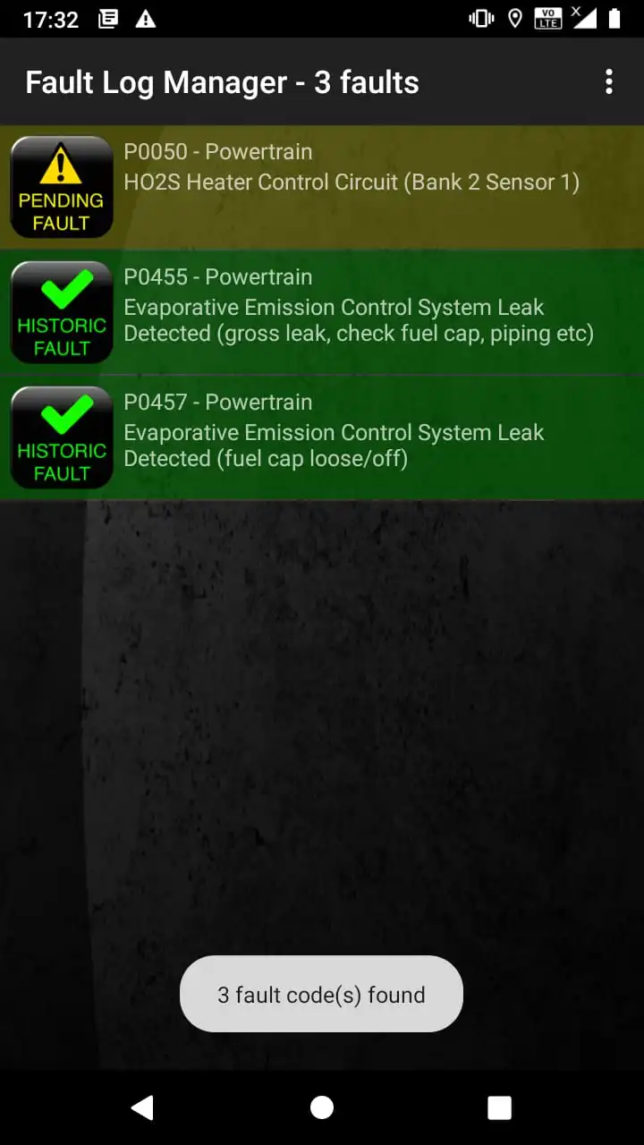

So, I was able to get my hand on the OBD scanner & ran a diagnostic test on the car. For some reason, I was not able to get live readings on the front Bank 1 sensor 1 & Bank 2 sensor 1. Here are the codes I got:

(I used two different apps for scanning, one of them(Torque) only gave me this code and not the above 1-4.)
Also, there were these 2 codes which were shown as "Historic Faults":

Pretty bummed cause I didn't see all of this coming, but where do I go from here?
