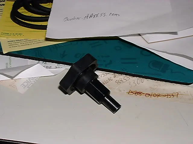

this special TFI you can pick up at any parts store. price is about $5. otherwise you should be able to get a 7/32 deepwell thin wall in there.

Thanks Guys
I got my TFI tool from NAPA. 5.5MM and I think it was $7.00

It's called a TFI wrench.
