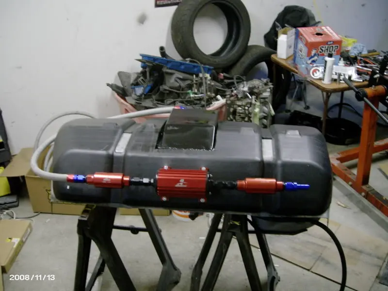

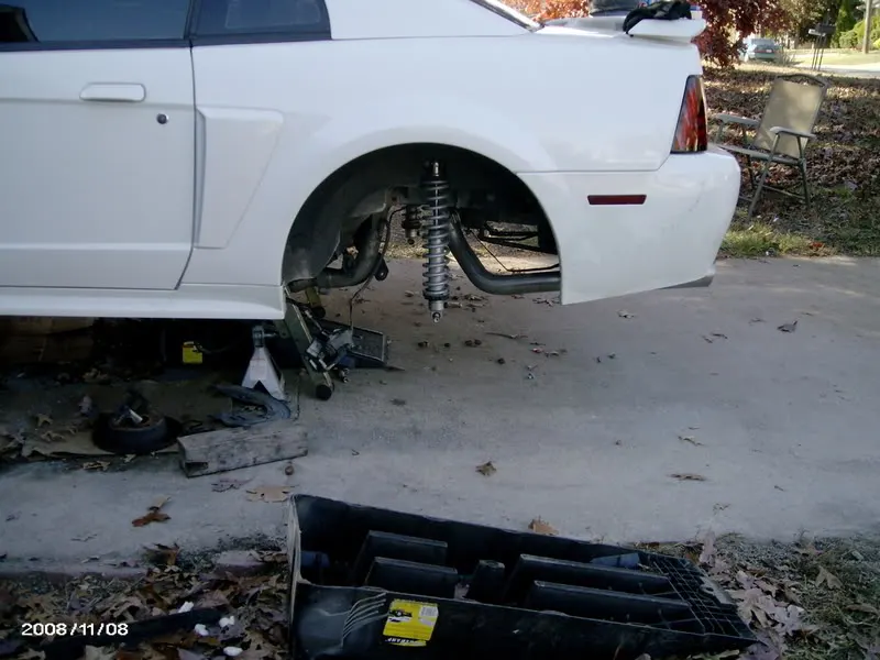

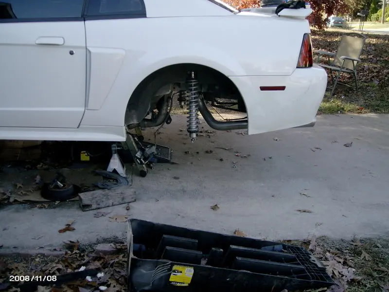

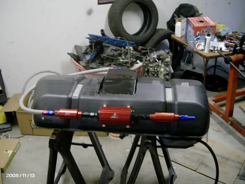

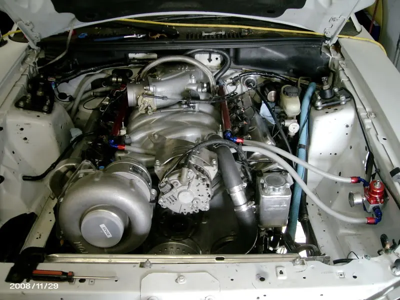

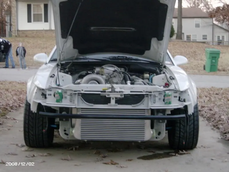

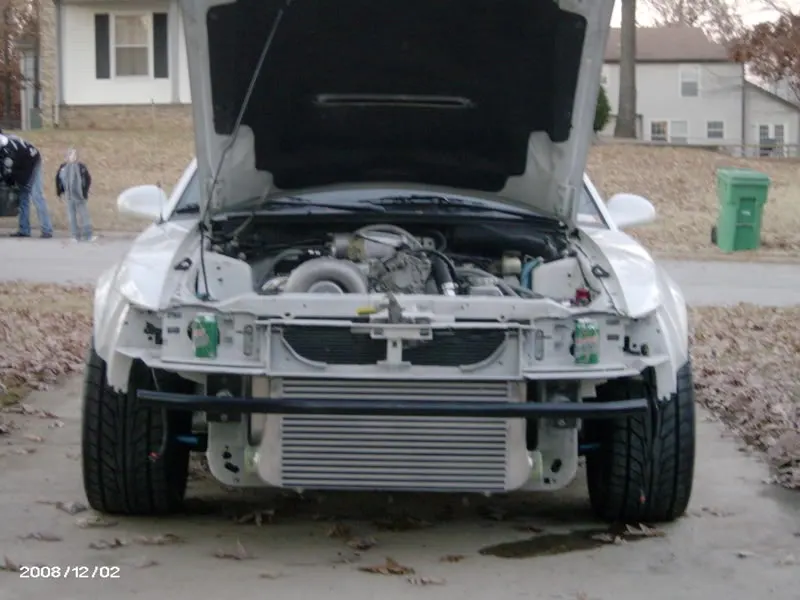

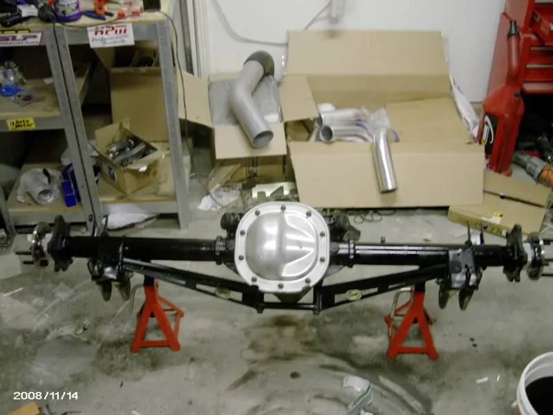

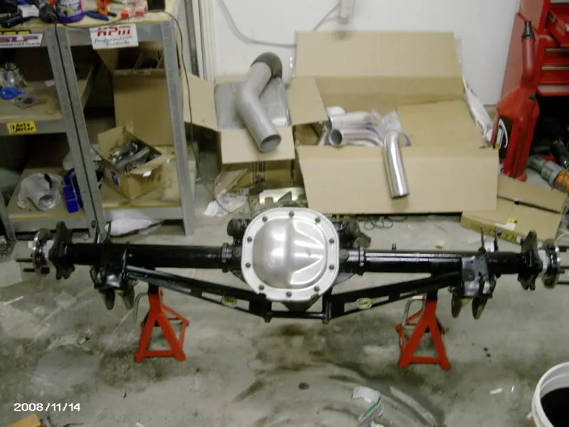

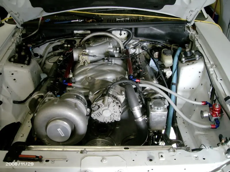

Well I can tell you, I am building my car up to 800rwhp. I should be done in about a week. Everybody above is right. You have to build the entire car to handle 900hp. The engine in my car cost me about $7000 to throw together out of the total $20,000. I really hope you know what your getting yourself into.
Just a few pics so you know what your getting into.
Yeah i know what im getting myself in to. And i know i have to build the entire car to handle the power. 8 Point cage, full subframe connectors, Im buying the UPR front and rear tubular suspension kit, i am welding up all of the seems and little holes that are right by the upper control arms, torque box reinforce kit, I already have a 9" with 33 spline axles and a spool for the rear and the transmission with be either a powerglide, or a C4 from lentech with a 4000 stall.
