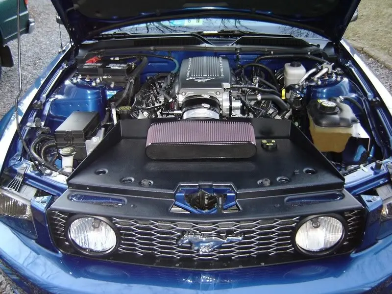

Alright, lets hear everyones opinion on what is the best of the best CAI and TUNE out there.
Some say C&L + Xcal2
some say Steeda + Xcal2
Lets hear it, i think im finnally going to upgrade from stock!

Without a doubt C&L......plus I think that their intake looks better

Demolet w/ Xcal 2, cheaper and more power. Custom painted CAI and SCT for $500. Awsom service and very military(discount) friendly. I would highly reccomend.

After reading MM&FF's CAI article about a year ago (they tested a bunch of them on an S197 GT at the dragstrip - the real world dyno) I became very skeptical of CAI's doing anything other than looking cool. Good read that kept me from throwing away a few hundred bucks on a CAI. The only CAI that added any performance above and beyond the tune by itself was the WMS front-mounted ram air unit. MM&FF showed a real improvement in the 1/4 mile with this one, while all the others showed no improvement. If you have to get a CAI, this should be high on your list.
When I bought my 07 GT, I started looking at the eye-candy that is CAI. The company I bought my DiabloSport Predator tuner from claimed it was good for up to a 27hp increase. They also sold a package that included the C&L CAI and Predator, and claimed it was good for up to a 31hp increase. That tells me that the CAI was worth 4hp. Yikes, that's a lot of money for 4hp. So I passed on the CAI, and bought just the tuner.
Now, for those who choose to get the CAI anyway, you have to tune for it or you'll run lean. I did this on my 03 Mach 1. Bought the C&L TrueFlow inlet tube and big MAF. They were advertising that piece as "no tune required." WRONG! My car slowed at the dragstrip from 13.0's with the stock stuff down to 13.7's with the C&L. The car was so lean it was pinging for most of the track!
Same is true for axle-back systems. They sound cool and some are lighter than the stock mufflers, so that's a plus. However, MM&FF tested them on the S197 GT last year (quite a few of the popular axle-backs), and found most only gave a couple hp, while many lost hp. Most lost torque (need that back pressure to keep torque in check). So, chalk up the axle-backs as "ear candy" and CAI's as "eye candy."
Now, if you have a heavily modified car, then CAI's and exhaust mods will become necessary and will hold real benefits. But, on a mostly stock car, better to leave the factory plumbing intact.

I bought the Demolet w/ SCT tuner. I was also a sceptic. 3 Dyno Runs at the local dyno made me a beleiver. $387 for tuner and another $90 for the CAI, I opted for the custom torch red paint and paid 500 for bothe delivered to the door. Just the 93 tune alone provided an additional 14 hp that is $27. 63 per HP. The CAI provided an additional 12 hp, that was $9.41 per HP. These were done in Savannah GA at 84 degrees and DA of +240. The CAI provides a larger Mass Air Opening than stock, providing a simular result as changing the mass air meter on the fox bodies. All in all I am happy with the results.

If you are going to get a CAI and tune, the best one to get is the WMS CAI and SCT X-Cal 2. http://www.wmsracing.com/wmsweb/05hvi.htm
It is the only one that will *actually* do anything to help your car.

I have a 1996 Ford Thunderbird that has a 5.0L Big-Bore 2V engine in it. I did a lot of research before that engine got built. I run the factory airbox and filter minus the silencer. The engine is a 10.5:1 Compression ratio and using the FRPP Plastic PI intake. The car is making just under 340 RWHP N/A through a fully built 4R70W and IRS. The car doesn't have Long tube headers( none available to fit it ), Under drive pullies, or an electric water pump and the exhaust is not the best setup. All of those things that I don't have will add power to the car. The setup as it is in a 5 Spd Mustang with a solid axle would be around 370 RWHP. MM&FF told me that my car would make more power with a 5.0L Stroker. In reality, my car is making more power than any 5.0L 2V N/A Stroker that I have seen to date, in fact I haven't seen one within 20 RWHP of what my car has.
Now onto this thread. I can see gains in a tuner that is going from a 87 Octane to 91 Octane pump fuel and I can see those gains at being around 15 - 25 RWHP. That doesn't leave much for a CAI to help. Go pop the hood of your car and look at the airbox. At the front you are going to see a little box pointing to the fender. There you will notice a little hole going to the outside of the car. Now let me you ask this.
How is placing a open air filter to draw cold air out of that same little hole that the factory airbox uses is going to help you? Think about it, there is no way in hell it can. The only gains you might see is after the MAF and using an elbow that is straight, not curved like the stock one is. Even there I am not sure there is a gain to be had.
I already know that adding a more efficient air filter will not help. I have seen a 600 RWHP SCed 4.6 2V mustang using the stock air filter. Adding a K&N and keeping all the oil temperatures the same, the car made less than 1 RWHP more than what it did with stock filter and the car saw no reduction in time during a 1/4 mile pass.
You can do things on the dyno and other little things like adding/remove timing to the stock tune to show big gains with a CAI and tuner. Who pays the advertising in the magazines you read. Is it not the companies making the products that they want you to buy that pays the bills? I am pretty sure it is.
I have looked at CAI's for my car and taking a good look and with what I have researched in the past. The only kit that has any hope of working is the WMS.
