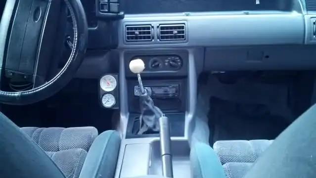

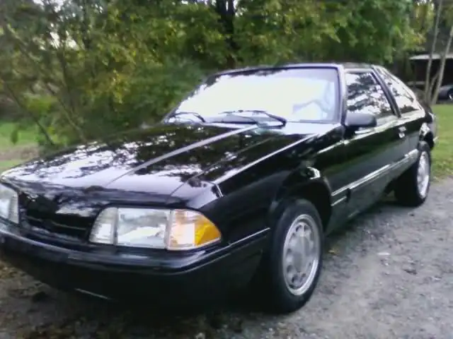

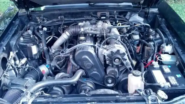

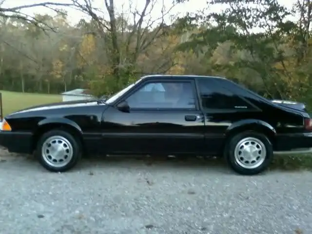

My 93 Mustang with an 86 TC engine/T5. If you have questions, just ask. I never did post any worhtwhile pics. I'll be adding an oil pressure gauge and putting all three gauges under the radio. I used the TC seats, even though they are blue/gray, they are very comfortable. I was able to retain the A/C too! It runs great, finally. Installing a new wastegage acuator tomorrow to correct a "no boost limit" issue. Here are a few, enjoy:nice:

Still sorting out a random rough idle issue, and still haven't installed my new wastegate actuator (not due to laziness, part didn't fit right, chasing down solutions). Other than that I'm very happy with the power it makes.
Immediate plans call for new struts and shocks. I recently added the rear sway bar from my '86 TC donor but haven't had a chance to see how it has improved handling. I'll also be swapping on the quad shocks. When I have the time, I'm going to remove the locking unit from the TC's rear and install it in my diff. to retain 3.73:1 gearing. On the exterior I still need to rebadge it and replace a piece of trim moulding on the driver's fender. It needs new sunroof weatherstripping, door belt moulding and a passenger side window run channel. I also have the dreaded door droop, and the real fix is welding on a new lower hinge since new hinge bushings ain't gettin it.:( I'd also like to install a new windshield since the previous owner apparently used to clean it with 80 grit sandpaper.

I didn't do the actual spraying of the paint, I just did all the prep work. This was the 2nd Mustang I've had painted, I'm getting better at it. The key is to remove as much trim as possible, it makes the final product look so much better. From 10 feet she's a beut, but it does have some orange peel. For what I paid the guy, I'm satisified.

The seats are comfortable as can be. I dont' have the gangsta lean, just the driver's seat creaks. When money permits I'd like to recover them and at that point fix the creak. I'm also trying to figure a way to tastefully mount the 8-way adjustable controls so I can have both seats be powered just as they were in the TC.
Although I do like the Hurst look, I've ordered a new shifter boot, bezel and knob from LRS to make it look factory. The turbo coupe's boot and shift knob looked like poo, so I had the Hurst laying around from a prior stang. I'm a little bit of a melvin, I like things to look like they at least "could" have come that way from the factory.
