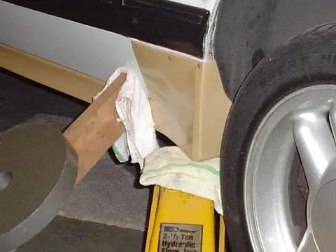

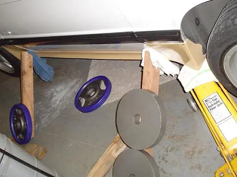

...this is the kind of stuff you have to come up with to get things done.

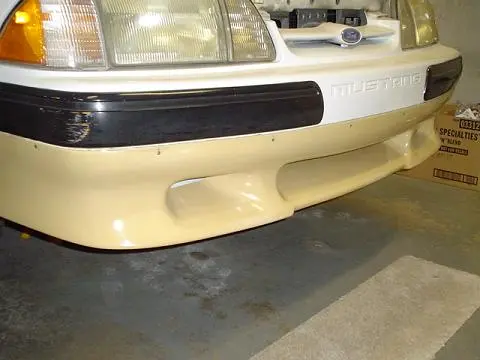

So what are you going to do about all them rivets?
From my understanding you putty them in, or put icing over it and smooth it out just like you would dents. Then use guidecoat to make sure its flush and get it painted! I may be wrong though...:shrug:
DD,
You choose wisely, as you got the 90-93 body kit. Only difference is the front, which it has the slots to provent sagging due to pushing air at higher speedz. The 87-89 kits dont have the slots so higher mileage Saleens really have the sagging front air dam. When was the last time you drove that puppy? We should meet for Java some Saturday morning.:nice:
Well... those rivets are #6 stainless countersunk screws actually, on real saleens they use rivets and leave them exposed, but on mine Ill touch them with a little spot putty and smoothe them out. *I hope* they will wind up almost invisible, when it's all done.
