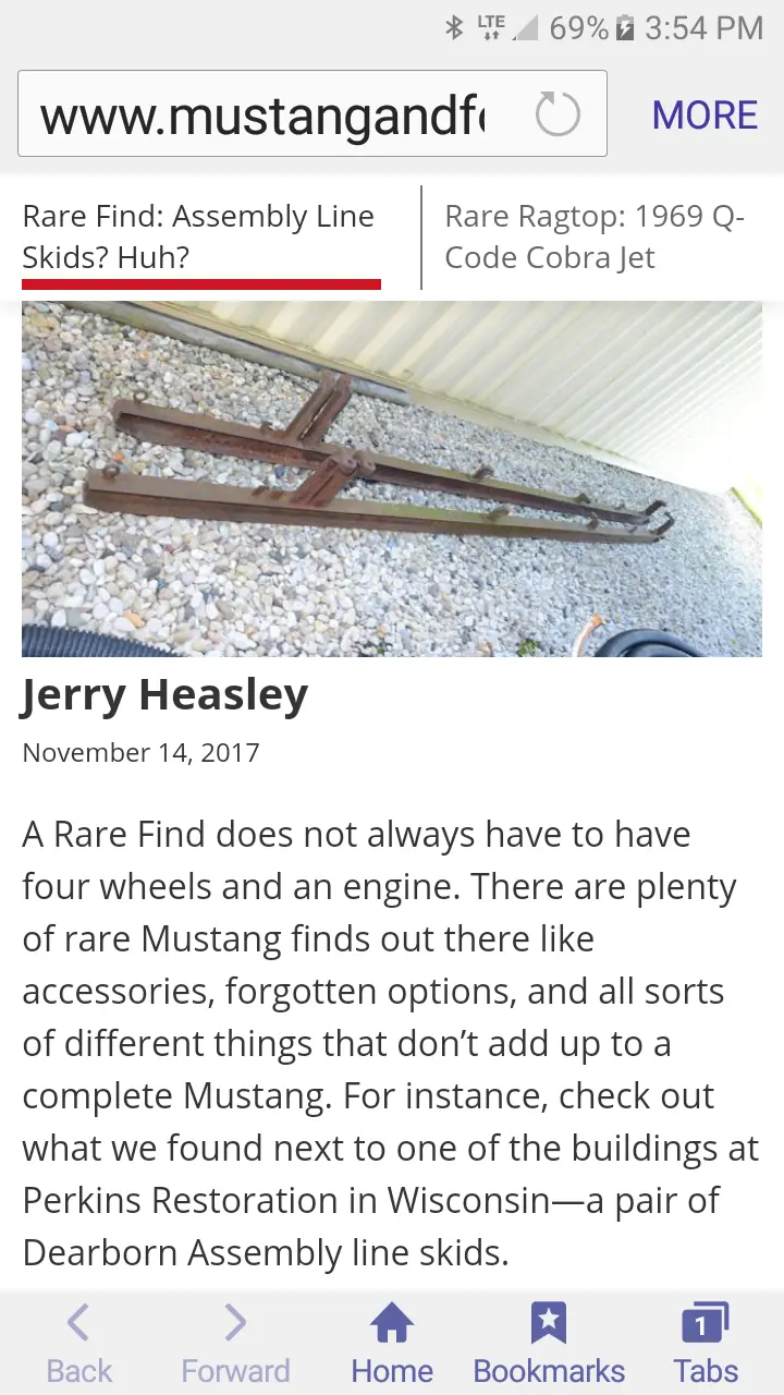

These cars are different from car to car ,i have seen them lean from side to side . A lot of people think they were built on a jig ,but they were actually built on a skid and pretty much hand assembled so measurements can be slightly different from blue prints
Reactions: 2Blue2

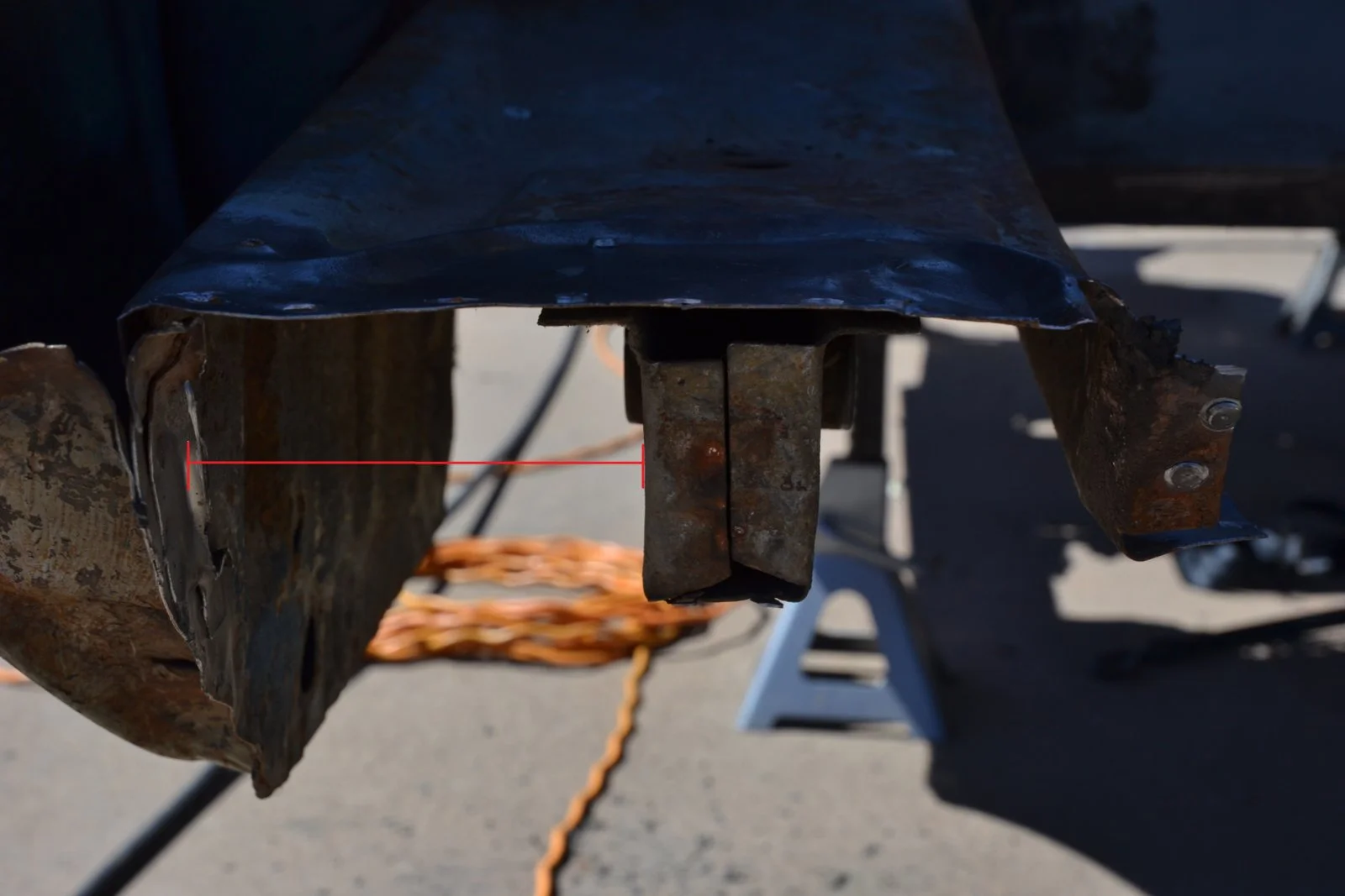

Okay. The driver’s rear frame rail was angled further down than the passenger side. I had to jack that side up ever so slightly to get the whole back end level.
I was just concerned because I remember that frame rail moving when I cut the trunk brace out. Not sure what I’ll tackle after the floor is in, but it’ll probably be either the trunk floor or the fender aprons.

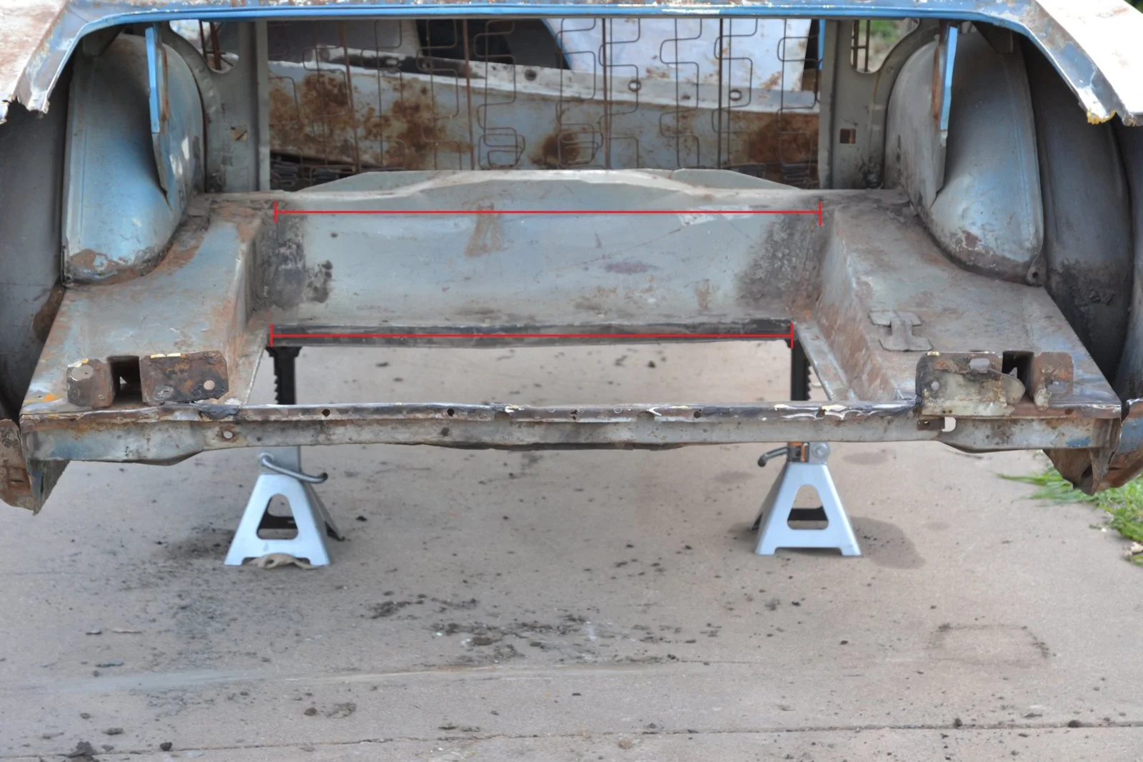

Where should I take my measurements when before I remove the old trunk floors? I’m planning to replace them because of accident damage.
Also, what’s your opinion of Dynacorn trunk lids? My original is bowed from being rear ended along with a ripped out lock similar to the dash. Been trying to find an original but have been unsuccessful.
You need to measure the upper opening and the lower opening where the tank will set ,you also need to measure the side of the trunk drop off to the edge of the frame rail on both sides. The rear floor cross member will go in first and that helps position the trunk floors
So these are the measurements I need?
And weld in the rear support first since it pretty much locates itself?
That seems pretty doable.

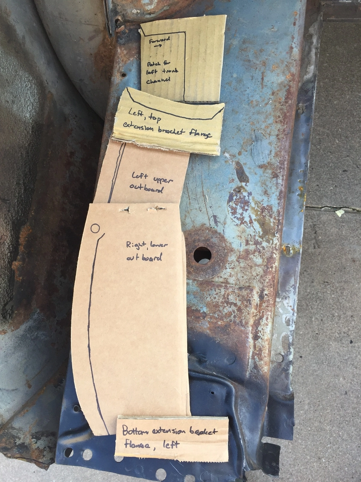

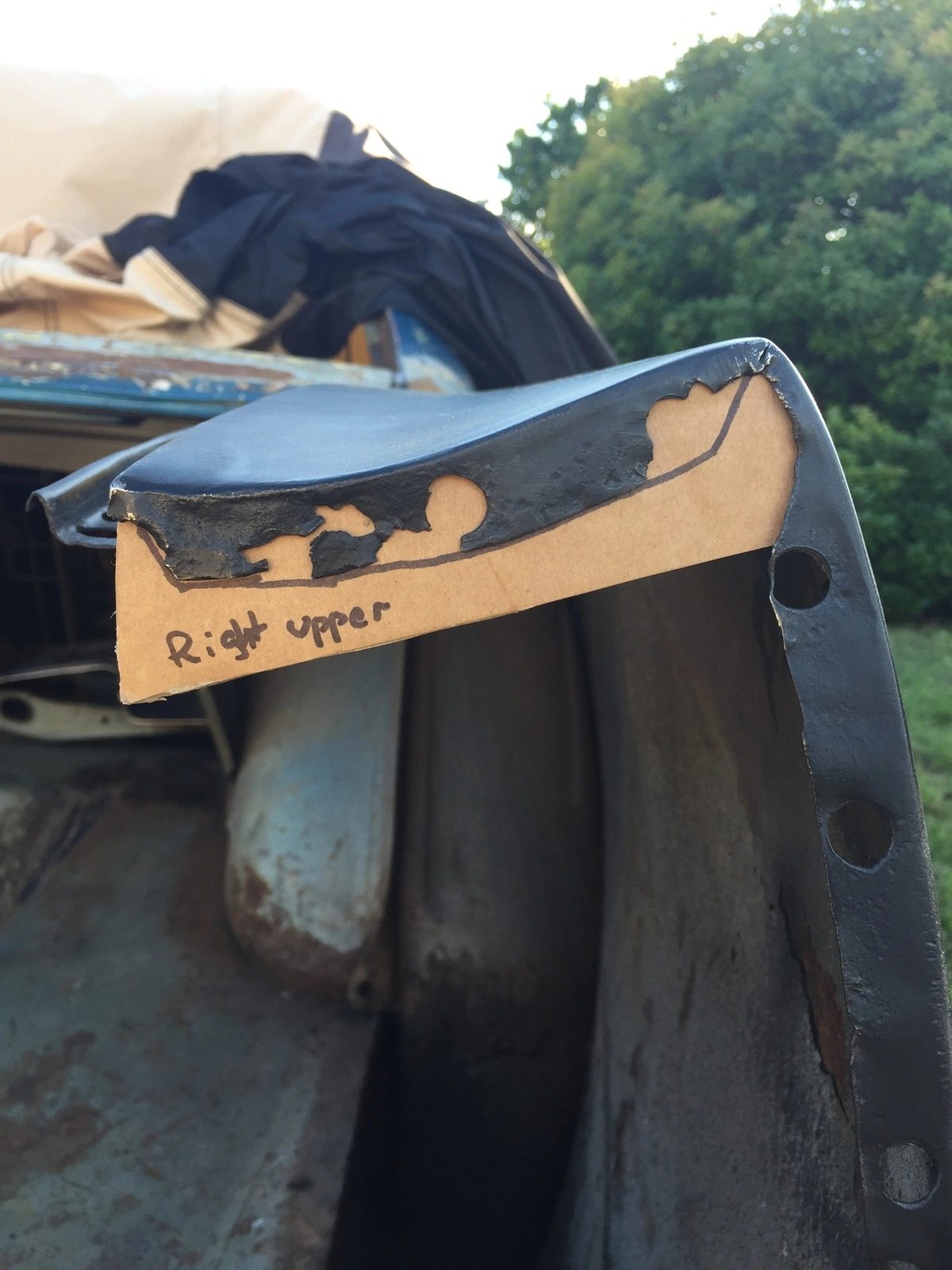

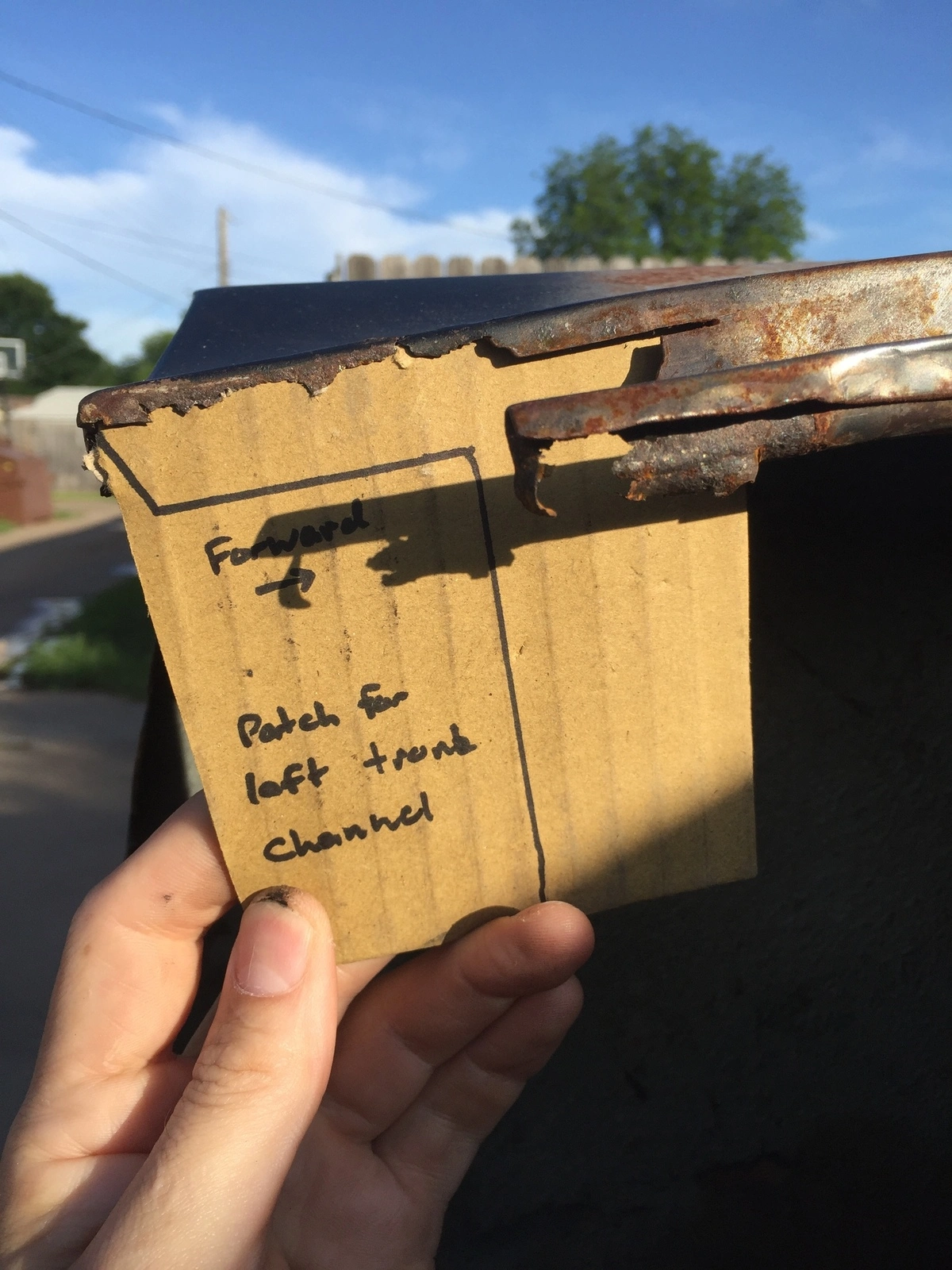

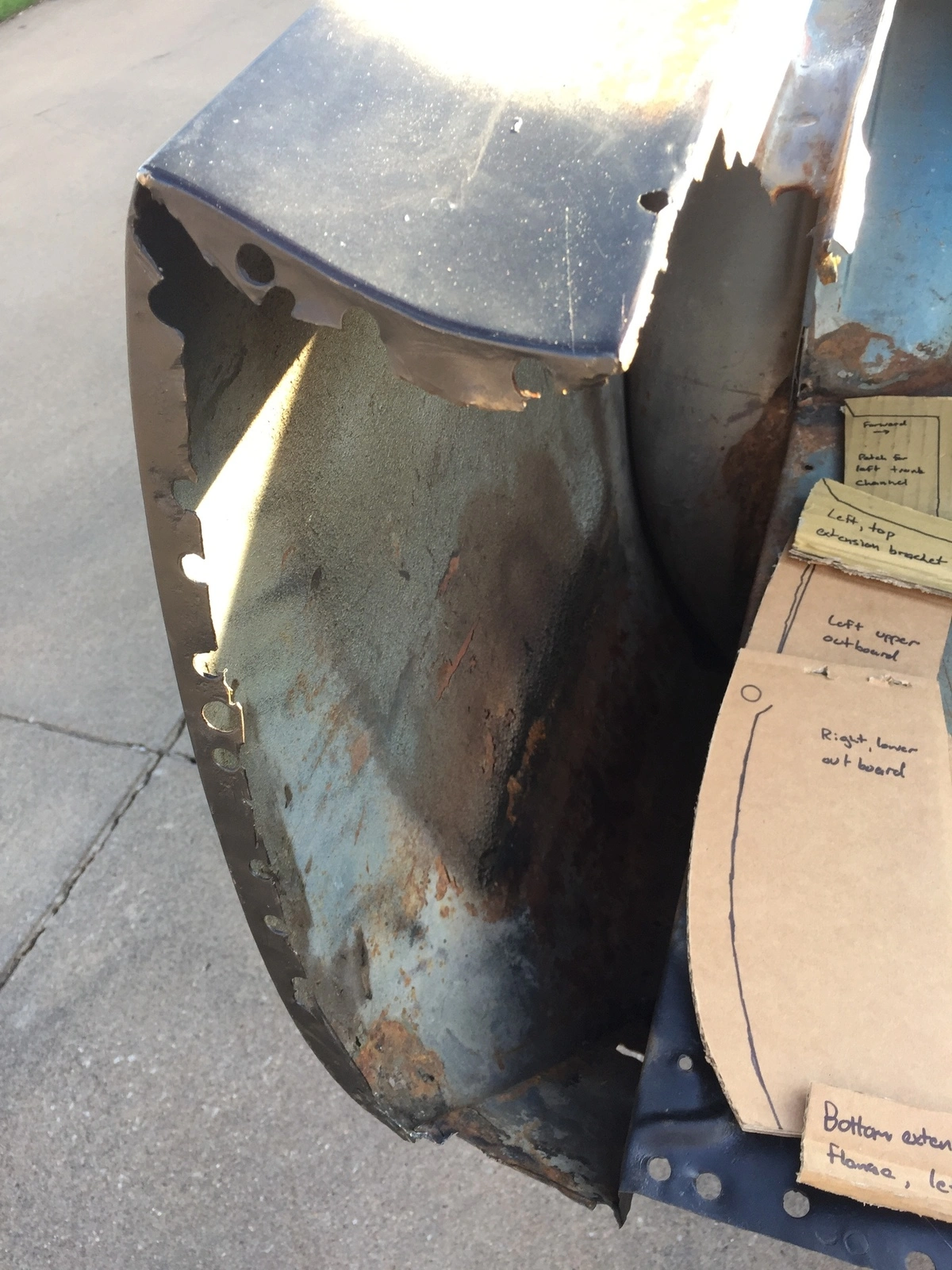

Making some preparations for my next moves on the car. I've decided to see if I can fabricate some new flanges for the quarter extension brackets since I have nothing to lose with these rear quarters. If successful, I'll be able to save the driver's quarter entirely and just get a skin to patch the rusted wheel arch and damaged drop off section on the passenger side.
I made some templates since I have a ton of cardboard sitting in the garage. I didn't bother making templates for the outboard flange on the passenger side since a new skin will come with this flange (I was able to see what a skin looks like on a youtube video). There's plenty of metal left from the toe board patches to work with.

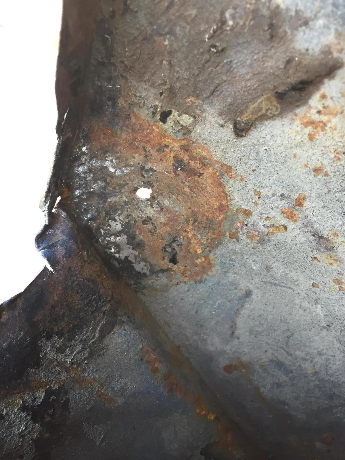

I'll use a small piece to patch up and back fill that rust hole on the top of the quarter.

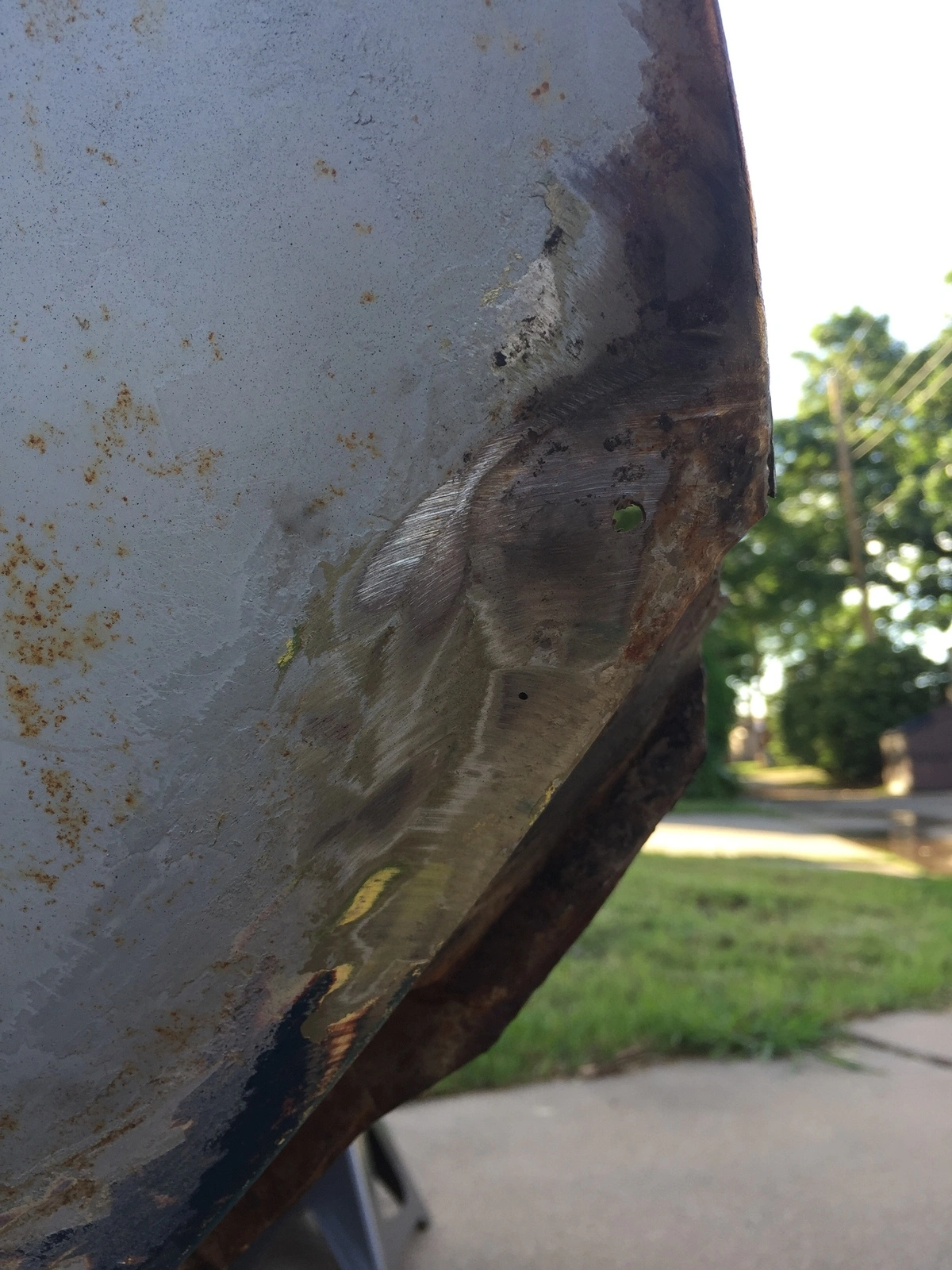

I also did some more hammering on the dent at the bottom of the driver's quarter. I'll probably be able to save that area and smooth it with some filler. I'll use the copper trick to fill the hole.
If it doesn't work, no big deal. If it does, then I save myself some money and increase my fab skills. :shrug:
