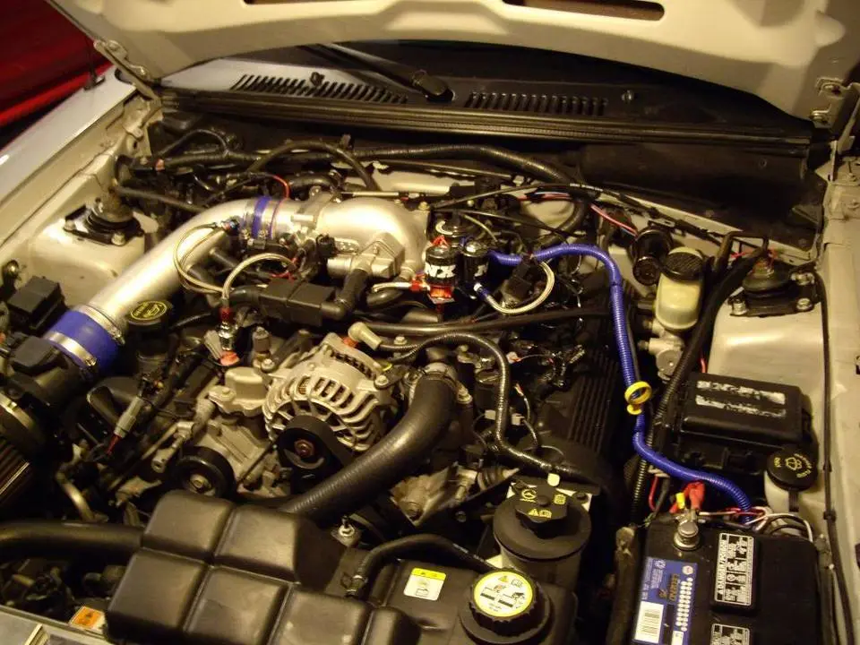

So my buddy was tired of not being able to hang with the Cobra so he came by so I could install his NX wet kit. Never installed one before and he still has to fill the bottle tomorrow to play with it but no fuel leaks or anything. He still needs his NO2 pressure gauge but here are some pics of what I installed :nice:

Nice mountain of JB Weld on the intake, lol.
Nice shag carpet on the leg too...;)
In all seriousness, looks like a good install. I bet he will have a smile painted on his face once he feels the hit.
