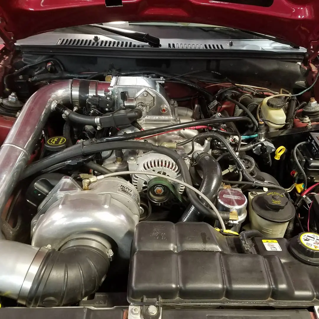

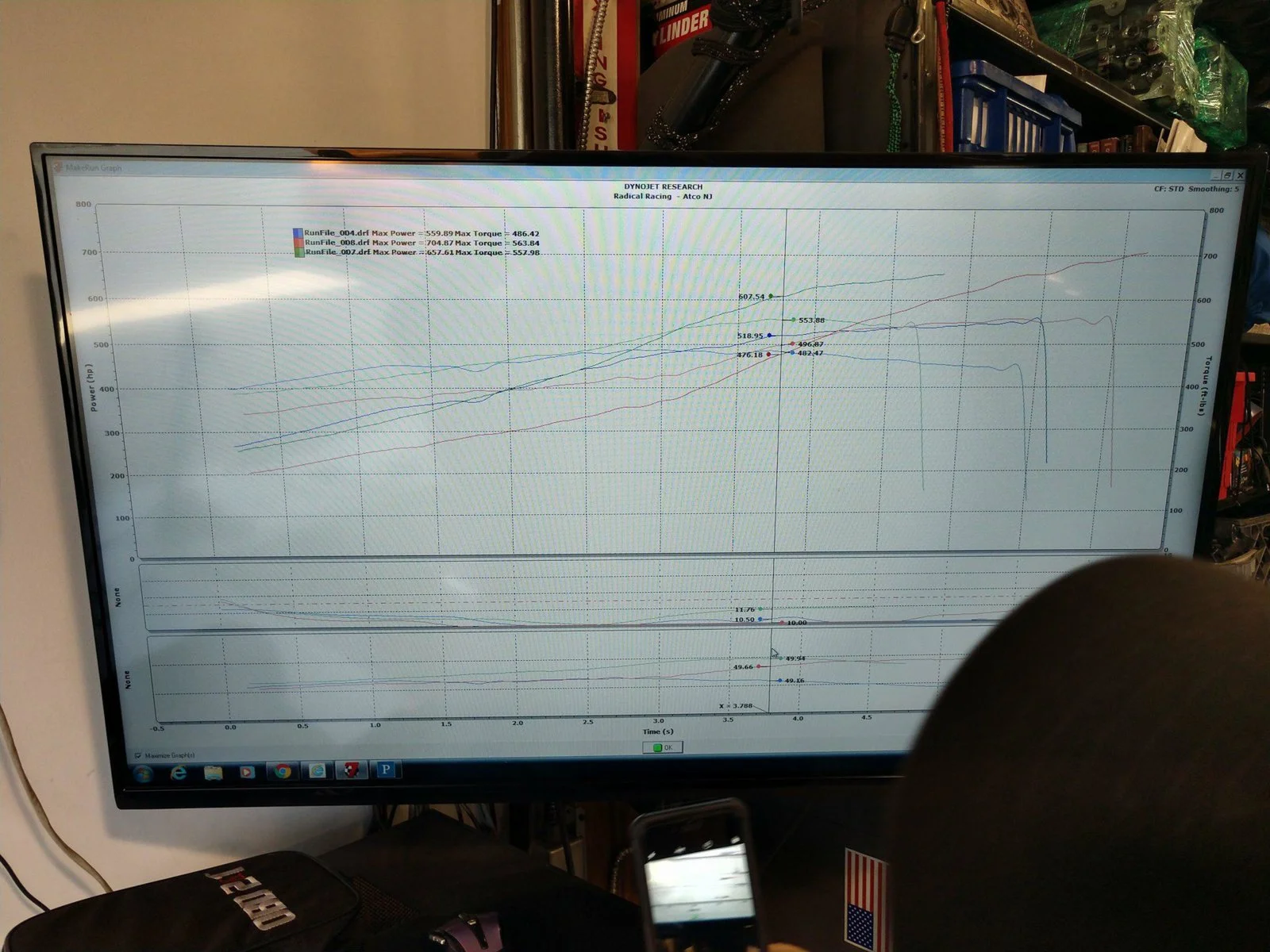

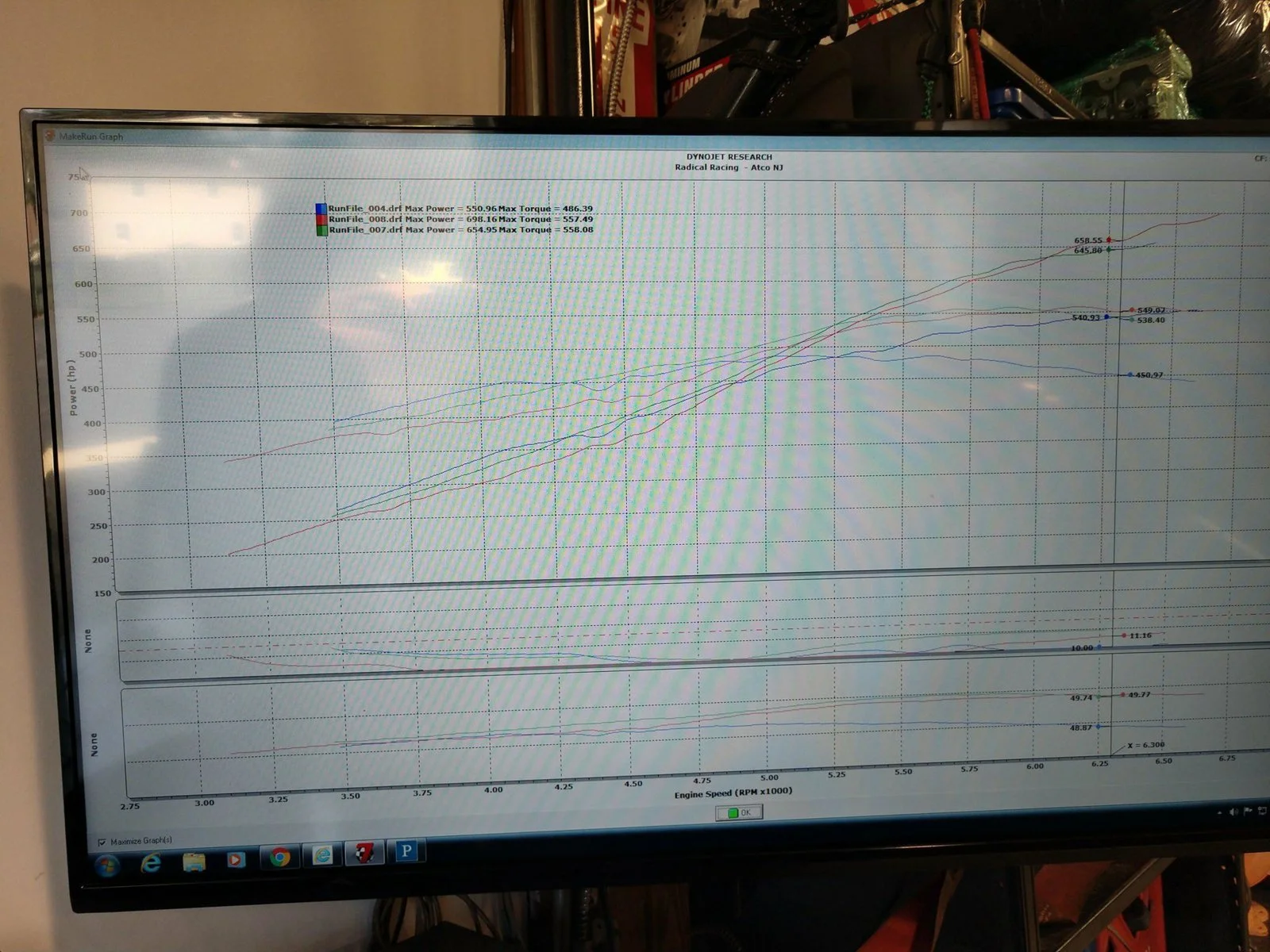

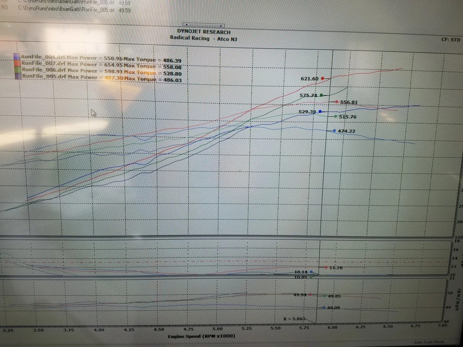

Tried to post some videos but files too large. Anyway, our little 2v made 704rwhp and still pulling. The novi2000 is maxed out and im over spinning it at 6600 rpm. As you can see the 704 hp run lost a ton of low end becausr i was spraying too much meth. So we detuned it for now to the 660rwhp 550rwtq tune. If i change the nossle set up it will allow us to not be as rich and we will add timing getting back to 700 and not lose down low. The new mods were meth, cams, intake, and tb. The 560 hp run was the base so we made 100 rwhp and 70rwtq with the new mods.

That is a great looking dyno curve. Congrats on the new numbers!
You are probably under 3200lbs and with those numbers - should make some great times at the track!
Yes! Have to keep my baby up with all these new cars! Not going to lie....it took a ton of money over the years. And the 2 valve is just about tapped out. I think we migjt be able to hit 720 to the wheels but thats about it. Event the built motor internals cant hand much more then that anyway. But im good for now. Car is scary when floored in 3rd and 4th!!!!
