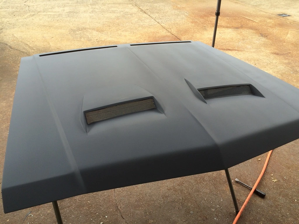

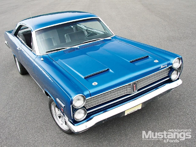

Option A.: 67 style
The theme here harkens back to the 67 Cyclone hood
I can leave the scoops sitting on top of the hood, or I can make the hood recess at the mouth like the factory did. This is what I did on the first version.
*The difference between the two hoods here is that the 67 hood is one big assed flat span of sheet metal, and the Monsters hood has a crown, and body lines that compete/conflict with those long pieces of rectangular steel. When looking at the car from the front, the scoops "lean" as a result of the crown.
The amount of work required to fully integrate these scoops since they're actually built, we'll say is a 7 out of 10.
The scoop would be tacked onto the hood at 2" intervals, and then integrated into the hood so as to blend into the hood w/ no visable parting line. To avoid any sheetmetal underneath not getting painted because of that, I'll add a block underneath the scoop to "close in" the scoop, effectively sealing the underside.

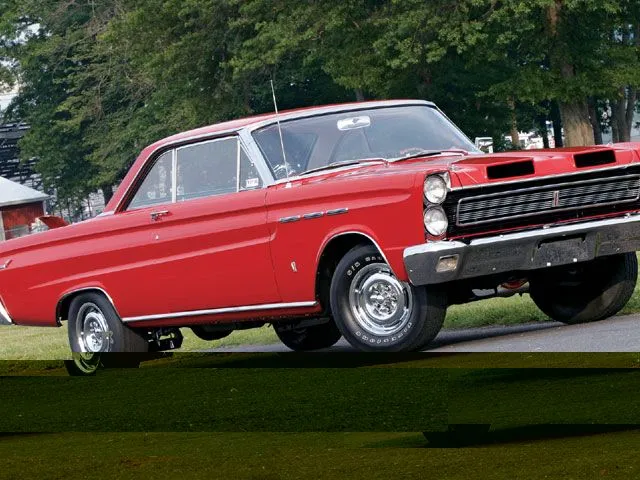

B: 65 Cyclone style:
-2f-2fwww-chooseyouritem-com-2fclassics-2fphotos-2f93000-2f93449-1965-mercury-cyclone-jpg.559...webp
Nothing built so far to accommodate this style but in reality, its pair of rectangular boxes welded on front of the hood. The real hard part is it actually doesn't stop there. When you look at this hood, the top part of those scoops extend back about 2' and stand off of the rest of the sheet metal about 1/2" This would require a really long 12" wide piece of non-stressed sheet metal be folded at 90 degrees, and welded into the hood structure.
Just like the first example, I'd probably just tack it, then add filler to the seam, and integrate the thing into the sheet metal as a whole.
What happens when I weld on the hood boys and girls?
I give this version a 10 out of 10 because it has to be completely scratch built, and because there is so much trailing sheet metal behind the opening.
Then we have option C:
2016 MikeClone
I could probably cut the two scoops off the old version completely intact, and integrate them into the new hood w/ ............little difficulty?:shrug:. Maybe the easiest of the conversions,.....I'm thinking 5-10?

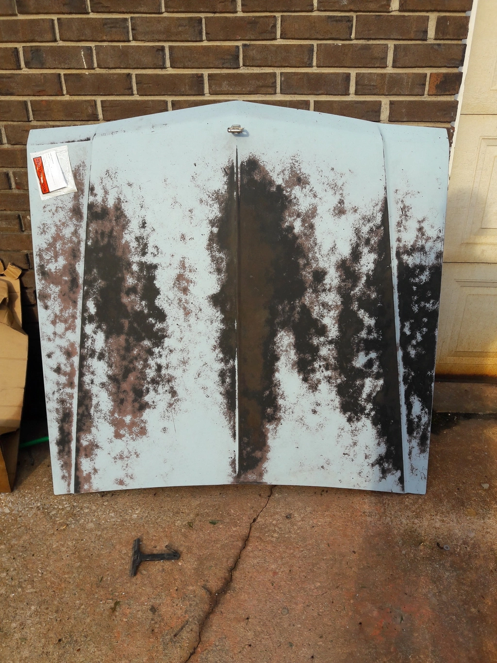

Ok,...Nothing accomplished today with the exception of this grab.
It's ugly for sure, but that center rib is unscathed. There is a small dent in the skin on the passenger side, but nothing a light coat of filler wont fix. The bottom of the thing is similar to what you'd expect to find after the Deep water Horizon blew up and and vented a bazillion barrels of crude oil into the gulf coast. Whatever engine was in this car slung oil all over the bottom side of the thing.

Yeah,...I do believe that I'll have to plug that hole too.
I like the G vents, and as mentioned above, don't think that they are too time consuming to add back. The G Nostrils,......that's a different story... They're going back,...I just hope I can make it happen w/ minimal collateral damage.
