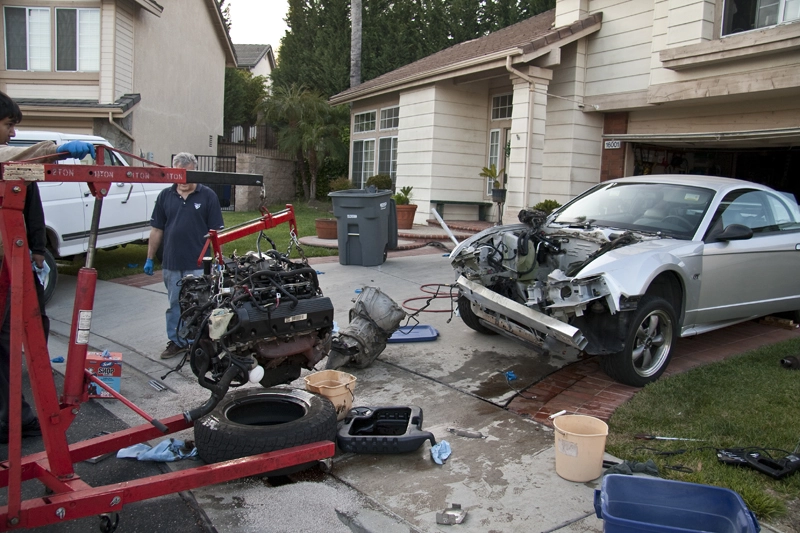

Drain the trans.... TRUST ME. See all the mess in the pic below? Thats all because I didnt drain the trans and GALLONS of trans fluid dumped everywhere. It was like a river flowing so hard there was no way to stop it.
