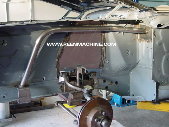

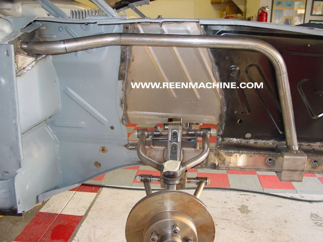

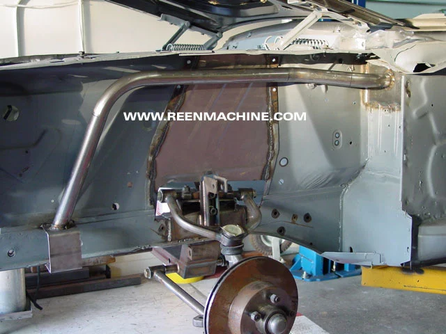

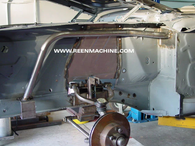

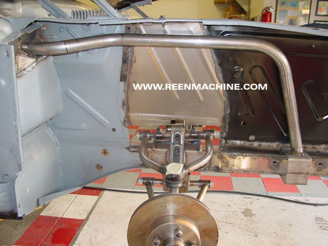

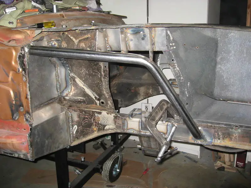

So here's how I did the front frame reinforcement. The bumper brackets fit through the square section in the front, which is a bit oversized in order to fit my rotisserie. I plan on gusseting that part up a bit for stiffness once the rotisserie work is done. The upper firewall area is reinforced with 1/8" steel.
i guess that works as well, i'd still rather see them connect directly to the frame rail but with gussetting it should be fine.

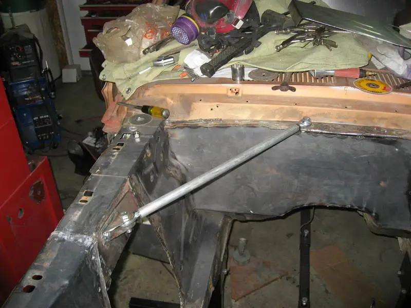

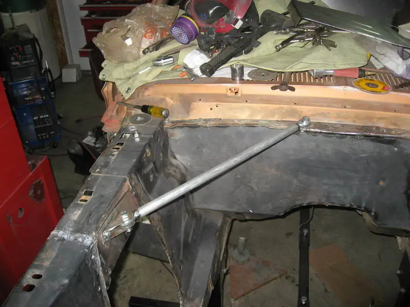

My approach to the same issue. Like Reen I wanted the braces under the fenders mostly due to the 4.6 DOHC going in there. It also keeps the engine bay uncluttered. I also like the idea of attaching the brace to the area where the cowl, cowl side and firewall meet. This is a very strong point in the unibody.
The brace is contructed from 1-5/8" 10ga. structural tubing. The sheet metal is 12ga. The brace is anchored at the top with a 12 ga. bracket and at the bottom with an 1/8" angle. The purpose of the sheet metal structure is to provide a mounting point for an export brace style diagonal. The diagonal connects to the cowl where I have added a 12ga. angle for reinforcement.
I assembled the front suspension and mounted a 245/45/17 tire on a 17x8 rim with 4.75" backspacing. I left out the spring so I could move the tire through it's full range of motion, up and down as well as lock to lock. The brace was designed around this so that there would be no interference.
Once I get back to my torsional testing I'll post the results in my thread.

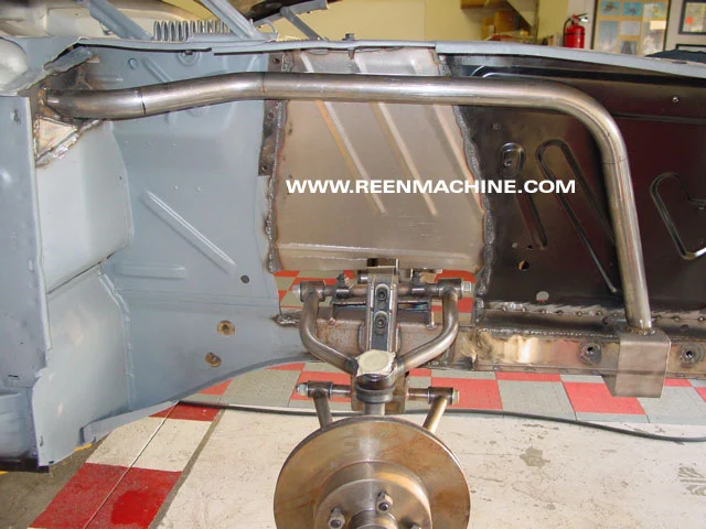

Reen, have you mocked up your tire/Wheel on that set up? If so, did you have any clearance problems? Looks kinda tight up front. Also we've been having our inner panels cut locally with an extra square tab on top & bent down in order to remove all of the original shock tower. It also enables us to resale the original shock towers if they're still useable.
I did indeed mock it all up just for that reason, and there are a couple of inches to spare.
I don't quite follow what you mean about the inner panels. Have a pic?
I was talking about the filler panels. Normally we cut thru the upper corner just above the shock mount and weld that to the new filler panel. With this new filler panel ,with the bend, the entire shock tower panel is removed and a cleaner bent panel welded in place of it. I'll try to post some pics on my web site & here. WWW.Mustangmaker.com
I totally understand what you're talking about now. That'll make for a cleaner installation.
