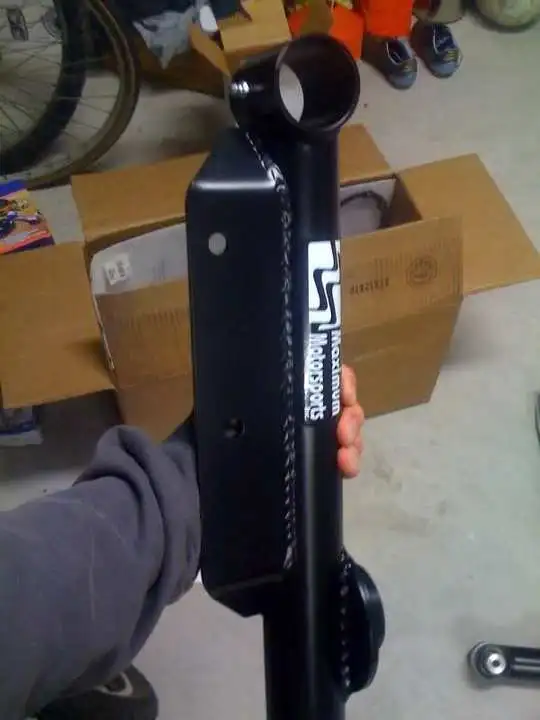

The uppers, beautiful simplicity...

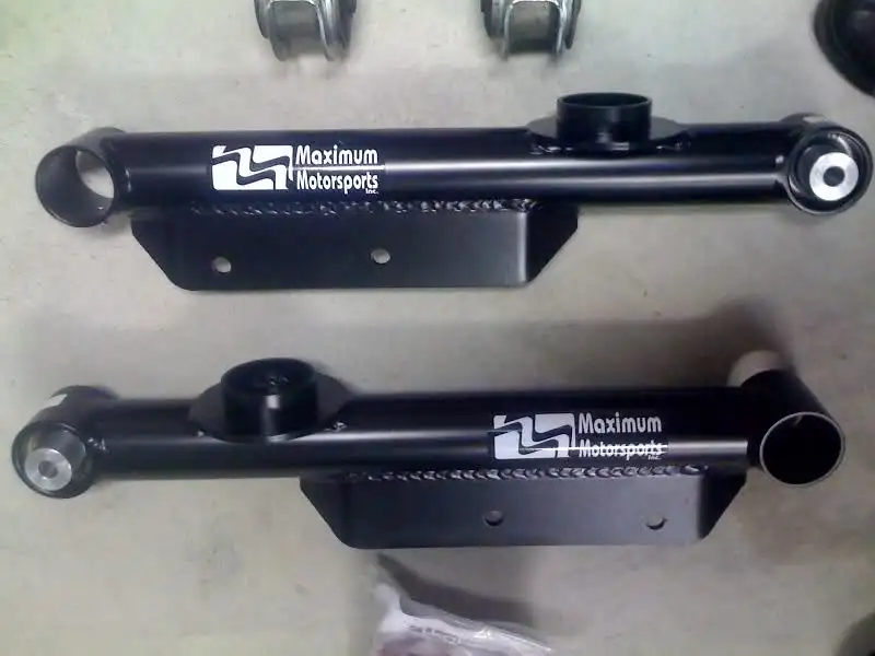

The lowers... O.O blew me away seeing these in person! Spectacular items!
Quality you can feel.
Here it is... a quality set!

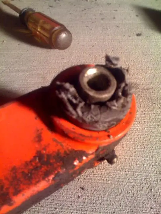

I got a chance to work on the car for a bit today. Here's the broken upper. It's stamped "12-28-86" damn it's old!

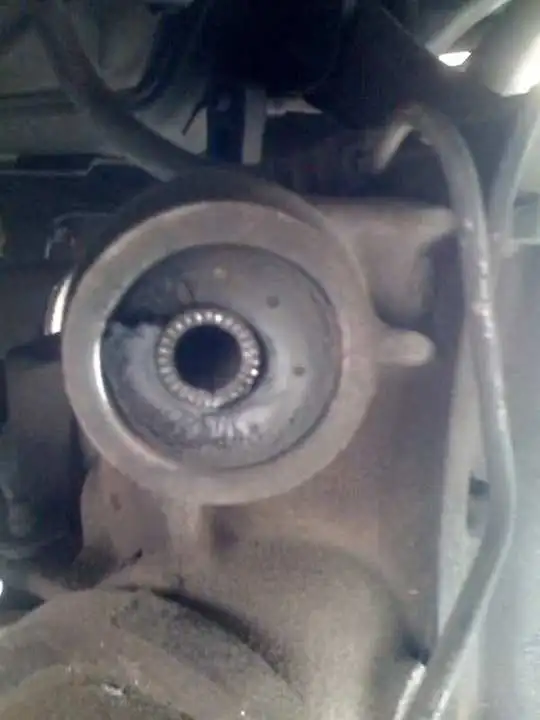

I was hoping not to have to replace the axle housing bushings, but I'm gonna have to after all. They're pretty banged up.

Yeah I couldn't get the ****ing axle housing bushings out so I went ahead and ordered the tool from MM after all :nonono: The good news is I moved on to the lowers and I removed one control arm. The other...is going to be a bitch unless I move the exhaust...MORE WORK DAMNIT!!! Maaaaaaann, the bushings on those were so bad, I really feel like an idiot for not noticing them right away!The bushings literally came apart in a few pieces when the control arm came out.

You have to drill them out, basically completely destroying them to remove them. I don't know how the tool works, but a 3/8" drill bit did the trick for me. :D

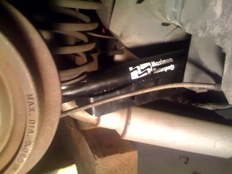

The lower control arms are in! It was pretty tough getting everything aligned, and pretty much every bolt was a battle! I had to drop both exhaust pipes to get access to the bolts on the frame end. But here they are, in place and ready to roll...but the rest of the car isn't yet.
Well it's definitely an improvement from what I had before. Check out these bushings... they're atrocious! One one side it was riding on just the bolt!
I'm just waiting for my bushing removal tool from MM to arrive, scheduled for tomorrow, and I'll put in the UCAs. If not, I may start on my ebrake lines.
the tool for the upper bushings works great...i have one myself..used it once and now its sits in the toolbox till who knows when but there impossible without the tool..just make sure u push in the new ones in the same as the old measure it so everything lines up again
Does the tool work for pushing out bushings in places other than the axle?
