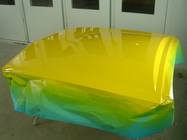

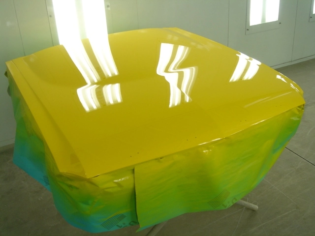

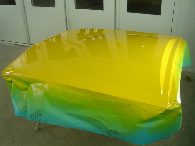

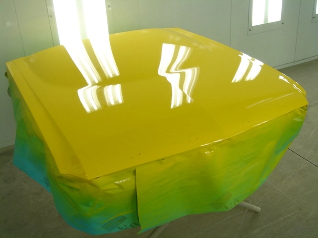

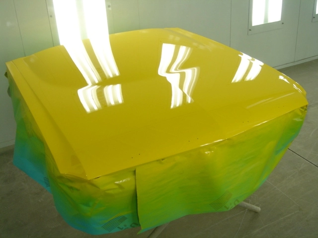

I walked into the shop this morning just like any other day. Still half asleep, a freshly brewed cup of coffee in hand, I worked my way through the dim shop and started turning on the lights. As the shop started to brighten up (it takes a few minutes for the lights to kick in), I noticed that the Hood, doors and trunk lid were missing!!! I walked around the shop looking to see if they were perhaps moved from their normal resting place, but I did not see them anywhere. Where the heck were they? Wayne said that he was going to paint them today, so I looked in the booth to see if he had moved them in there. Maybe he finished all the wet sanding and put them in the booth so that they could get painted first thing.
When I turned on the booth lights and walked inside I almost cried. Before my eyes was one of the most spectacular sites I had ever beheld. Wayne worked late last night and started laying color. If a picture paints a thousand words, these speak volumes. So, instead of me going on, and on, and on, and on, I will let the images speak for themselves.
One parting comment... Just look at the reflections.
As always, more images are available at our site.
Catch ya'll l8r

mmm shiny. Can't wait to see it together! One comment I will make though, and I don't know if it's because it's in a spray booth or whether it's just the colour, but it is very hard to see the lump on the hood - was it your aim to be really subtle with it?
Hi 666,
The hood bulge is supposes to be a bit on the subtle side, but I believe that it will be a little more prominent once it is mounted on the car.
As far as "shiny" goes, wait till it is finnished. Wayne is going to wet sand it to remove the orange peal and then spray a thin final coat of clear. The car will then be buffed. Wayne wants to follow this procedure to create the same type of finish you see on only the very best production vehicals.

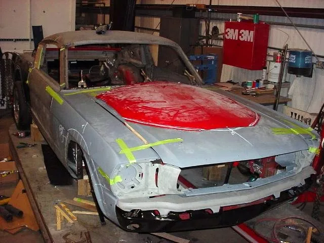

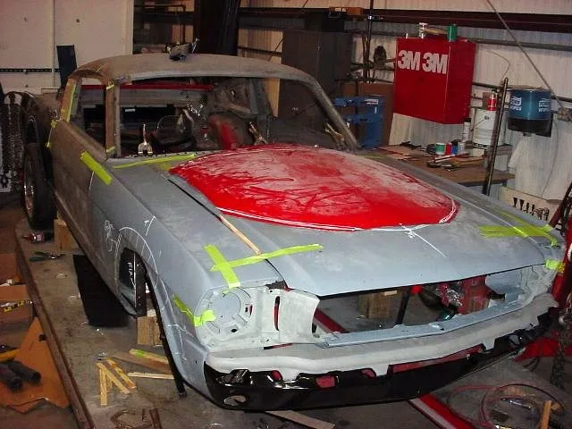

Hi All,
I just did a little search and found the first mock up we did of the hood.
After looking at the early photo, it is hard to believe that it looks as good as it does today.
Anyway... Back to work. :-)
