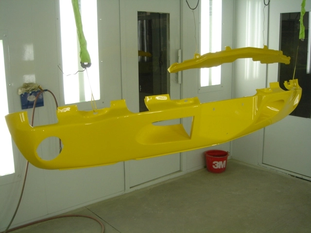

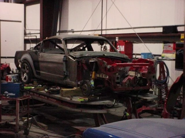

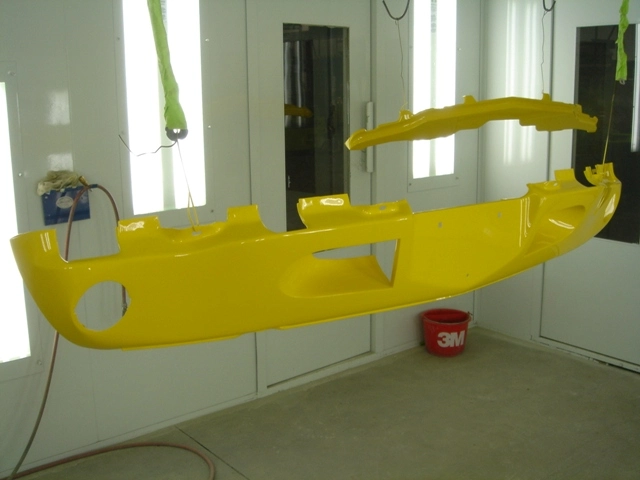

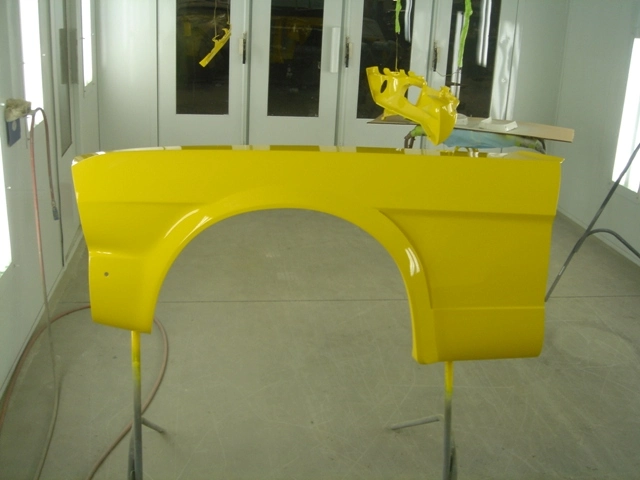

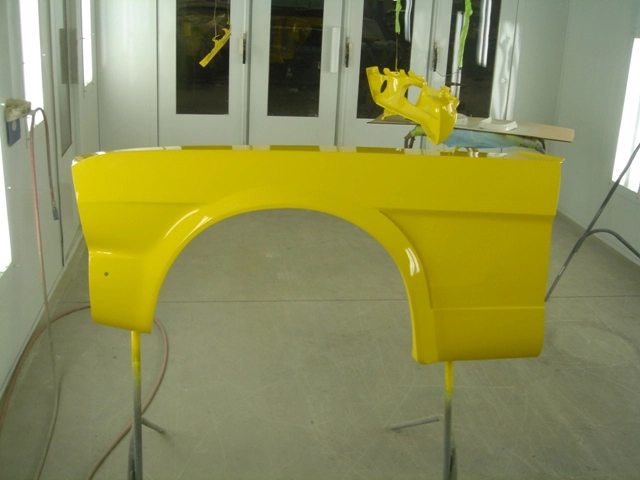

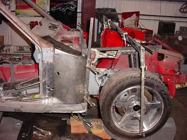

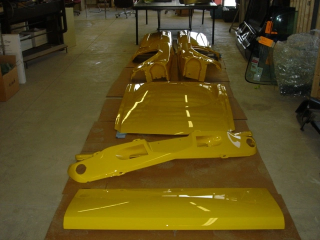

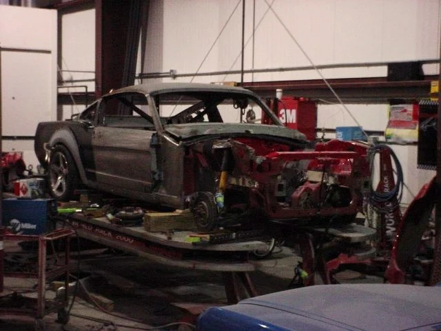

Hi All,
One more step toward completion.
Wayne got the fenders painted last night, as well as the front upper and lower valance and some miscellaneous parts.
I, on the other hand, got little done other than sanding a few small parts getting them ready for paint.
I thought that now would be a good time to look back into the past and see just where we were one year ago. Here are a few photos of the project from last Nov.
We have come quite far over the past 12 months. I look forward to the day that we can drive this car whenever the mood strikes us. Hopefully, it will be sooner than next Nov. :-)
Catch ya'll l8r

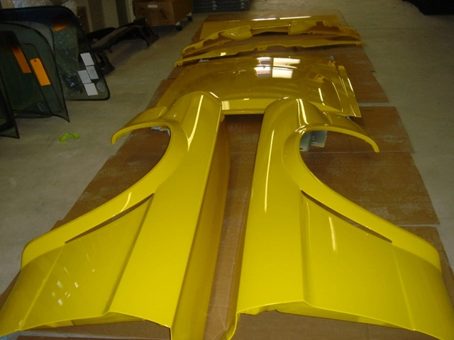

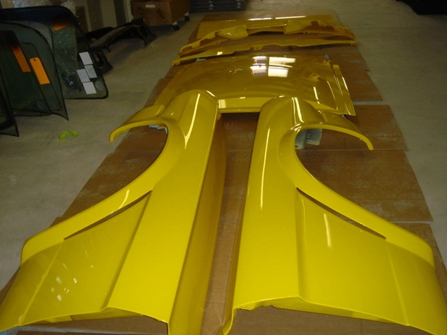

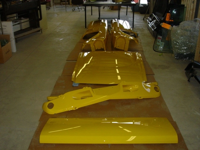

Hi All,

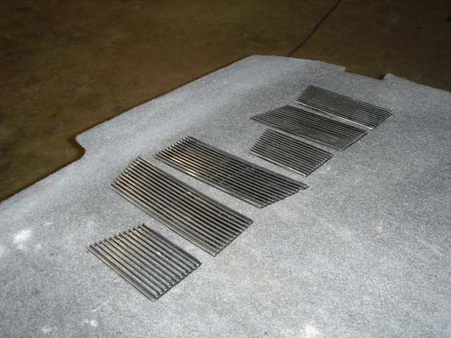

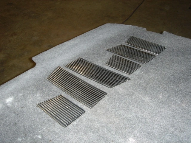

Haven't had much to post lately. The detail work is just eating up so much time. I spent ALL day Friday detailing the interior "C" pillar vent grills. I sanded all the corrosion from the surfaces. You know what I mean right? All that pitting that develops over the years. Sanding in between all those vents is a royal pain in the butt. All that work, just to get them ready for paint.
What we are going to do is paint them the dark charcoal color and then wet sand the fronts to expose the chrome after which we will clear coat the pieces. They should look pretty good at that point. The chrome front surfaces of the grills are now an interesting blend of chrome and brass which will look great with the current color combinations.

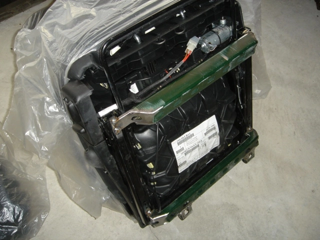

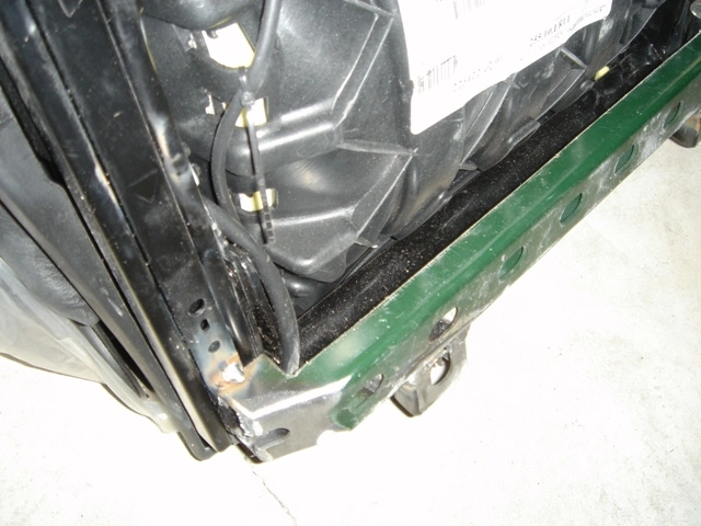

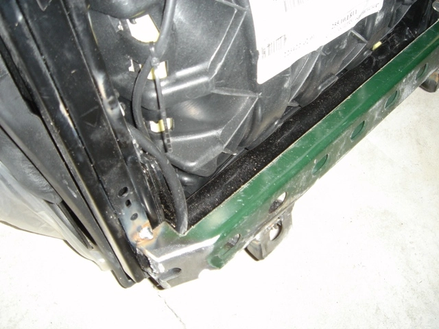

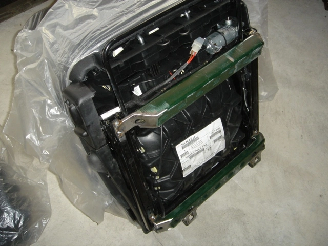

On Saturday, I worked up the seat brackets. These were much more involved than I had originally thought they were going to be. The seat tracks were much wider than the ford mounting locations. Also, the factory mounting locations are recessed into the floor about 2". To resolve these issues, I searched through the cash of stock Hydro-Flo material and decided to use two pieces of 2" x 2" unistrut. I had to taper and box the ends to clear the contours of the floor. I also had to remove about an inch of material fron the top of the rear mount to clear the seat when it is in the full down position.
Even though I was spending my spare time working on inane details, Wayne actually got the raw end of the deal. In between working on customer cars, he would continue sanding on the body getting it just right before rolling it into the paint booth. He will be wiping all the surfaces down reviewing the work today. He is being even more critical of this aspect of the build than he was with the bolt on items. He says "I only want to paint this once". This is such a large phase of the project, reworking any mistakes would really suck. Here is a shot of all the painted pieces currently in storage. If Wayne gets his wish, we will be able to start assembly at the beginning of December.
Catch ya'll l8r
