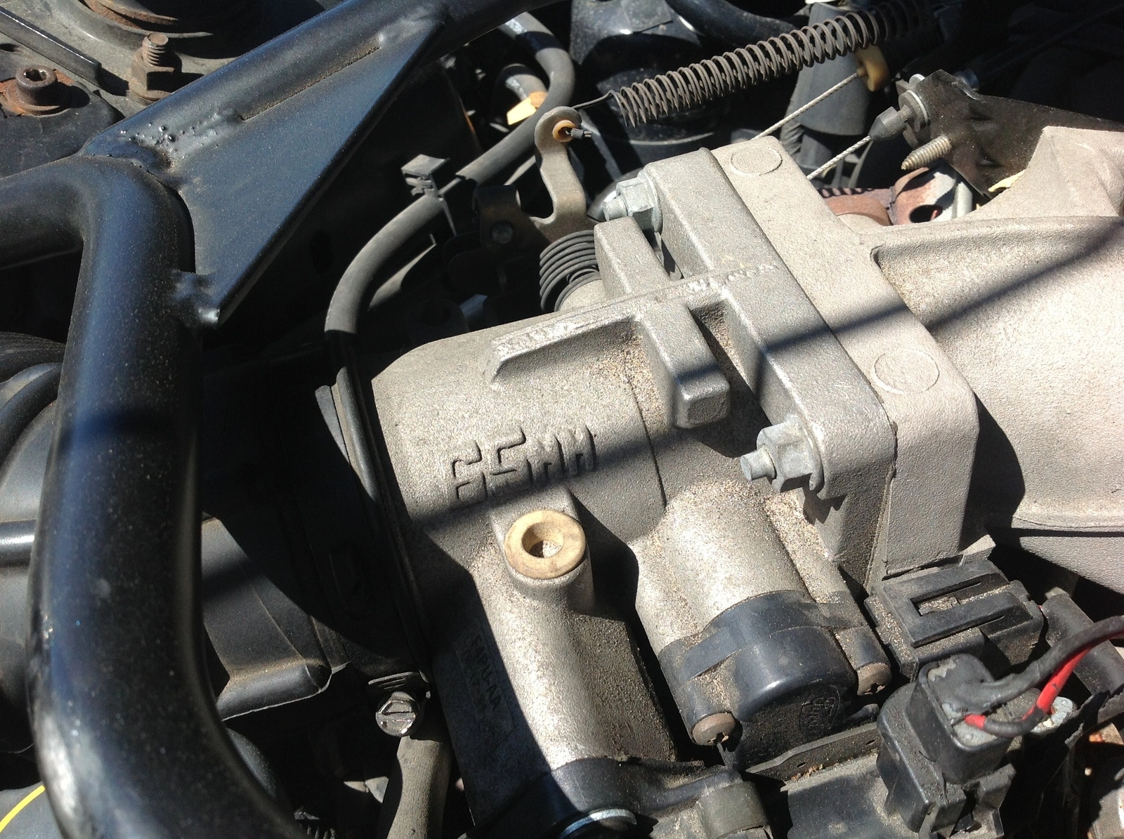

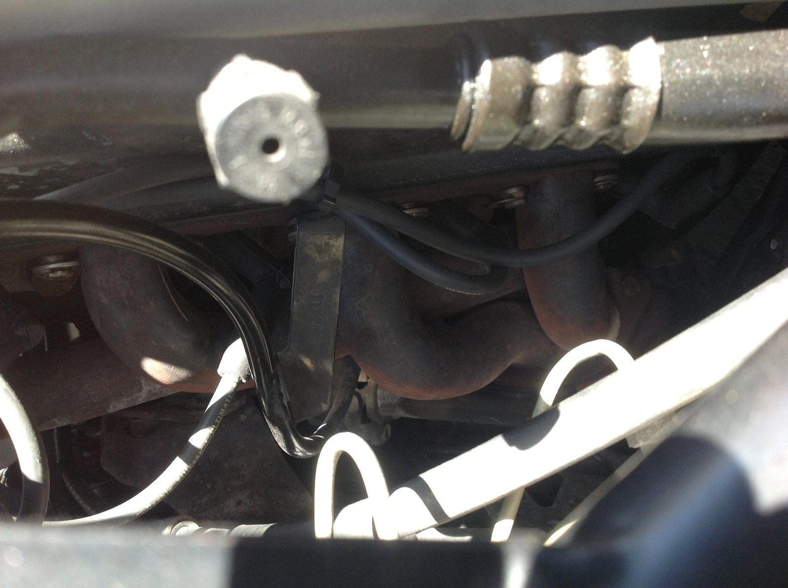

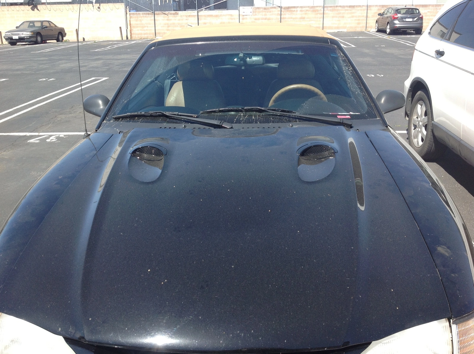

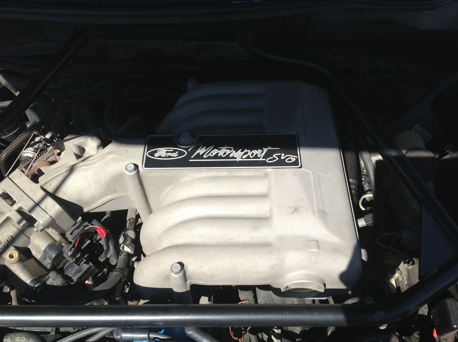

So, it has a 96 Cobra hood (totally dirty though), Ford shorty headers, SVO intake, Ford under drives, Ford 65mm TB, can't show the Y303 heads yet, nor can I show the ring/pinion. The 1st owner of the car lived on an island off of FL, you can tell from the sand. However, I have not observed any rust on the car aside from the bolts for the strut tower brace (which has been changed to allow room for the manifold).
