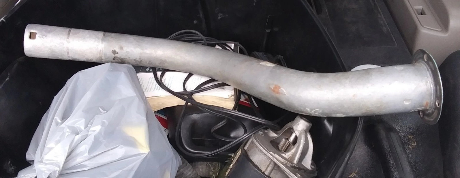

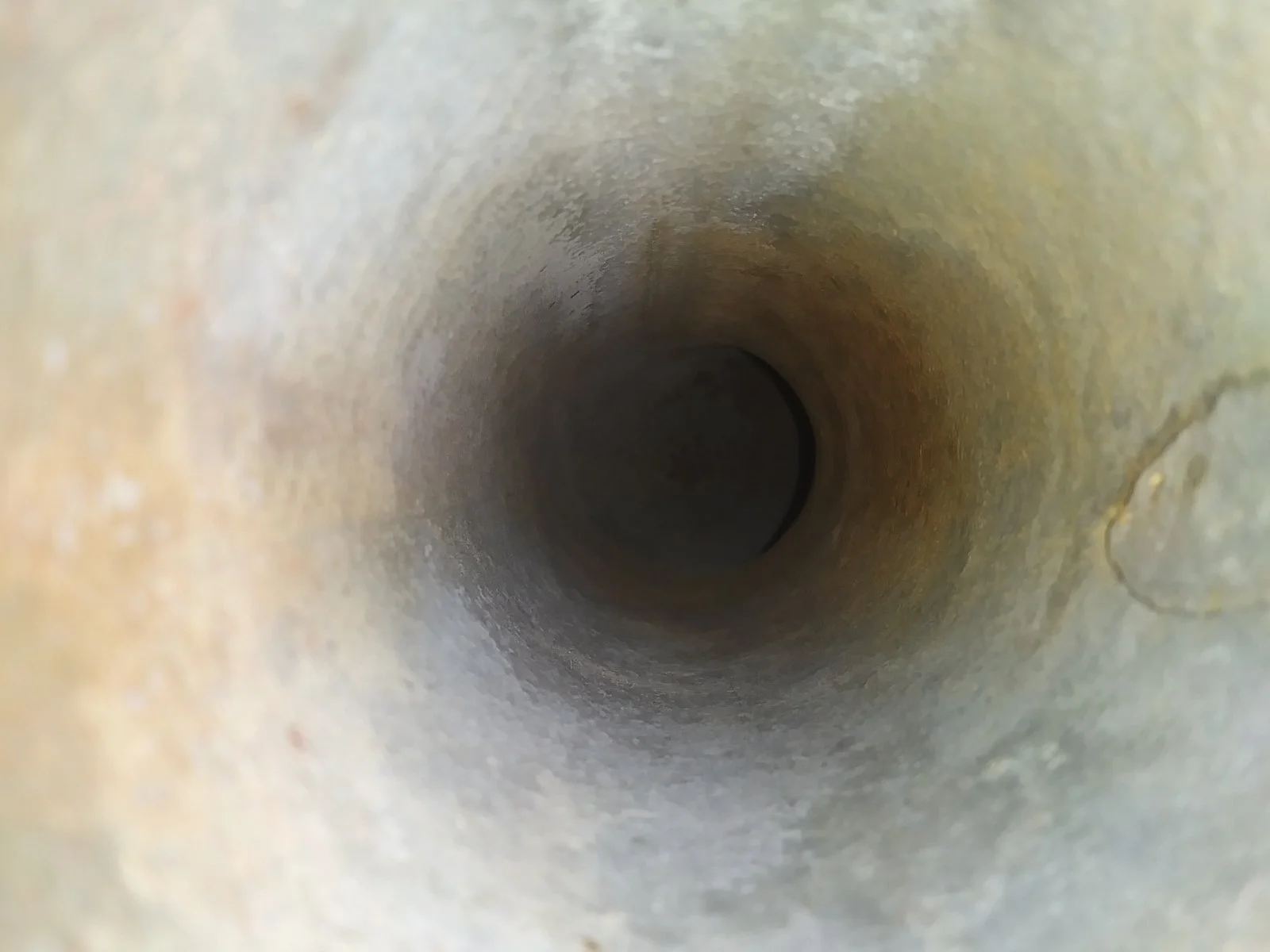

The fuel filler neck I ordered from Phil showed up with about an 1/8" thick layer of rusty crud built up inside when I got it about a year ago. I took it with me to the shop, and put it in the parts washer for an hour, which resulted in a noticeable improvement.
After that, I ran it through with one of these:
I chucked my new toy up in the drill and got to work. The clouds of rusty dust were impressive, and ALL of the loose stuff was successfully knocked loose.
I then capped the filler neck off with a nitrile glove and some zip ties (which leaked a little, by the way), and filled it with this:
Then I capped the other end the same way (which also leaked), and rotated which end of the fuel filler neck was up every 15-30 minutes for the next three hours. After emptying it, I was rewarded with a fuel filler neck that is ready to rock-and-roll!
