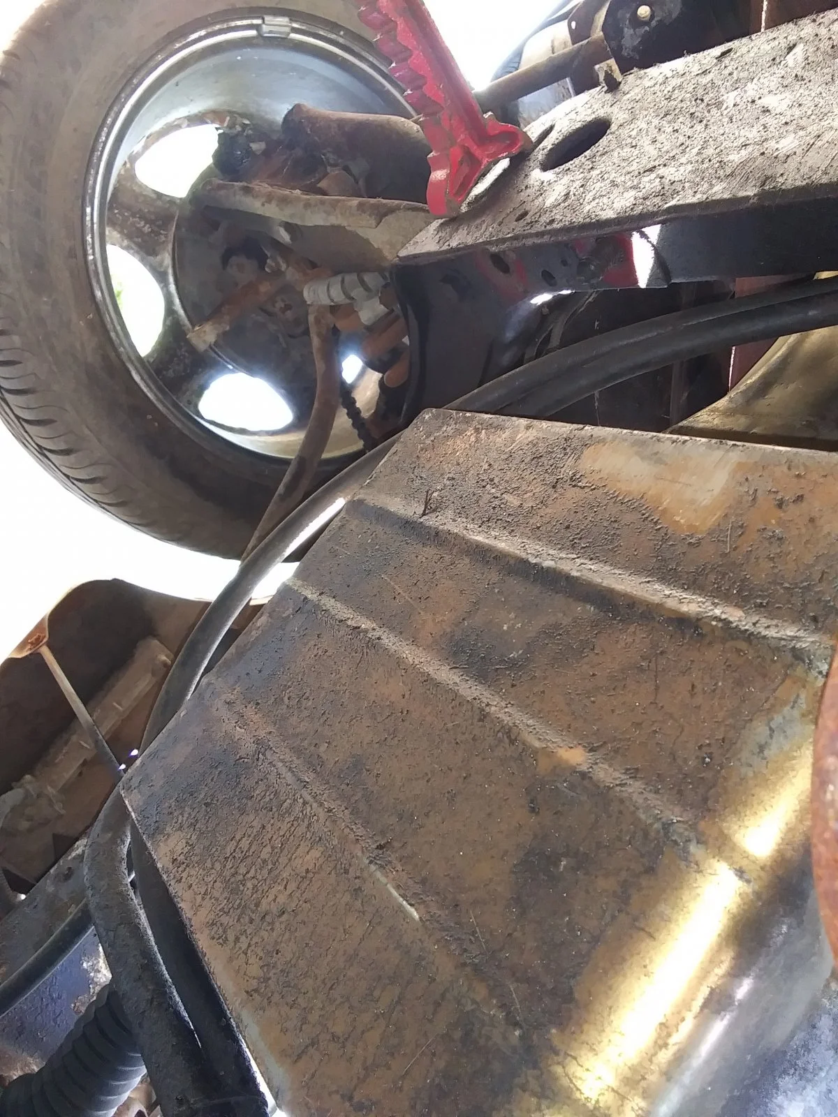

This is the hole on the right rear quarter panel I mentioned earlier. It kind of showed up out of nowhere.
Nice margins around it when I wire brush it. Cool, I suck at welding, and my welder isn't the best, nor is it the best for this, but I think I can handle a little 1"x2" patch.
Well, that complicates things, but I still got this, right?
What the? Oh . Well, let's see how much further it goes.
Jesus Tapdancing Christ! What the do I do about this???
@Davedacarpainter @2Blue2 @LILCBRA @rusty428cj @429MII @CarMichael Angelo any advice ya'll have would be appreciated. I'm going to stop there for the night after hitting it with a light coat of Rustoleum to keep the bare metal from flash rusting overnight.

You got to cut it all out and patch it up, if you don’t find every bit of it, it’ll come back.

I know that, but what do I do about that structural piece inside? (and the rusted weld)

got to bend up a flange or two on the piece your making

lol....sorry for laughing but I have "been there done that" so many times it is funny when you see it in pictures, and the sinking feeling as you cut more and more away. Pinholes on the outside are the worst because at first it doesn't look too bad until you realize a whole panel can be rusted through to almost just the paint thickness and all one might see is a tiny pin hole in one spot.
You have gone down the rust rabbit hole my friend, and sometimes you don't know where it will end. Short story is you will have to cut out that part on the side too so you will end up making a 90 degree patch panel (or two flats welded into a 90) to fix it. also you will have to remove (even temporarily) a piece big enough to get to what ever repairs are behind it (structural support). I will fix that rust for you if you build my headers though..

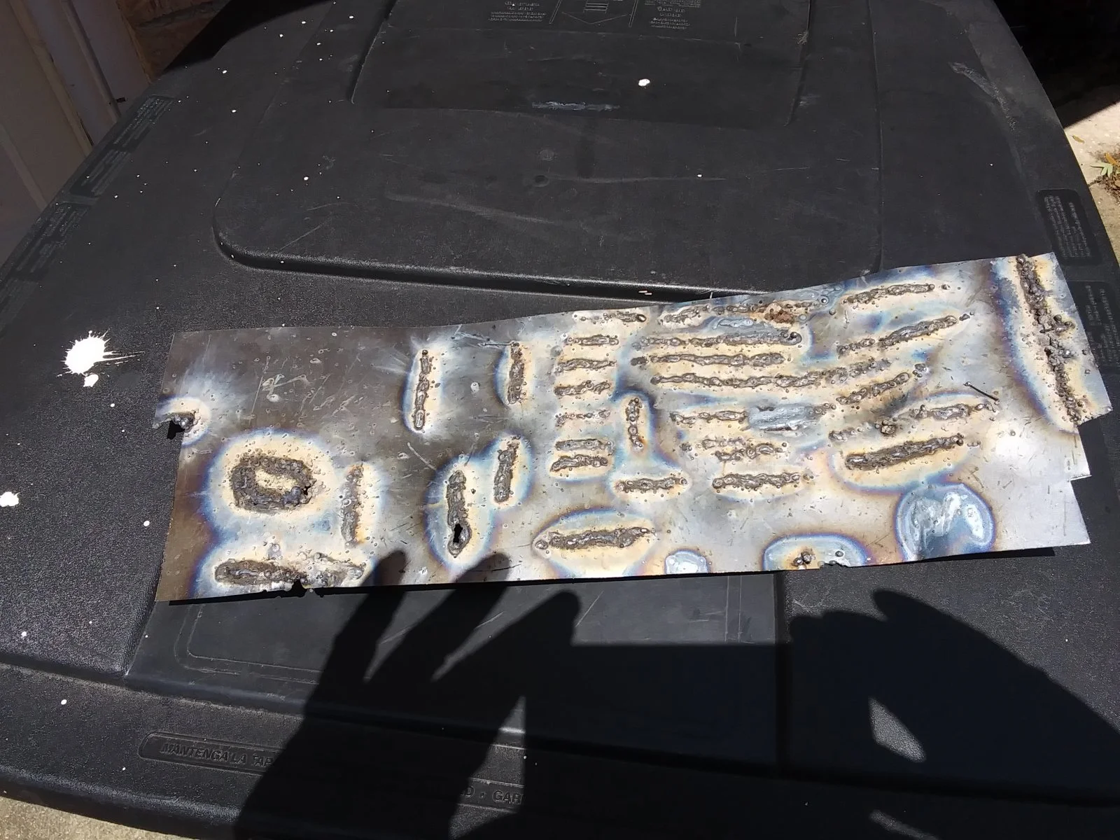

Me and the welder had a disagreement. The welder won. I've shot the bare metal in spray paint again pending a discussion with a co-worker and/or a discussion with a friend of mine that does body work tomorrow.
In the meantime, I thing I'm going to try and sell my practice piece as abstract art with some pretentious meaning to idiots with more money than sense.

Ah yes... I recognize that piece. "Metallic excrement in sheet metal" by 74stang circa 2020. Very fine indeed. hang it in the library.

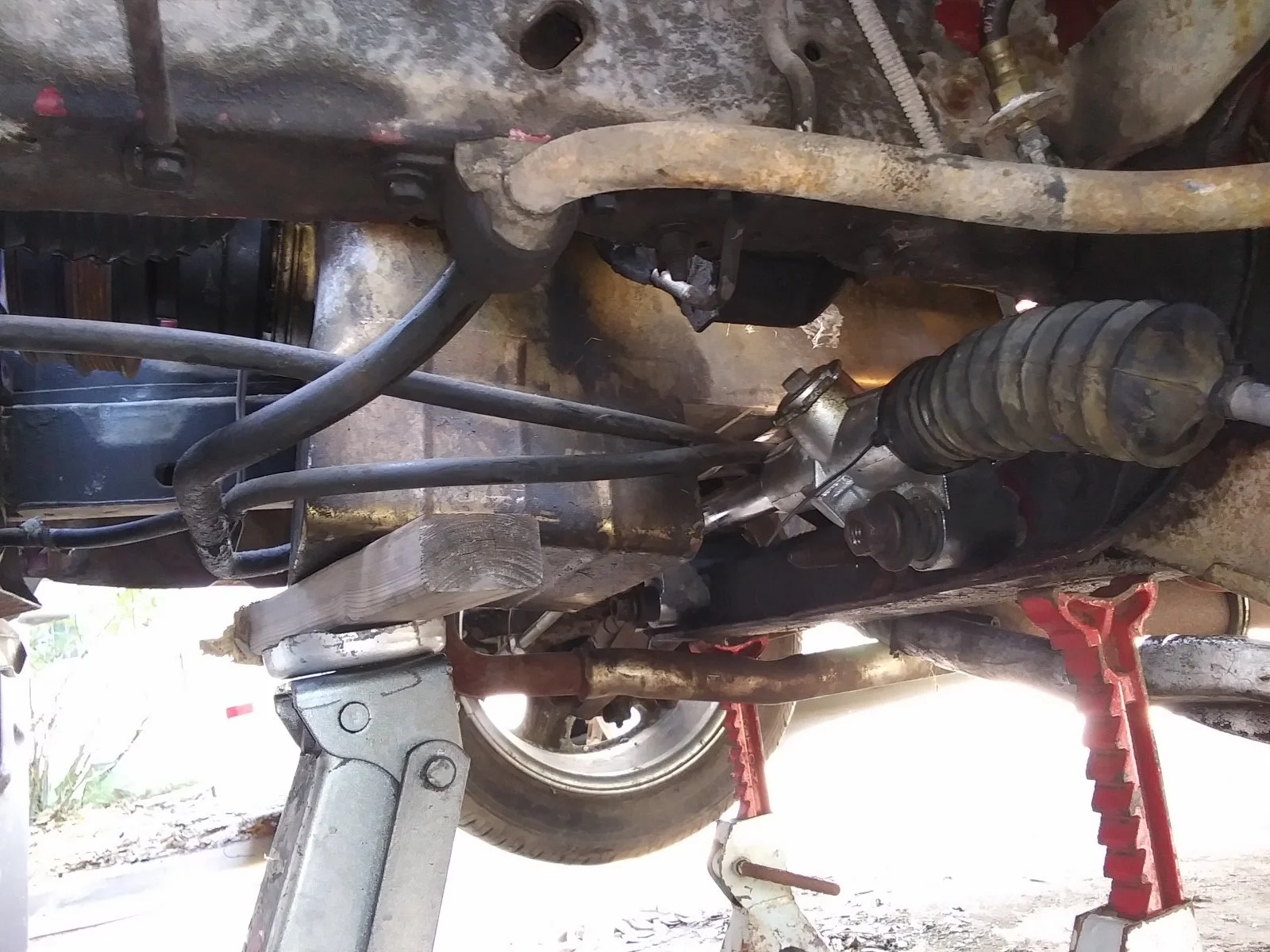

New rack is in... STILL can't get that gorram steering shaft out. Hell, I even have the spot I need to cut it at scribed!
I'm thinking about taking the driver's side header out for room to work. I'm not 100% sure that'll be effective though.
